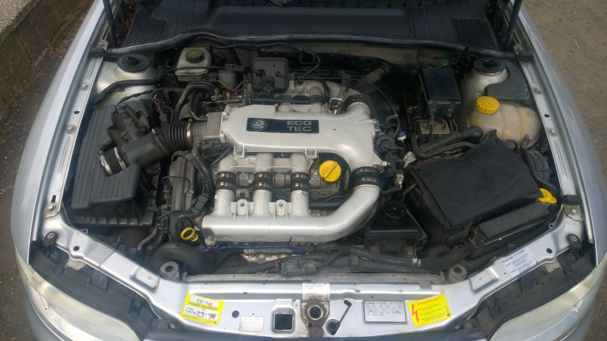

Hello John, not heard from you in ages. Do you still have your veccy ?
Yes I still have it. It’s been under a cover for the last 5 years, occasionally popping out for a clean.
Oddity enough it’s sat out on the driveway now. I’ve had a friend over to quote me for some bodywork rectification. The front and rear bumpers need repainting along with the boot spoiler. There’s also the matter of Christine’s minor indiscretion along my NS doors.
The brakes are seized too but I’m looking to get it back on the road in the near future.
