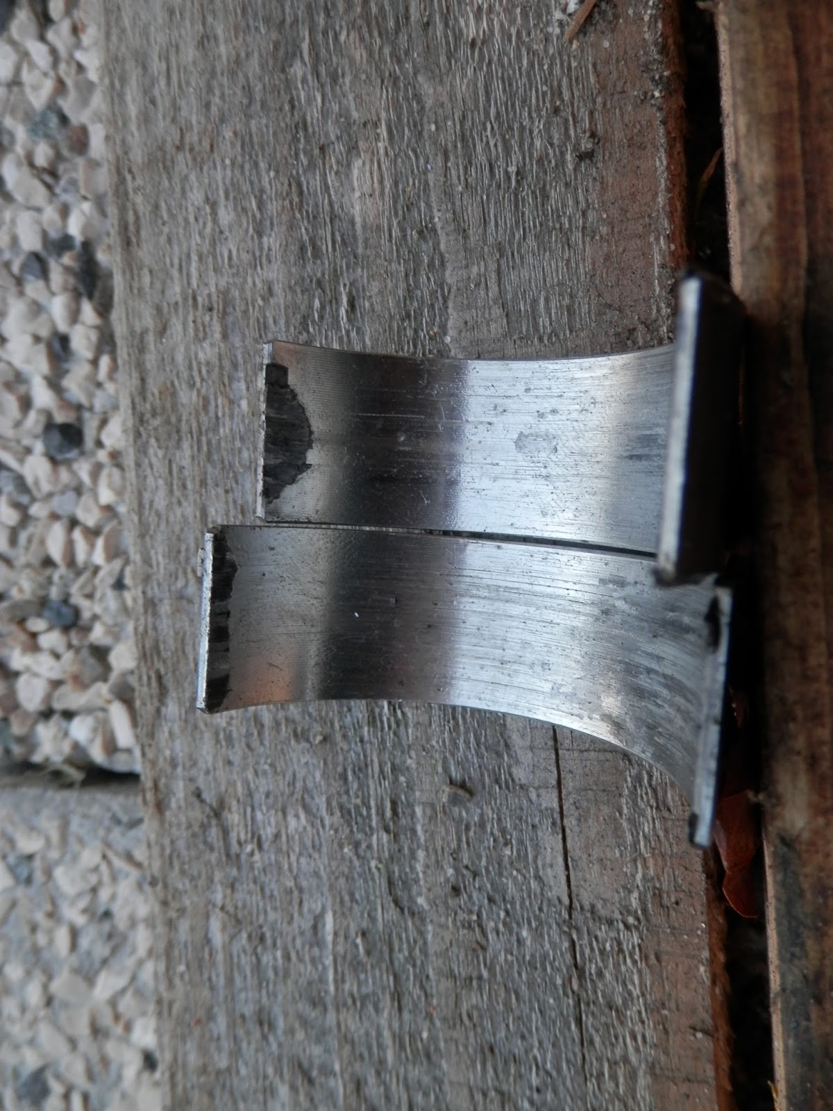

A second conrods bearing is damaged:
Do i need a new crankshaft ?

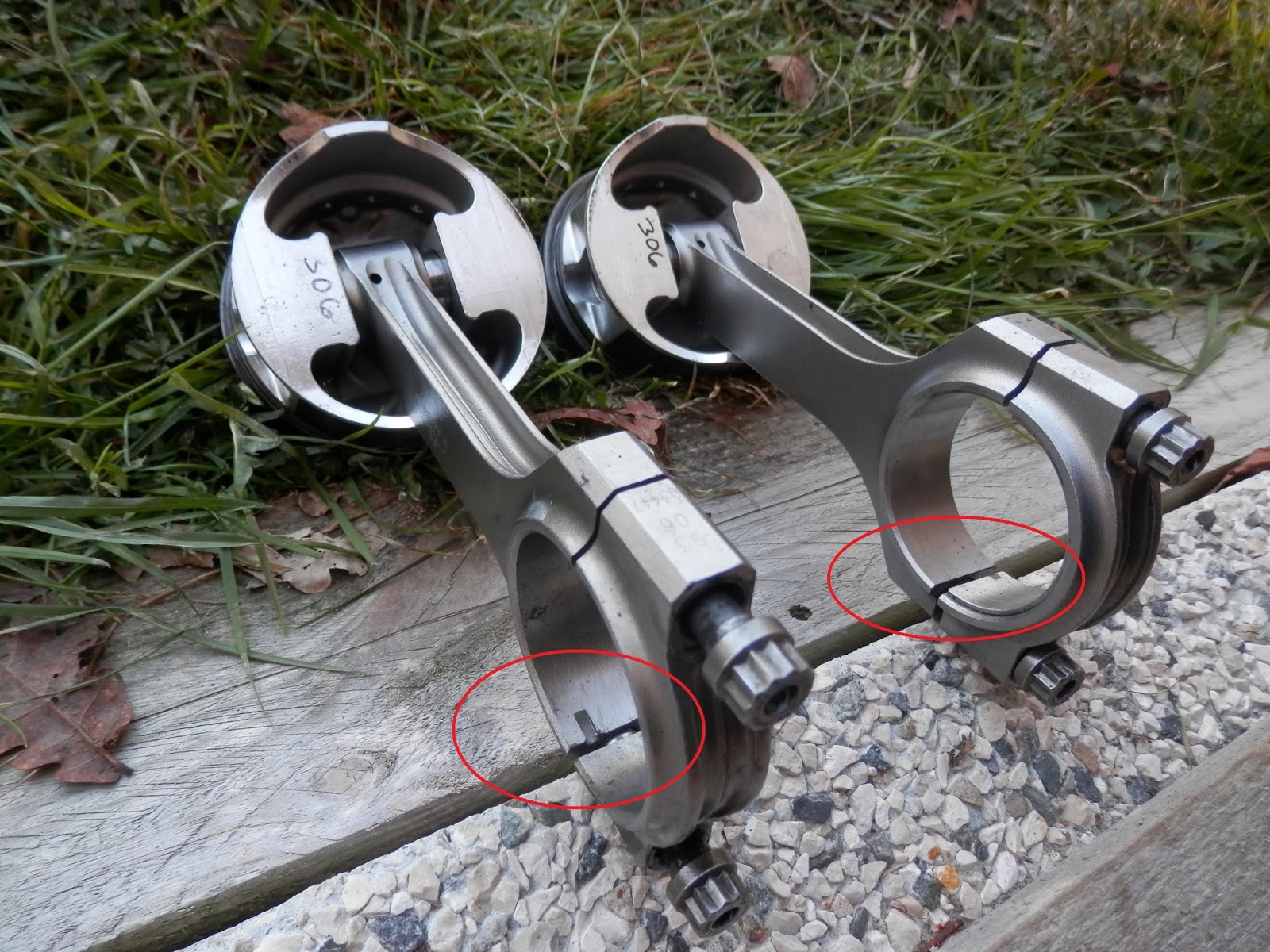

I found that 2 conrods were not installed in same way, is this bad ?
If you read back my project: when engine were rebuilt, when i tighten conrods screw : i couldn't turn it free without a particular strong force on the crankshaft. When i loosed conrods screws : it turn correctly.
What do you think about wrong bearings conrods size ?
I've used ZZP ECOTEC 2.0L/2.4L ROD BEARINGS
https://zzperformance.com/ecotec/engine/ecotec-2-0l-2-4l-rod-bearings.html
Or too much torque on screws ?
Or oil pump fault, how to check the oil pump ?
