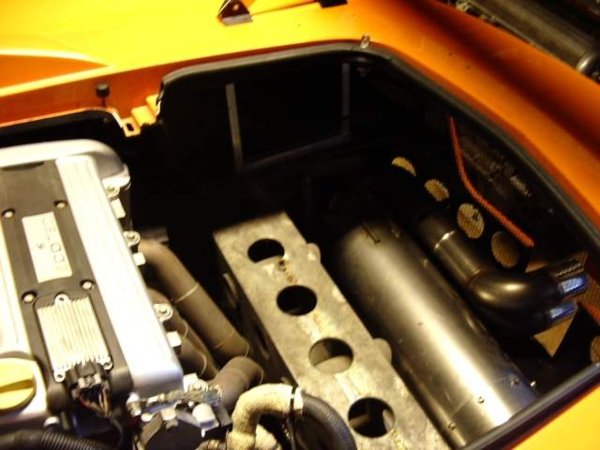

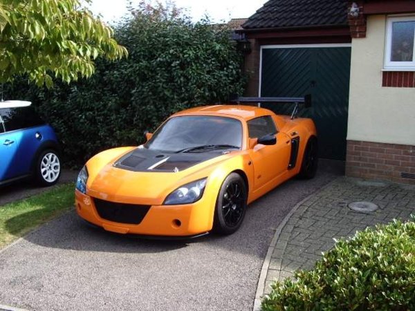

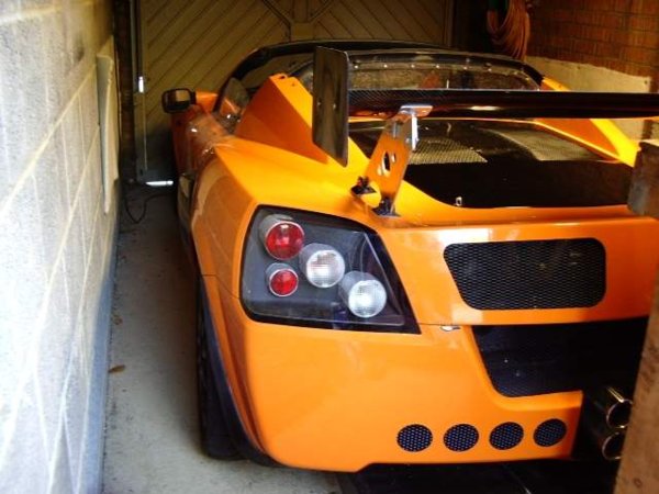

a few pics of the latest mods :D

the last pic.... cryb..
that bearing has the end float shim bearings attached (y)

Just a quickie about the rear clam fixings...
How is the clam attatched with the boot floor removed? Is it OK with just the remaining bolts or do you have to add extra mounting points?
Top job there by the way!
the crank moves (well tries to move) back and forth, the end float bearings control the movement (y)
rear clam
the rear clam has an alloy frame each side to support the rear wing.
this is riveted to the clam floor, bolted to the subframe and also bolted to the outer clam, it's actually stronger than the standard clam (y)
