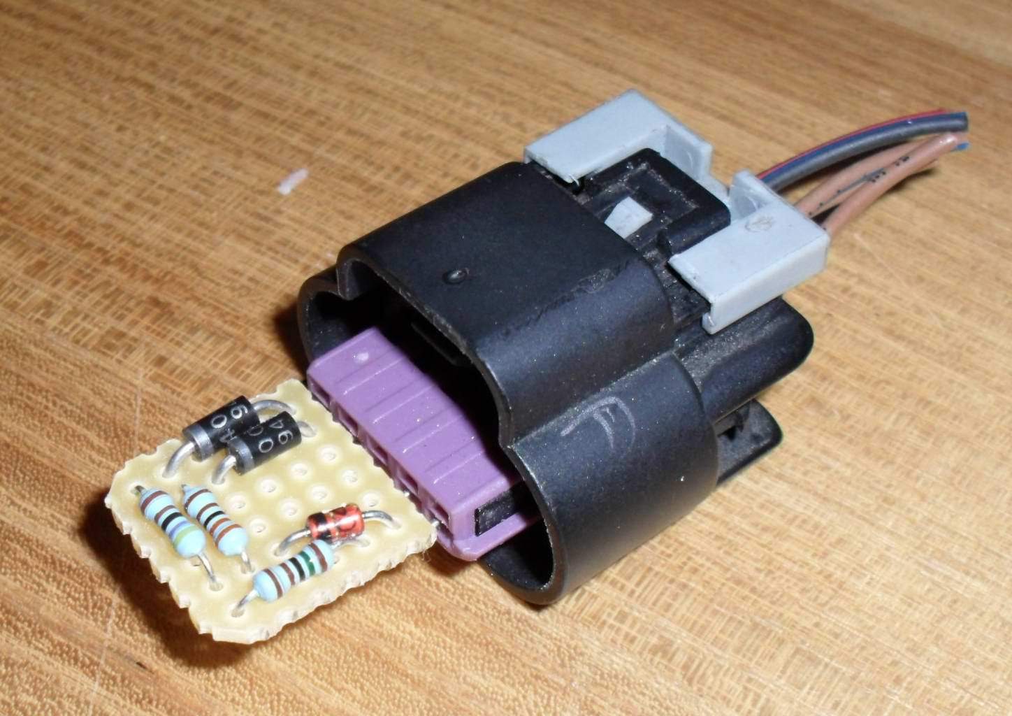

due to the popularity of the 'plug-in' version of the egr cheater it will now be the default supplied version, if you want a wired version then please ask
this is the correct way up for the egr plug-in cheater, the components upwards and the centre pin C is not used, so two pins go to A + B and the other two pins go to D + E
EDIT: I have updated the picture with the 2010 version

karl hodder
hi matt, the egr cheater i received is the same as above but has a little glass diode instead of a resistor there is this normal?, when i received it in the post the little diode was damaged with broken glass in the envelope, is there any chance you could send me another i could solder in?
