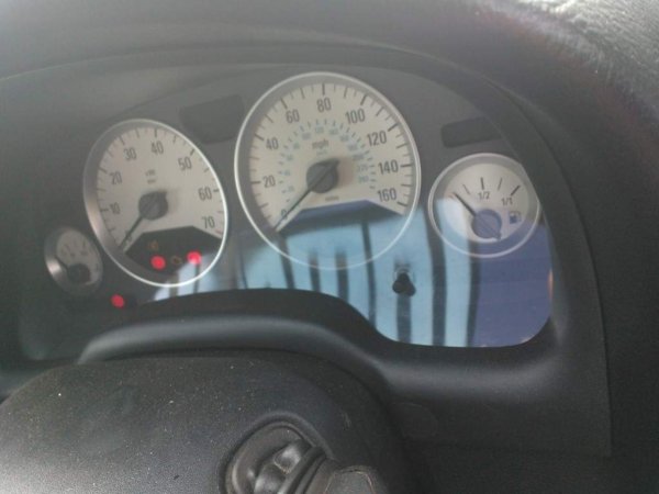

the old hub is back on the car no lights on at all now :confused:

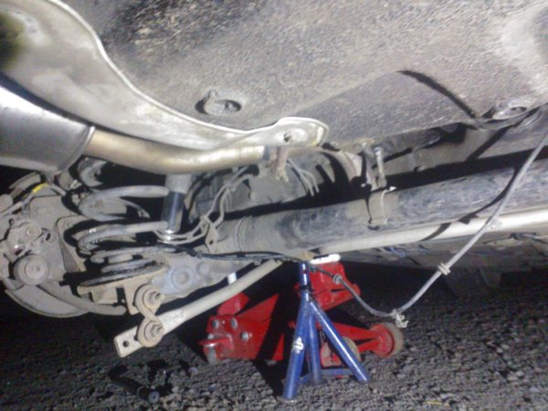

some pics from last night at like midnight refitting the old hub

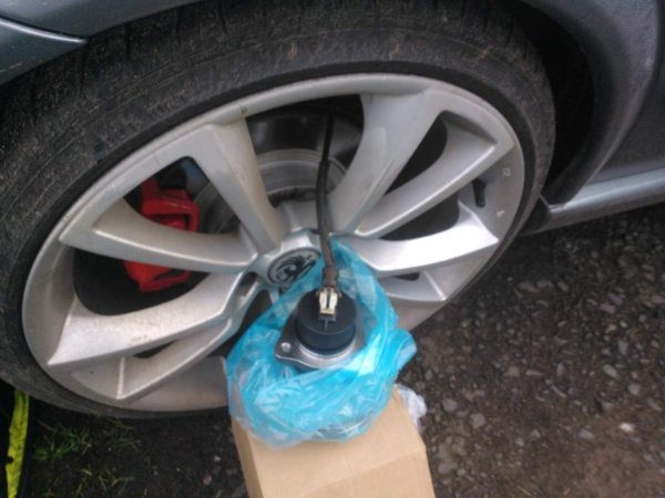

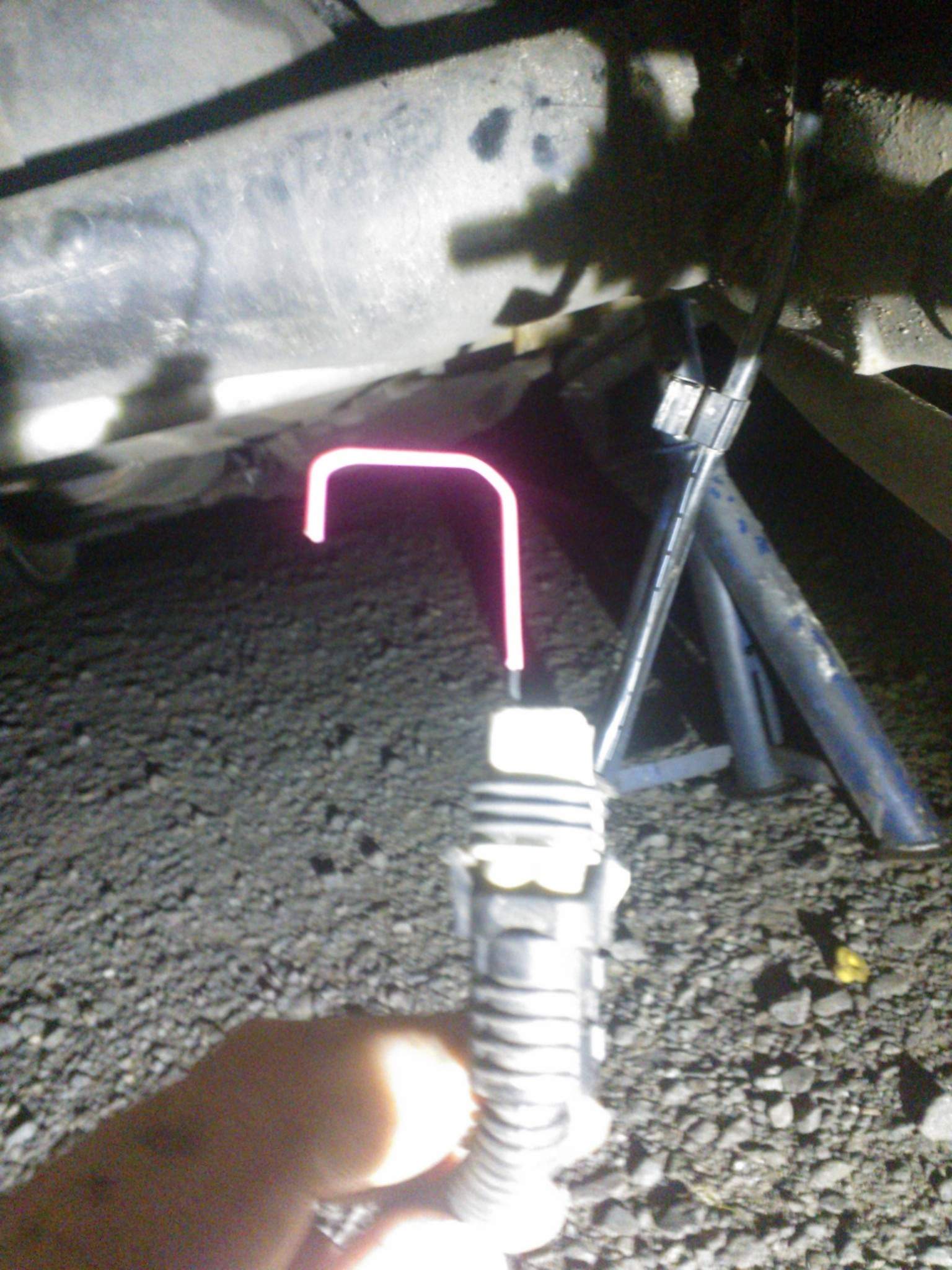

tried to make a connection with the new hub with a bit of paper clip in the plug it still would not find the hub
the test i plugged the drivers side plug in to the passenger side hub then plugged the old hub in the passenger side loom the lights went out lol
on the way to the dentist today i had no problems the lights were all off and stayed off but the bearing in the driver side is real noisy

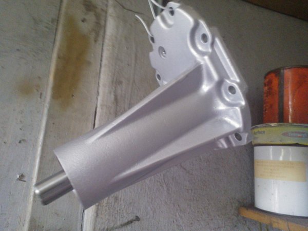

spare supercharger snout rebuilt and painted with engine enamel silver

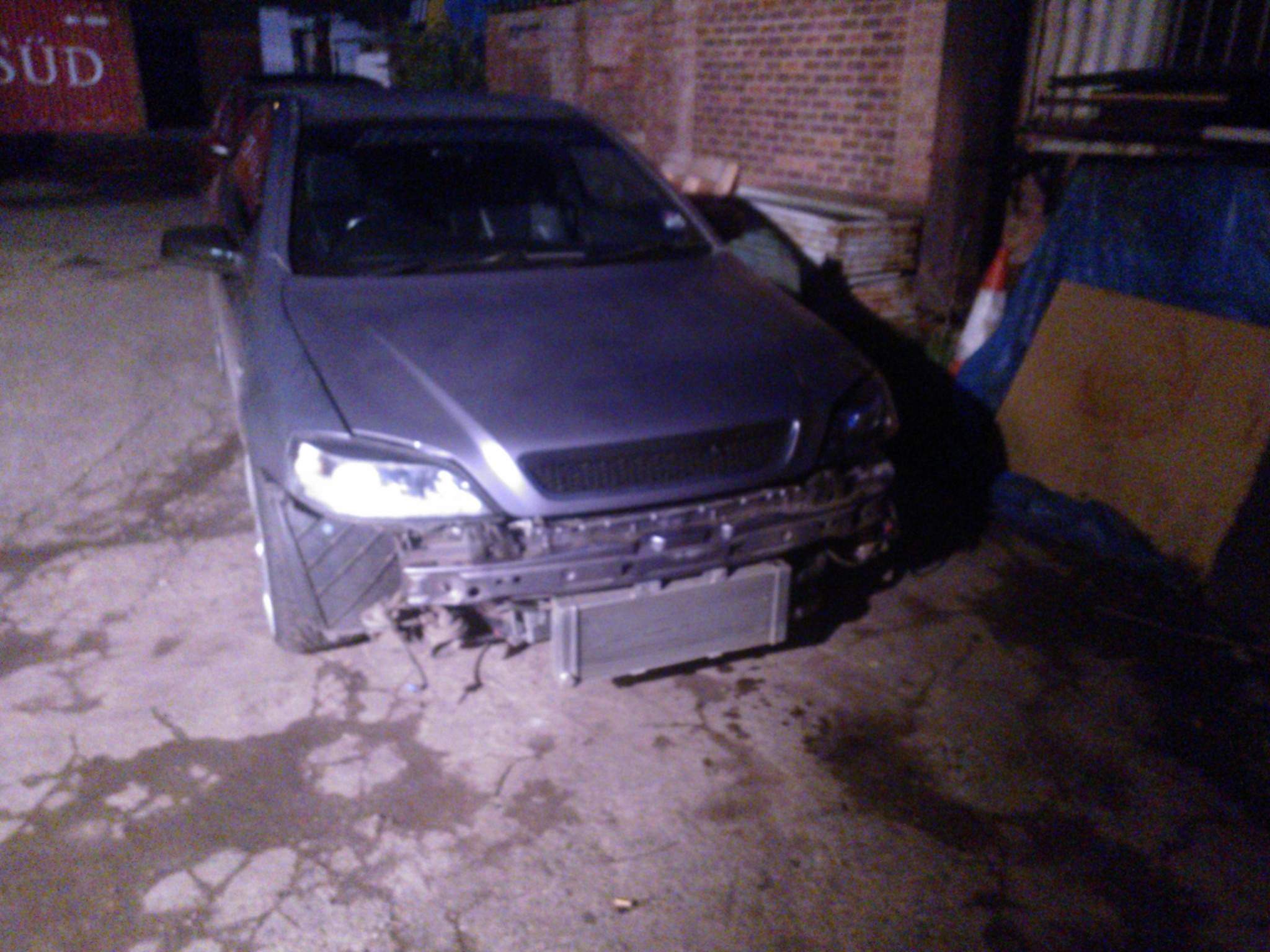

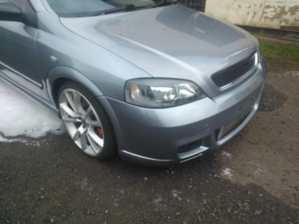

finally got time to do the front bumper again

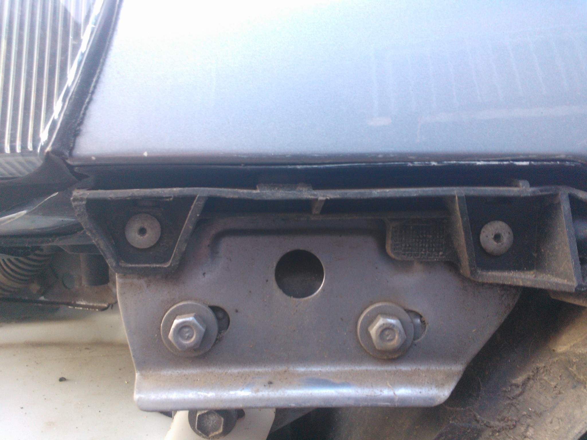

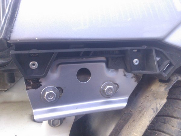

changed the bumper rails (old)
new

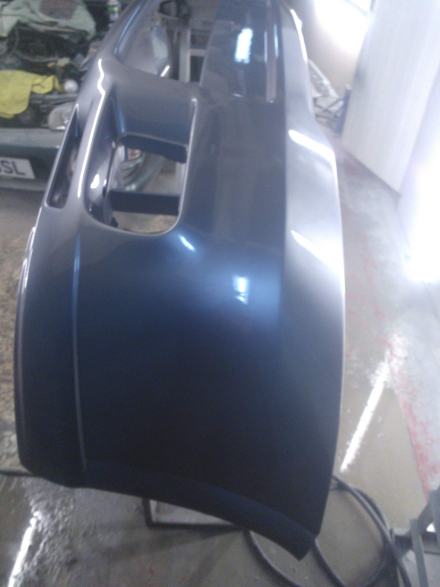

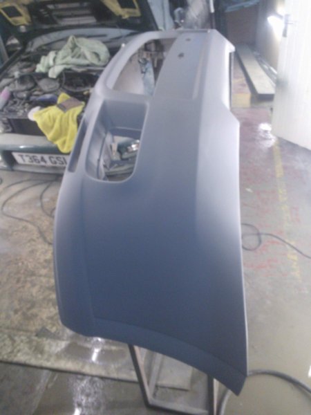

prepped and sanded with 2k high build primer

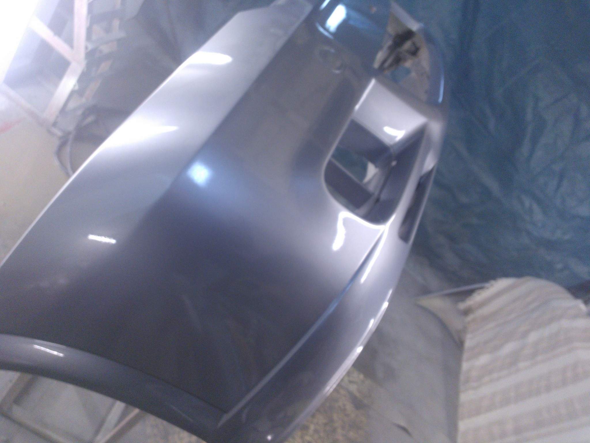

color and lacquer on with my devilbiss hd advanced spray gun
the fine finish from the gun was great

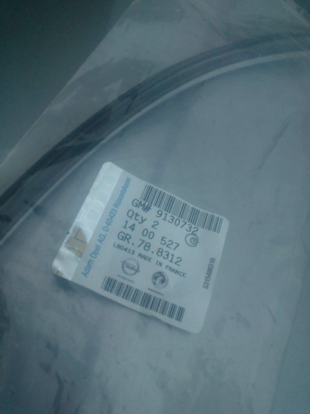

new weather strips for under the head lamps

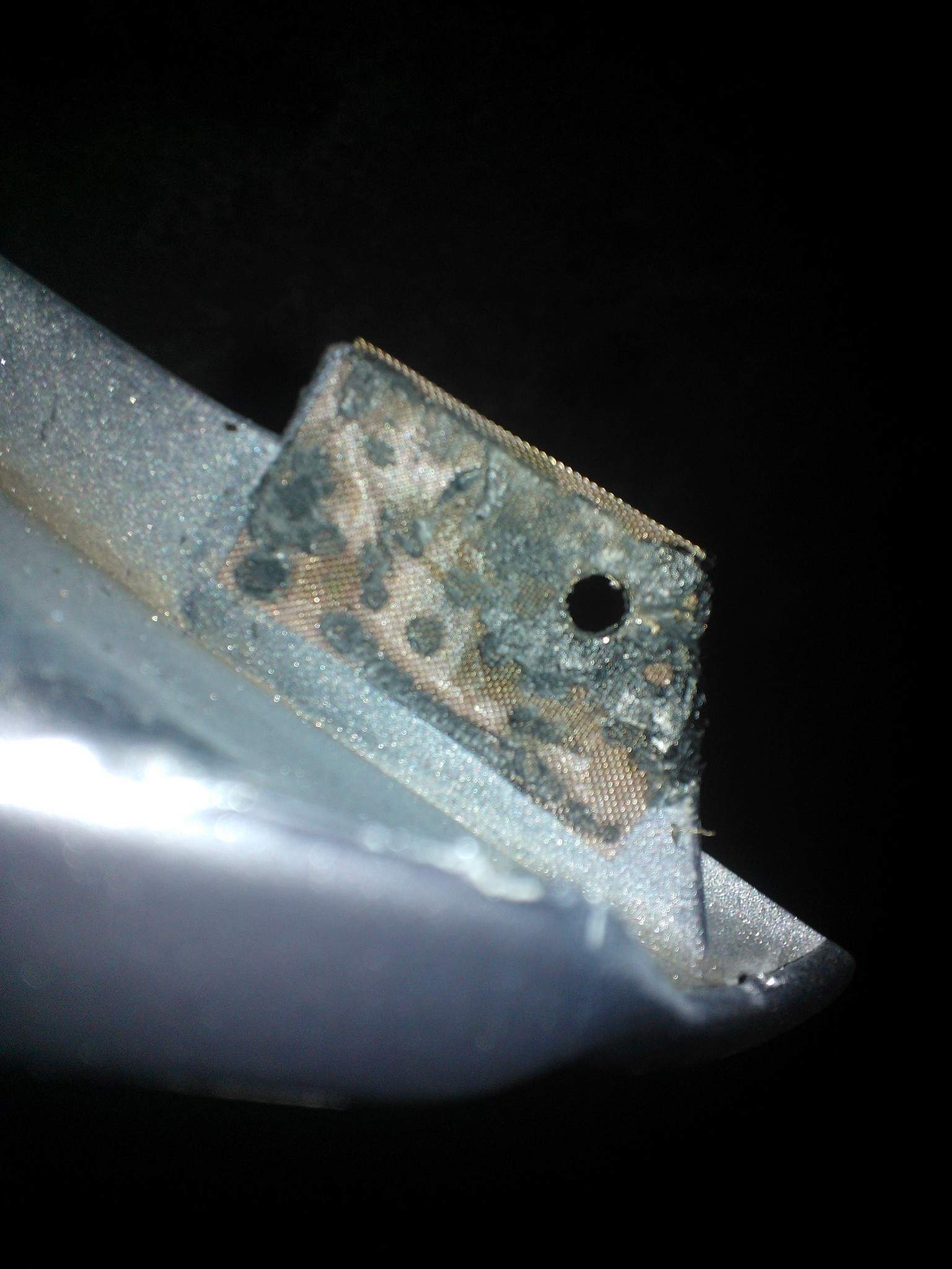

broken lug fixed with stainless steel mesh and a soldering iron then drilled the hole for the bolt :)

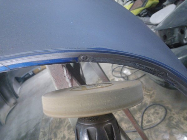

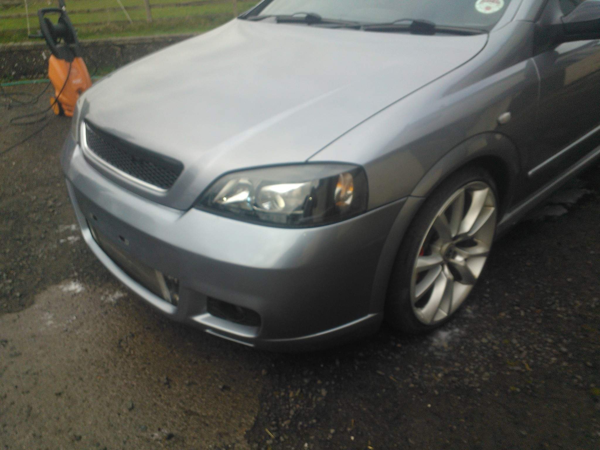

wing is bent in at the corner by the headlight will have to removed the head light to fix it

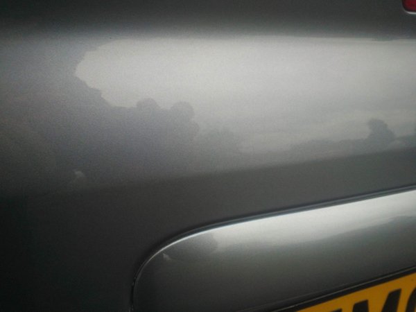

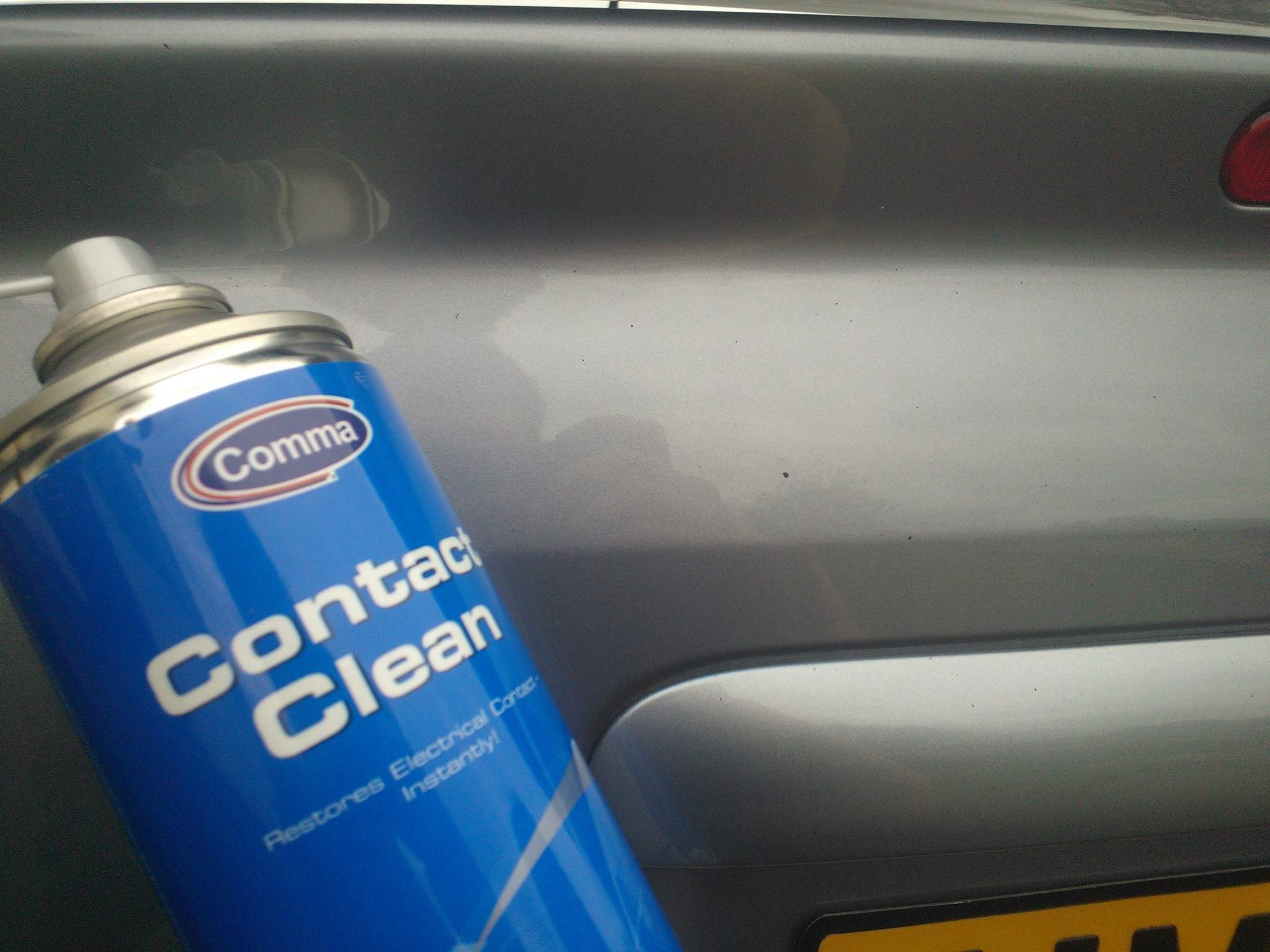

not quite sure how the tar got all over the boot lid but this comma contact cleaner on a microfiber works a treat
went thru the normal steps after using the contact cleaner and clayed the lid then g3 ,megs ultimate polish and ultimate wax
