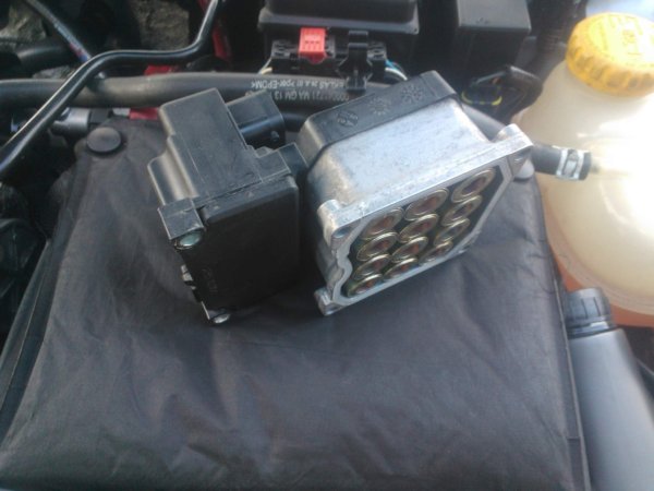

abs ecu £10
did it fix the issue did it F***!

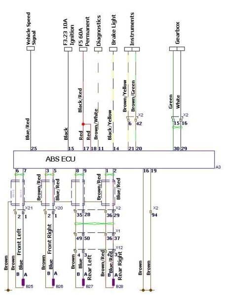

So trace wires time?
yeah not a fun part thats for sure only have to check the loom inside the car there rest has been done :confused:
can get a dash loom for next to nothing in the morning
Did you get a full refund plus any p&p? As above what's the next step to source the issue?
he said he was going to give me a full refund and to keep the box as its fubard
i know where theres a full sri-t loom and steering column so might be going with that not sure yet

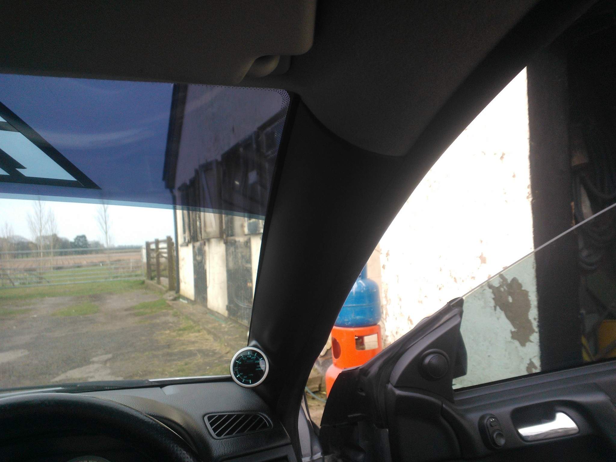

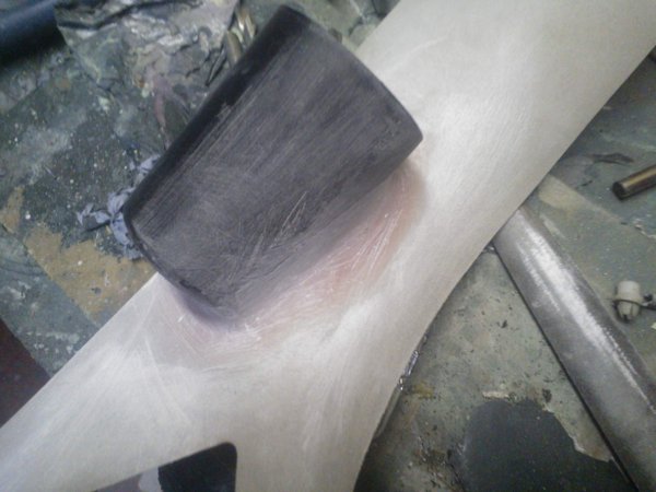

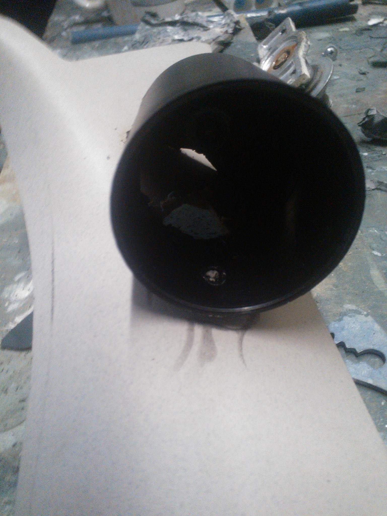

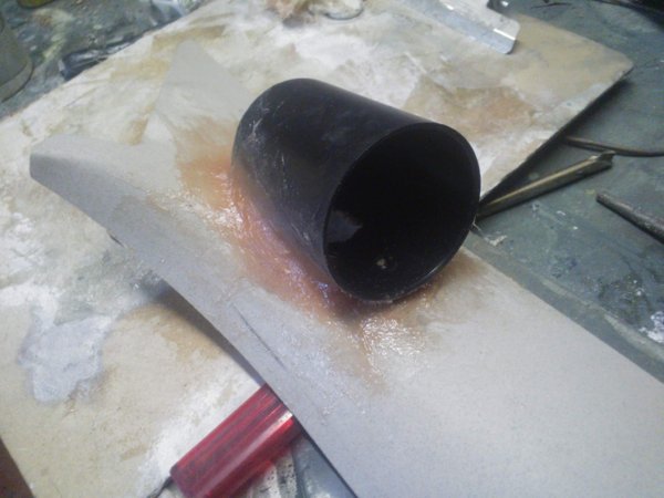

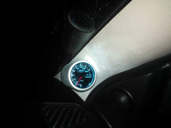

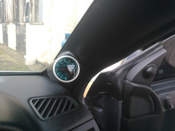

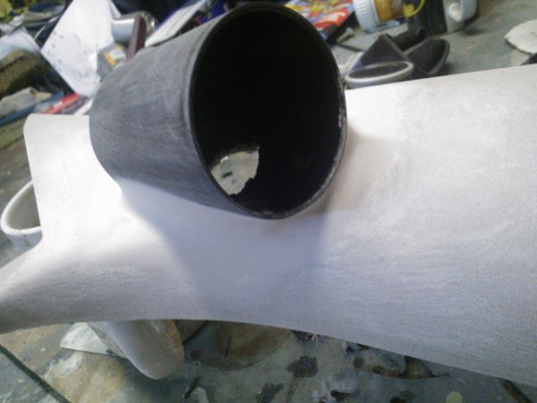

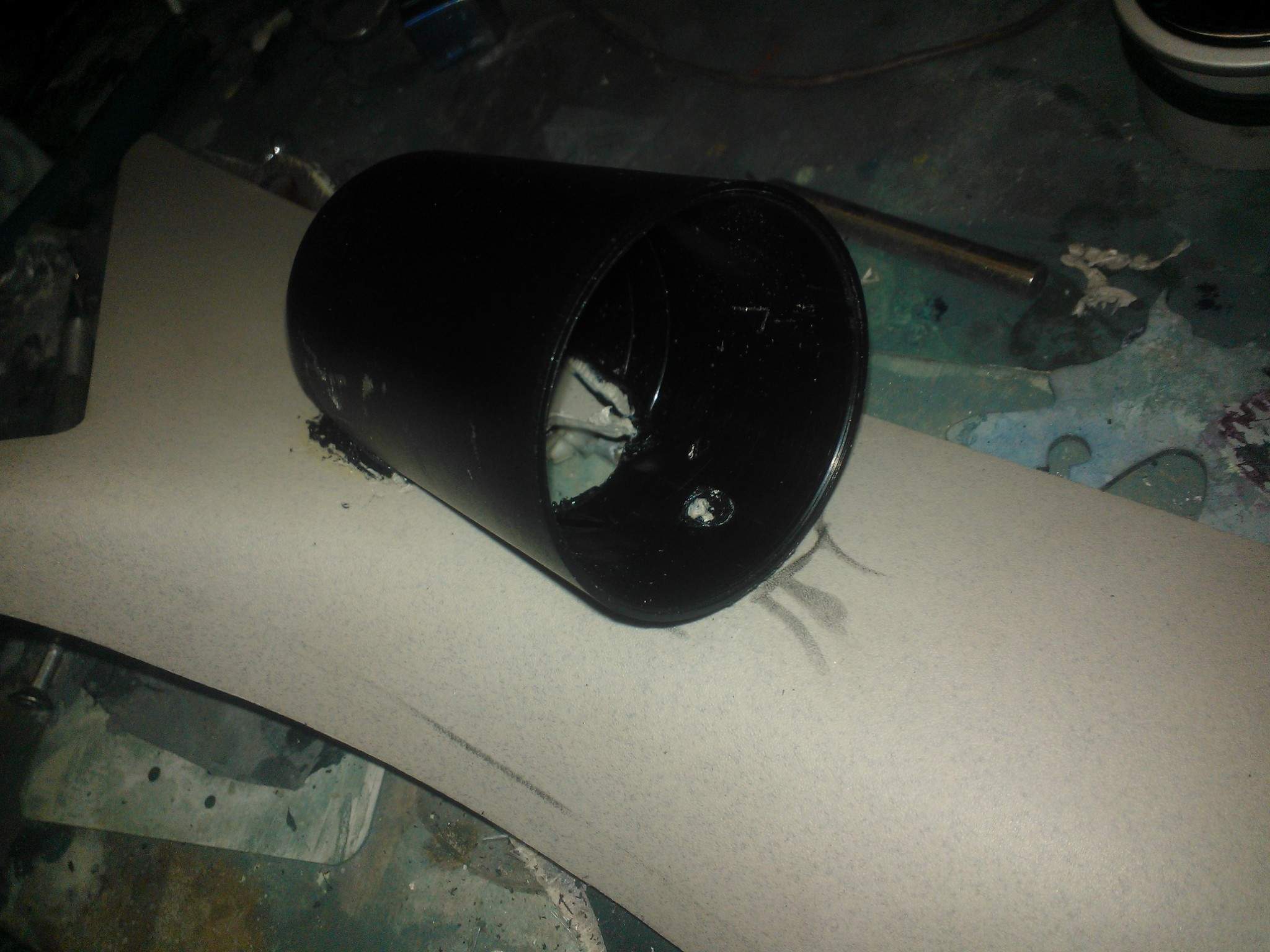

diy gauge pod
cut the halfords pod up and plastic welded it to the trim
fiberglass filler for support
shapped
body filler for a smooth blend
and fitted :) next step matt black paint

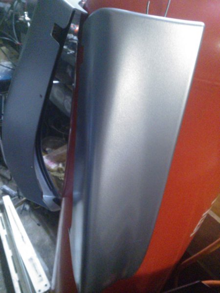

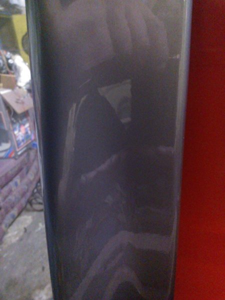

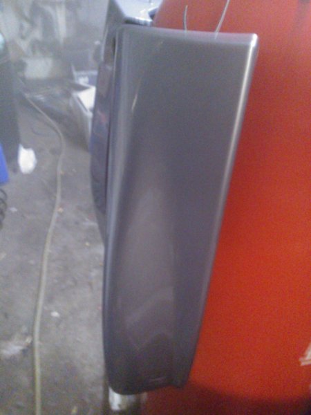

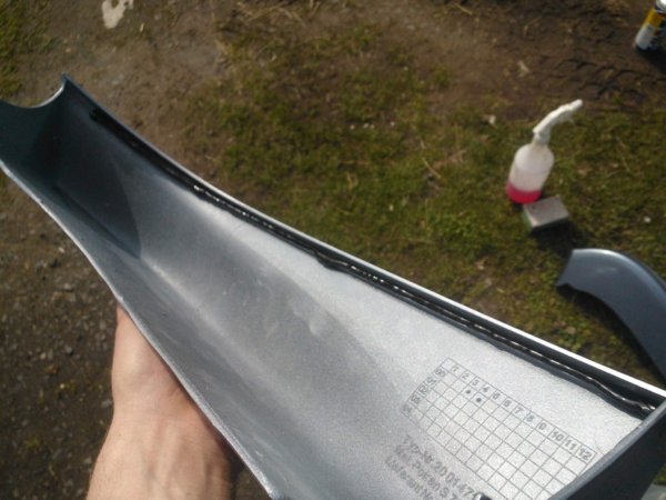

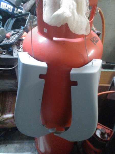

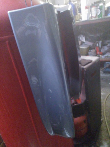

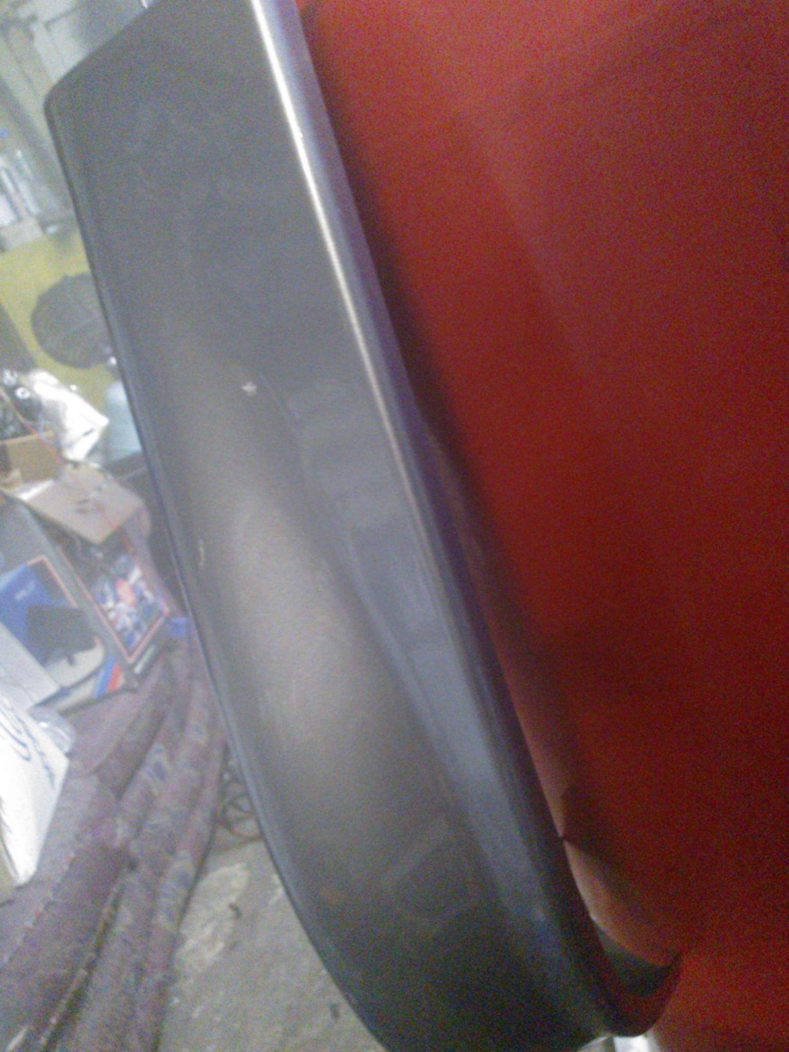

dug out the rear spats and prepped them for paint
just waiting for them to dry then will flat them and color code them

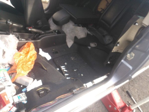

while i was messing i took all the crap off the back seat lifted it and wiggled the loom to the outside turned the ignition on and the lamps for the abs and tc went out then come back one after 5 seconds so looks like my fault is there
between the x1 and x12 plug

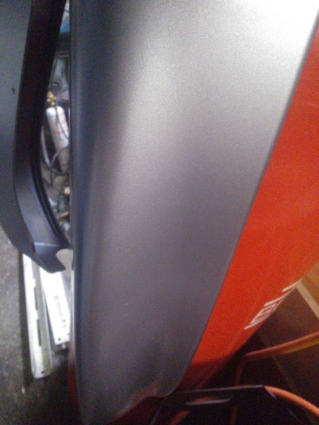

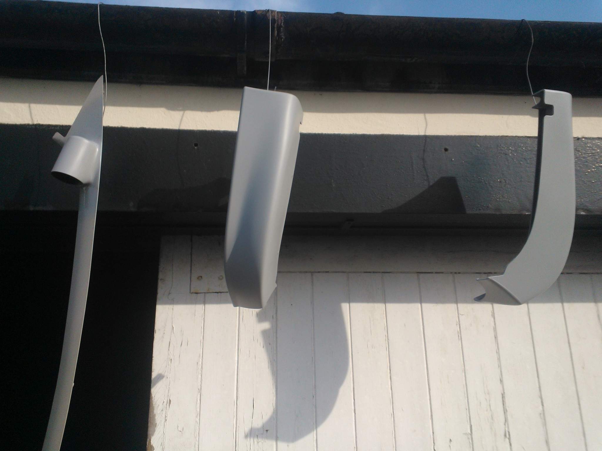

spats are done

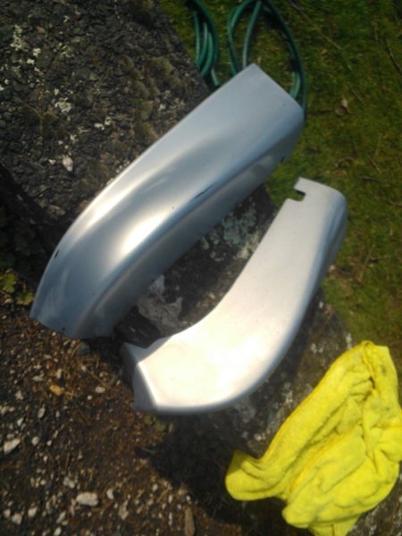

sanded,degreased,tack raged
1st coat
2nd coat
lacquer 1st coat

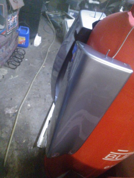

lacquer 2nd coat

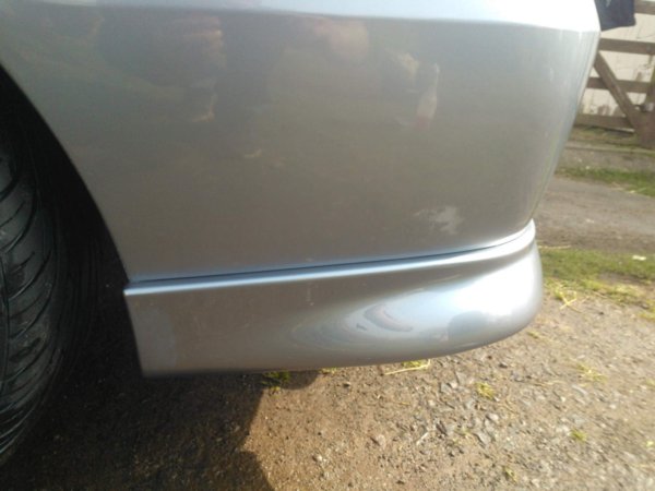

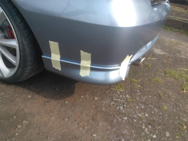

will fit them tomorrow if its nice :)

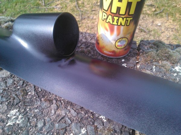

the pod got primed and sanded to but will have to go and get some texture paint to make it look right
IDI AMIN
Spats look nice and shiny(y)
Textured paint is applied the same way as ordinary paint it is just the nozzle might be different to give that textured efffect
no broken connections to the front of the car
p**s take is i just plugged the old hub in and the lamps went out!! as soon as i plug the new hub in the lights come on WTF
yeah thats an idea but then what was the point of buying the new hub lol the thing i want to know is why the old one now works and the new one don't (seams it never has) :)
going to remove the loom from the passenger side and plug it into the new one then try the other one in the passenger side hub if it works that was i will put the new one on the other side
