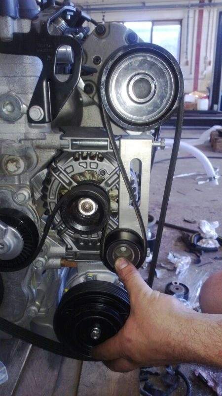

Almost there... 1540 might be ok, 1546 for sure is too long and makes it scream like a pig :)
but then i used 25mm spacers on the a/c pump so may even be shorter than 1540 the next size down the shop stocks is 1515 so will have to order it in :)

Carl, you could also consider this setup pulley wise. More belt for the alternator. Requires a smaller pulley though
i had considered this the 1st time round i have many different drawings on a bit of paper me and dad sat down and looked at the options dad's an engineer but aint got the foggiest idea what im doing lol
the thing to do now would me put a step in the cs bracket to move the pulley closer to the block
the new pulley and 2bar map sensor came with the remapped ecu about 30mins ago :)
i will now go get a belt 1540 long just to see if it fits then continue with the loom extensions

So can you basically pick which belt set up you want to use then?
Up until a certain point yes. There is the original cobalt ss setup and the setup without a/c (eg vx220), and with a/c (like carl's and mine) which uses the bracket from cms. Different pulley sizes then allow for different setups with different lengths of belts. They all seem to work fine...

think my belt is 1585 ,also using the idle pulley from cms with no aircon
like z22se fan said you can use 4-5 different ways depending on the stuff your running belts come in all different lengths so just get the one close :)
you dont need the idler pully :) you could've sold it me! hehe it wont be 1585
my run is 1440 with string and thats with a/c

and a belt thats close 5pk 1453 ive got 2 5pk 1440 coming tomorrow

haha your right its a 1285 ,what threw me was that I remember seeing a 5 on the packet ,that 5 is 5 pk lol
