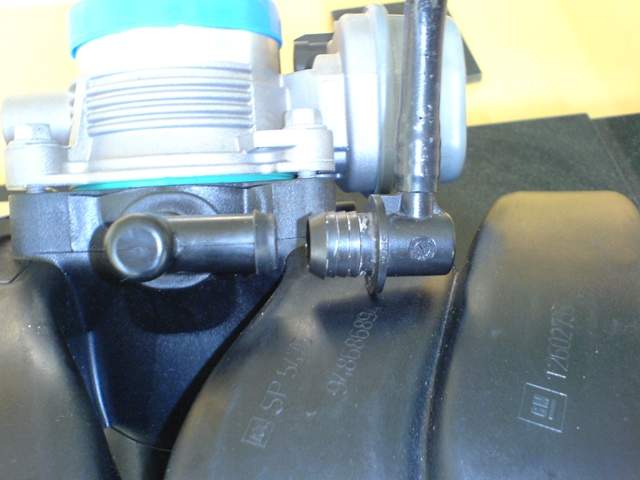

Just to through a spanner in the works, The 12.5mm plastic pipe wont fit over the nipple on the intake manifold, its more like 15mm on mine. I am going to use a 1" long pice of 15mm ID rubber pipe between the manifold nipple and the plastic plug that conects the vac hose to your brake servo cylinder. The servo cylinder plug converts the vac pipe down from 15mm to 12.5 or 8mm depending what was fitted to the car you pull it out off. I took a couple of these from the scrappie when I went hunting valves down on the off chance they would come in usefull and they do! Ill get pics up later. I also have a couple of spare one way valves including one with 2 extra spurs for those with a vecy if anyones stuck.

Sorry chaps, I was wrong :oops: The 2.4l manifold nipple is 13.5mm OD not 15mm, the rib on it measures 15mm though and its bloody hard work pushing the rigid plastic pipe over it, if not impossible, I boiled the pipe for 5mins and still couldnt get it over. I'll post up what I'm using in a minute.
I dont know about cutting the original npple off, it could work perhaps? dunno.. But I've always kept my original bits so I can put the car back to standard for any reason and dont really want to try it. Ill have a look for you tomorrow though. Thats the big day it all gets fitted! :D I was going to do it earlyer, but the car wasnt running right since I changed the hydrolic lifters and wanted to get that sorted first. I stripped it down again today and found I'd set the timing chain a tooth out :eek: That explained the lumpy idle and why it went like a rocket at high revs, Id advanced the timing! lol.

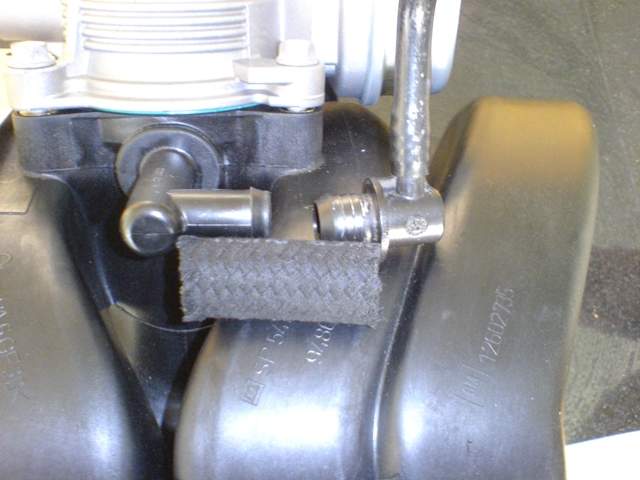

Lightning Coupé
The black braided pipe is 12.5mm rubber pipe that fits very snug, It goes on real easy but I had to cut the first piece off to get it apart again lol. Using the brake servo fitting means I can keep the original 8mm vac hose through the rest of the system
