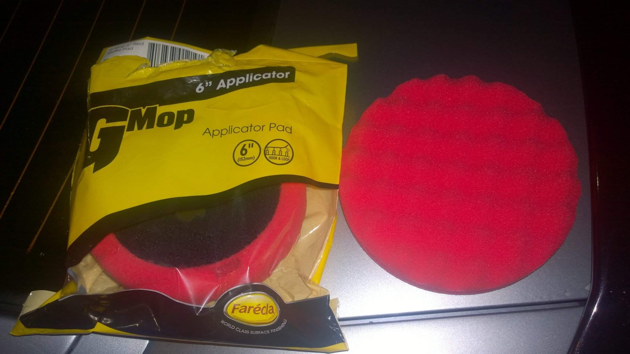

bought some new waffle pads im sure they were far too expensive being farecla not going to look at the receipt

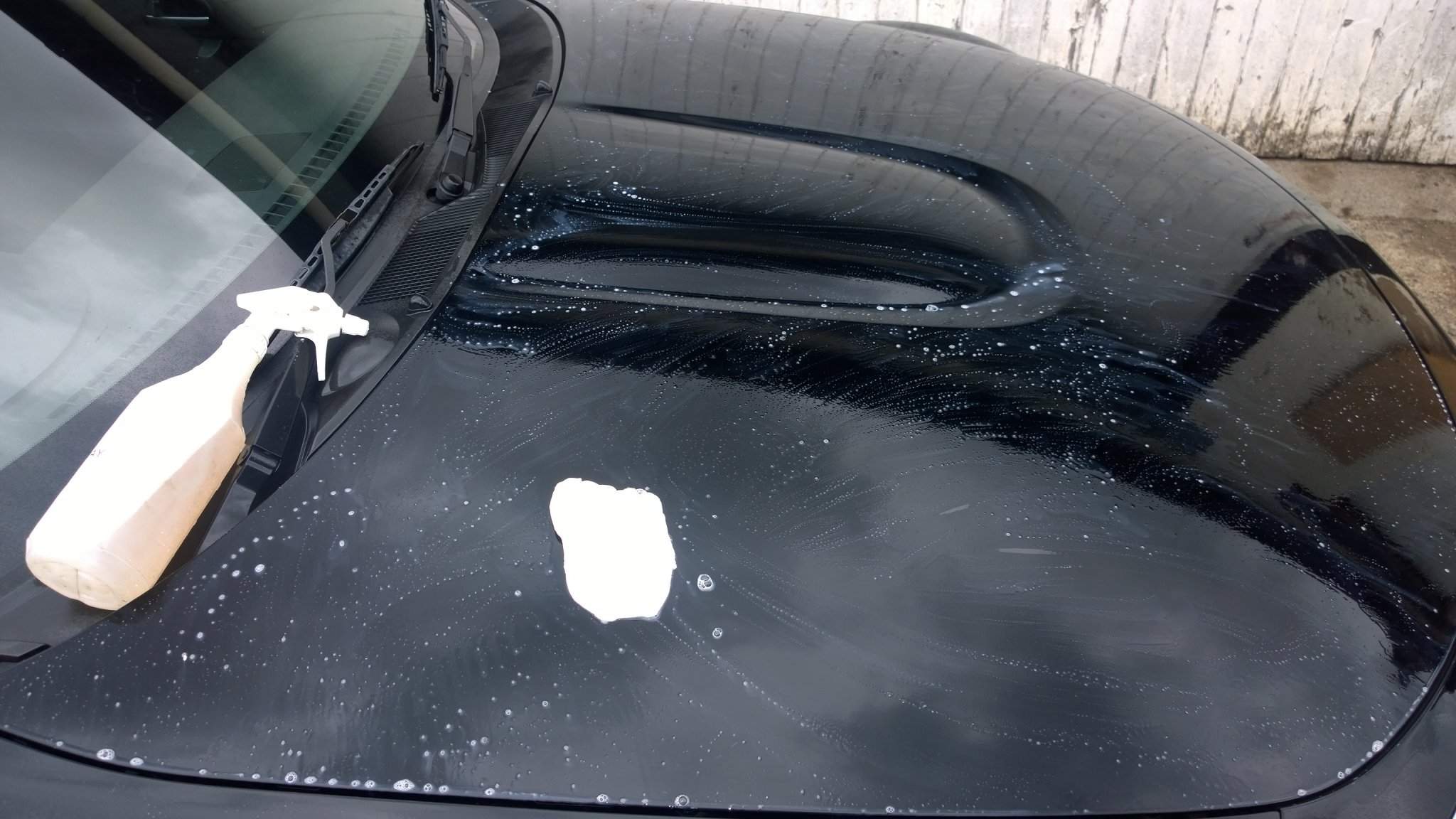

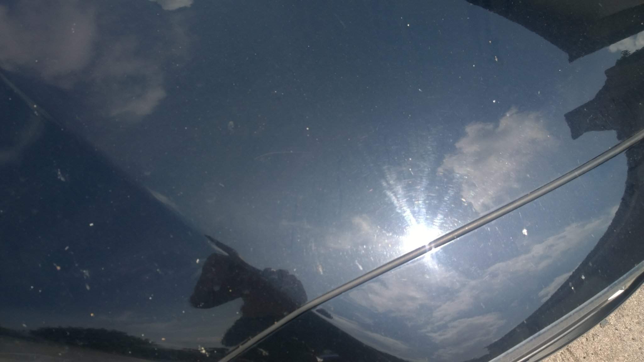

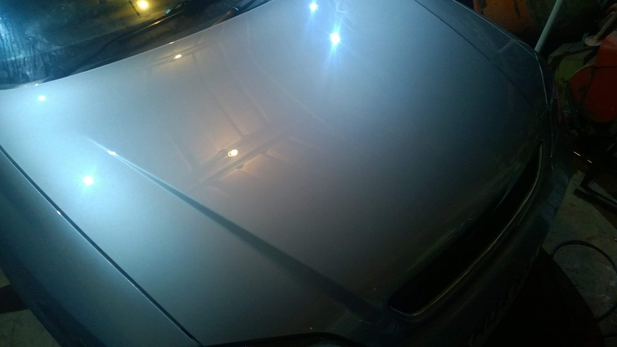

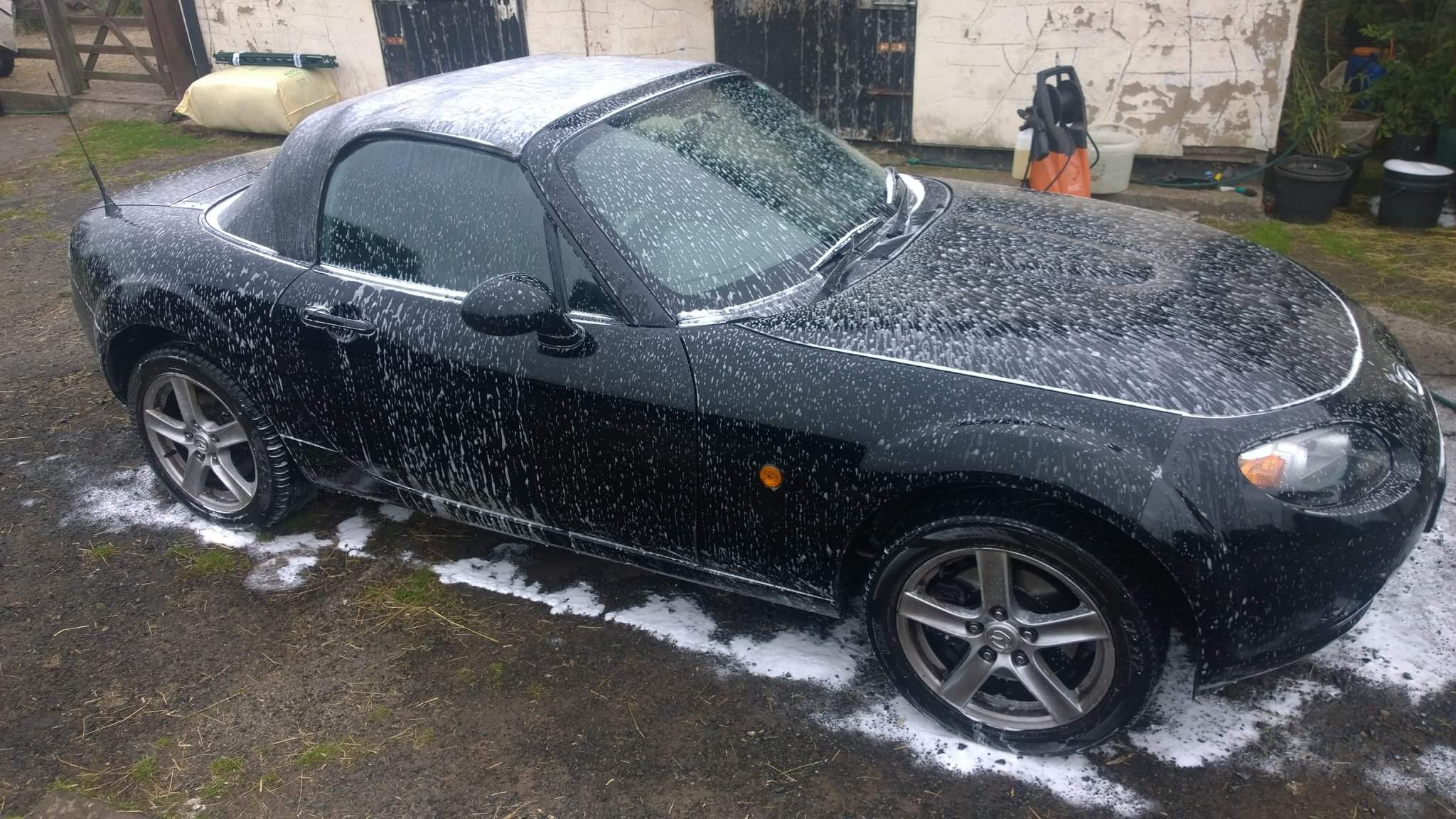

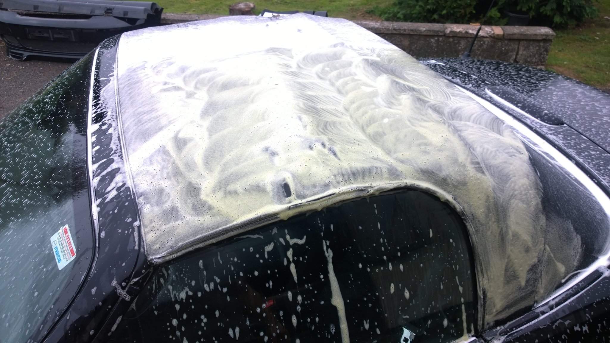

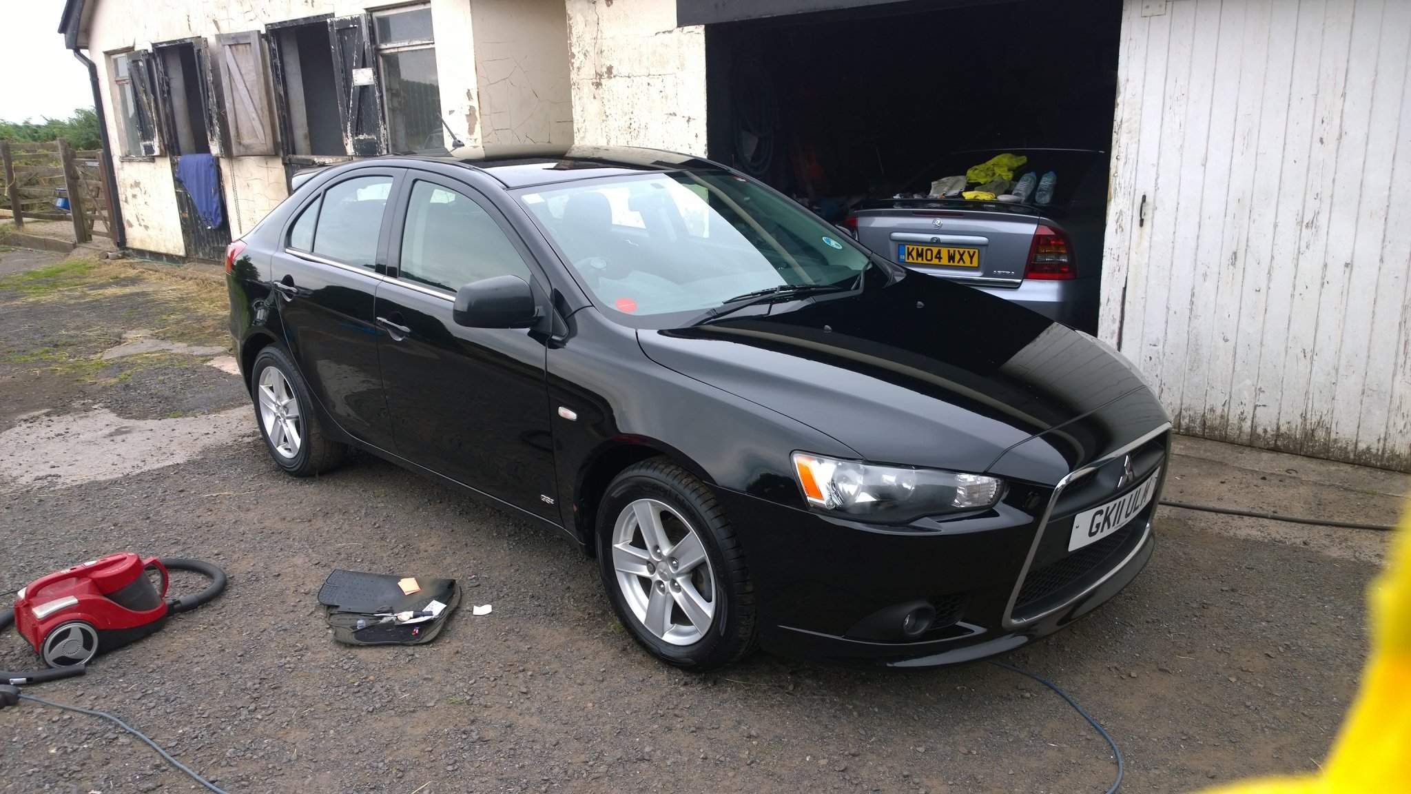

clayed the bonnet over with some car wash soap in a spray gun

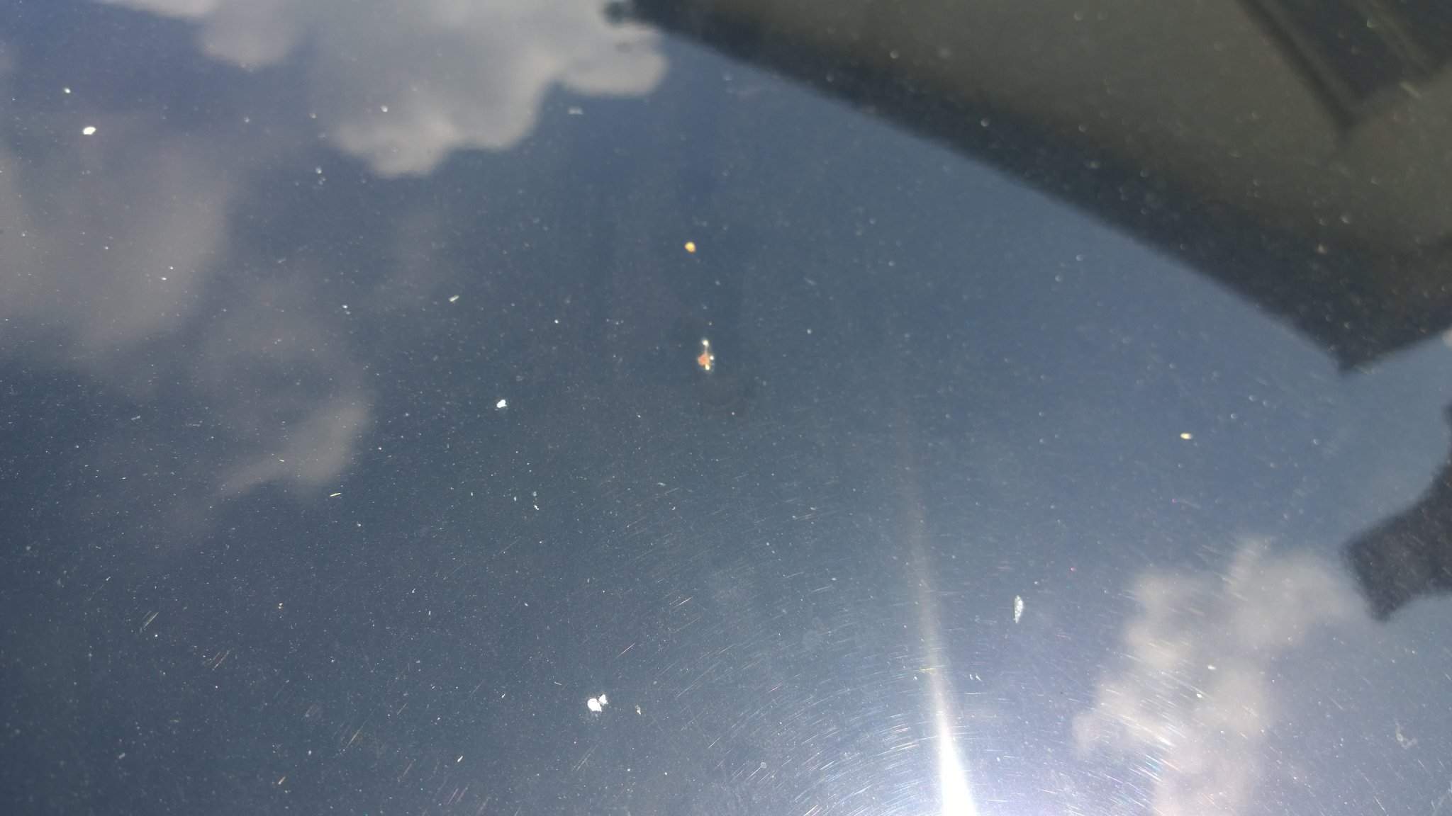

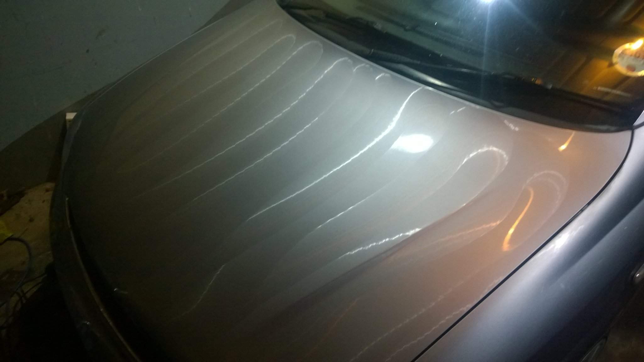

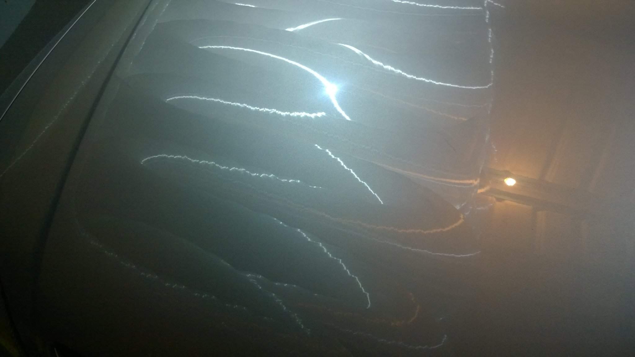

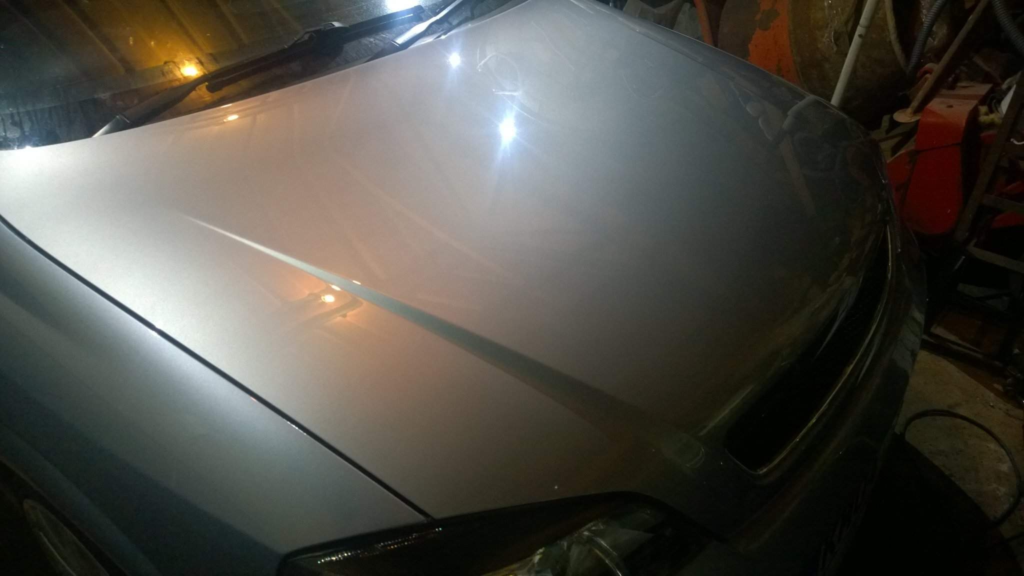

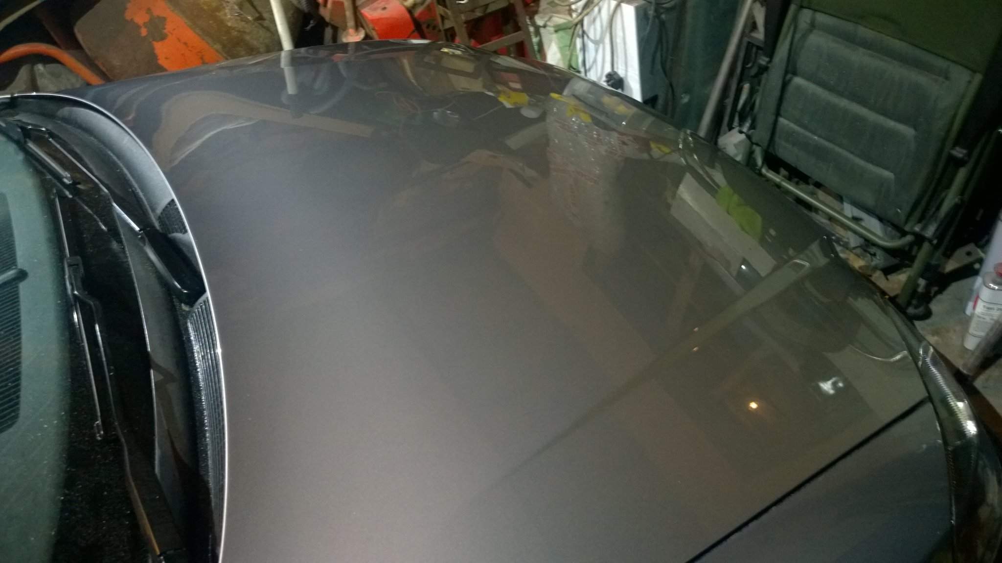

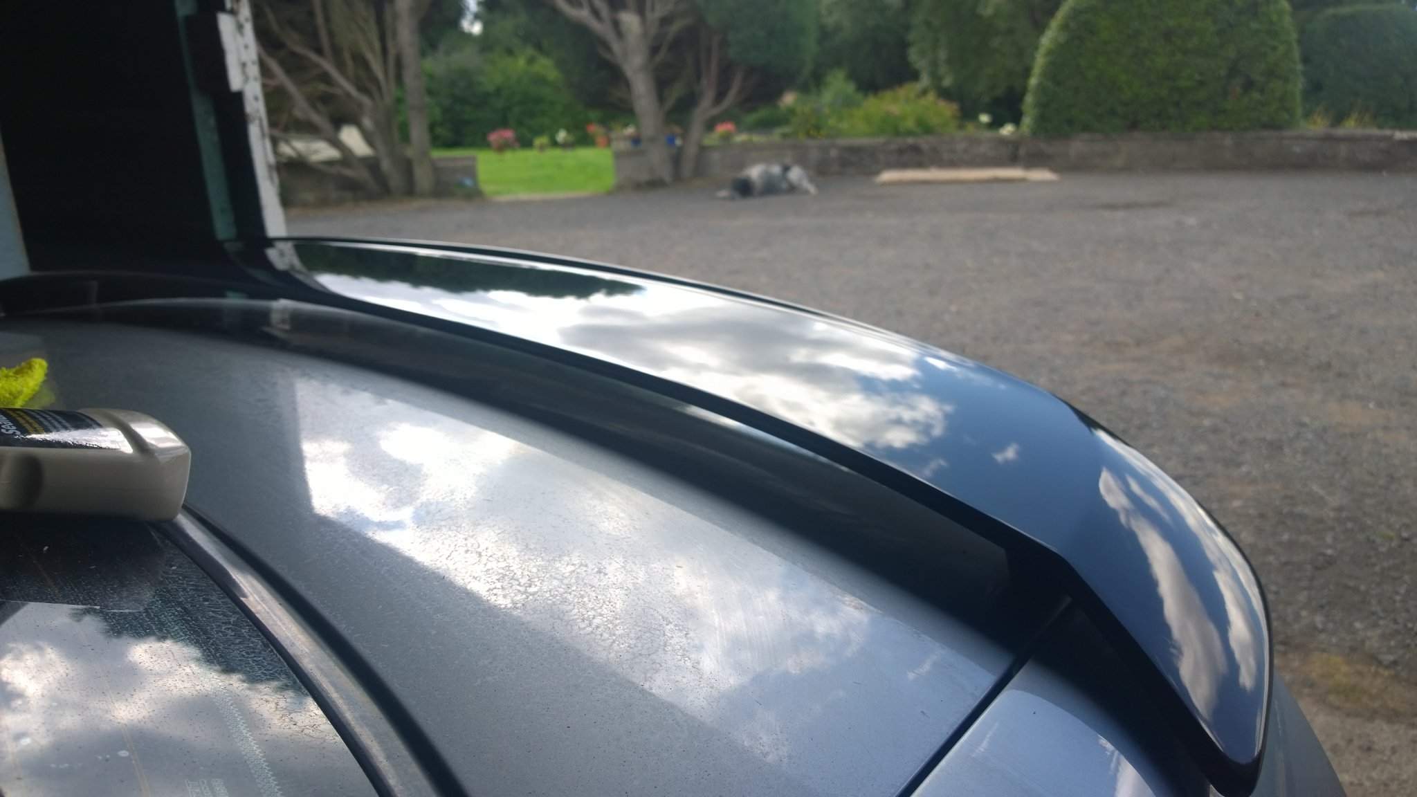

step 1 - megs ultimate compound low speed on the rotary with a overlapping pattern
at this point i was impressed the pad after doing the whole bonnet was still cool

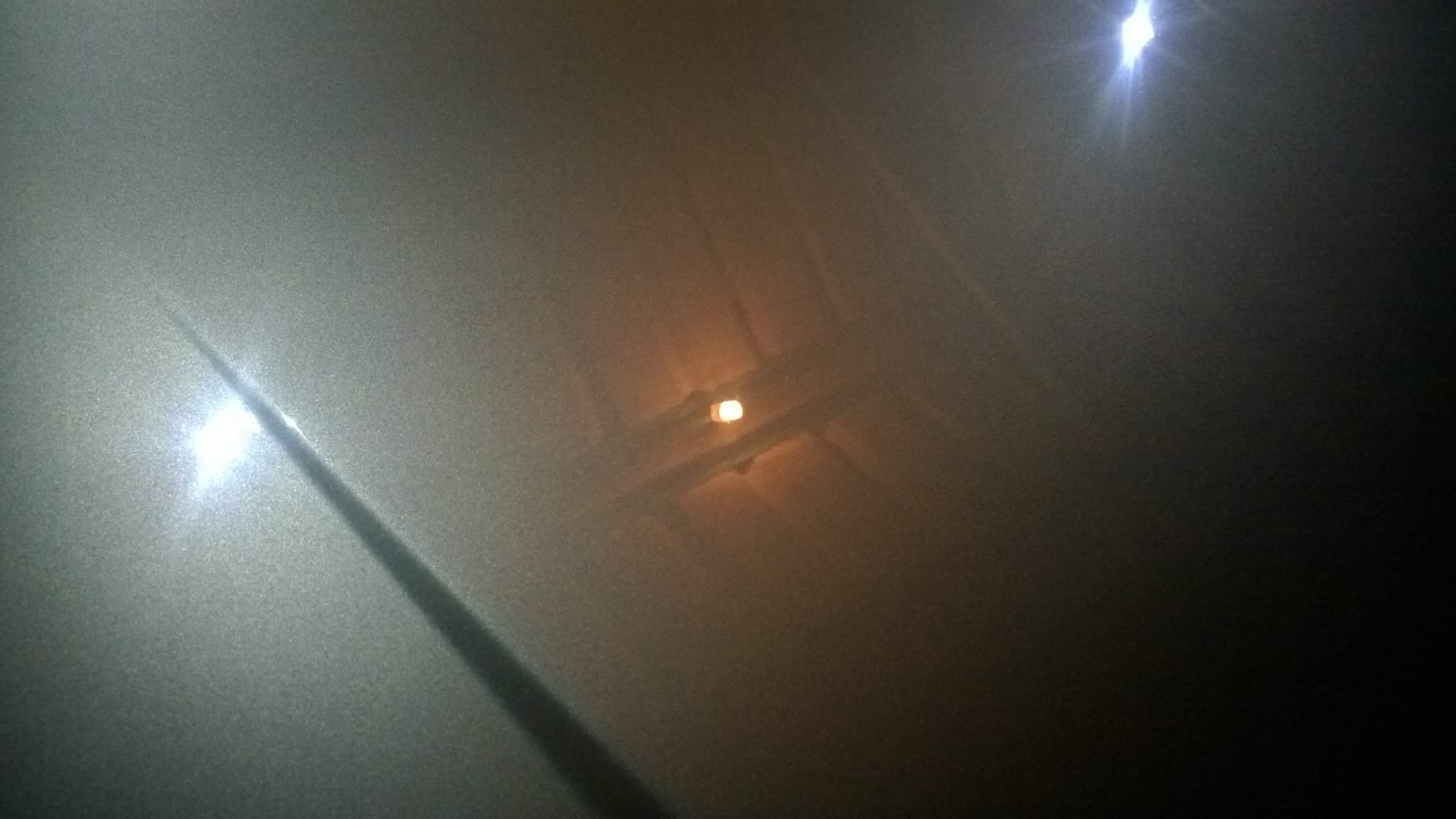

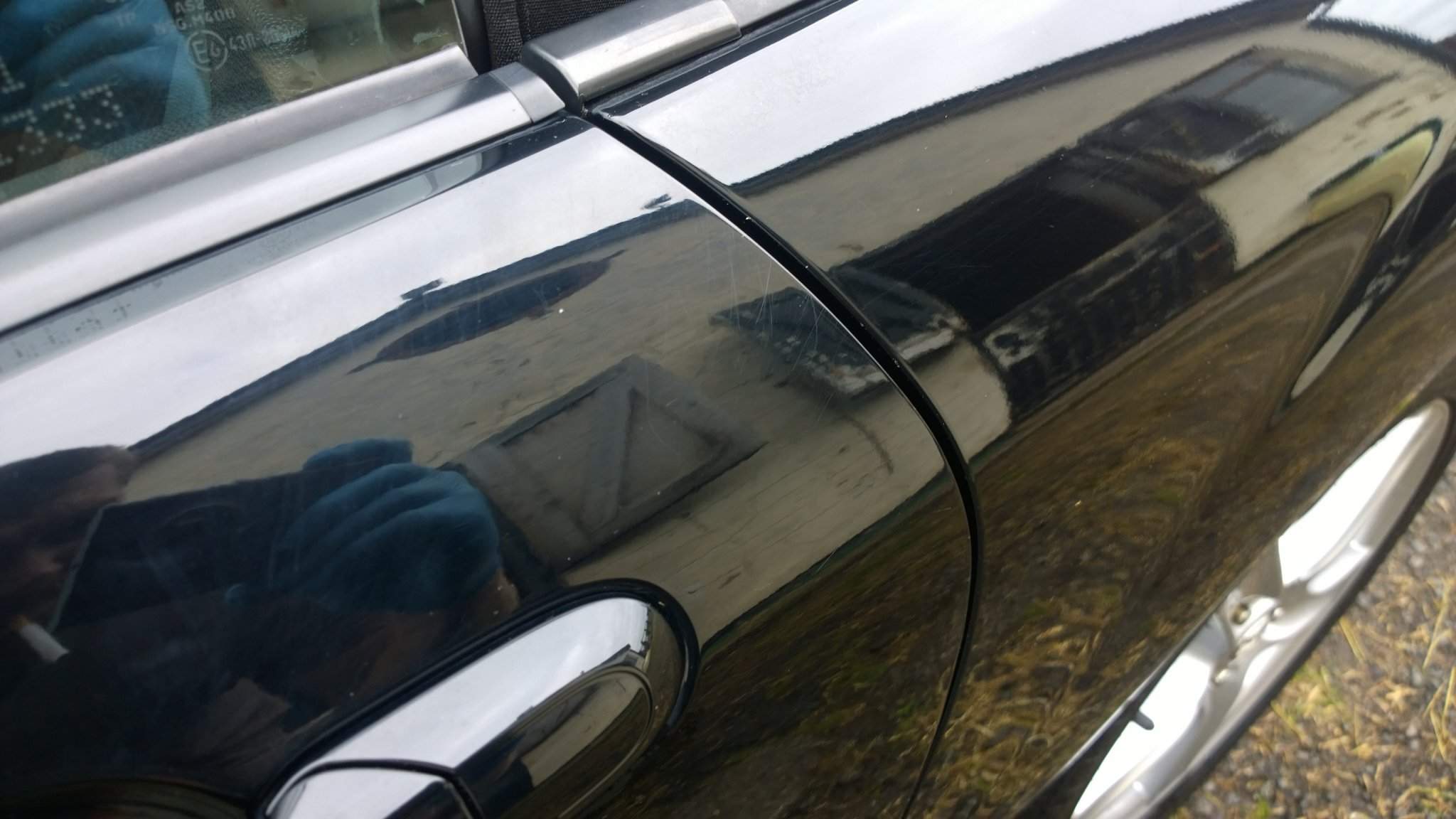

wipe down "shiney"

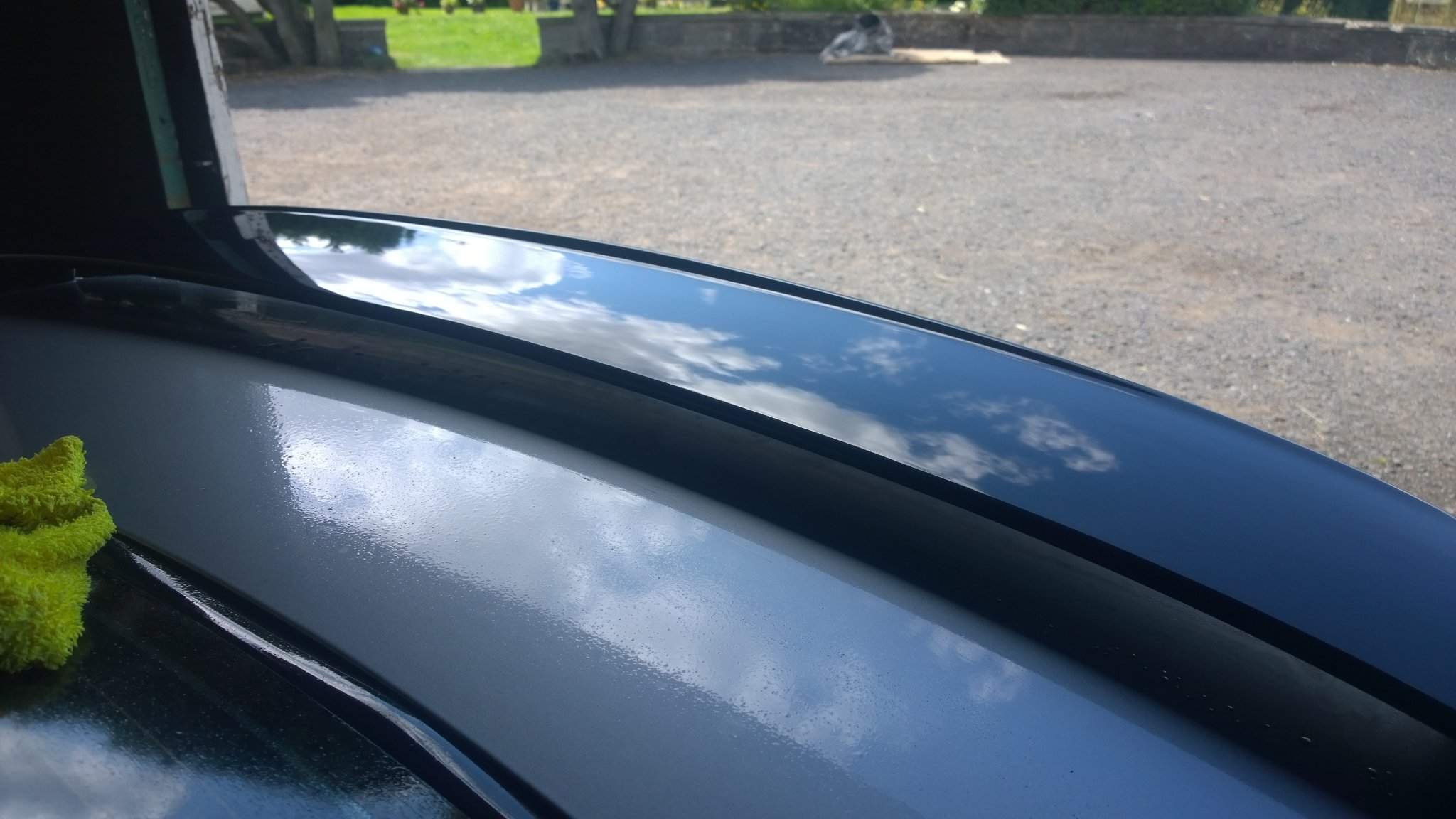

step 2 - megs ultimate polish faster speed with overlapping pattern
shiny #2

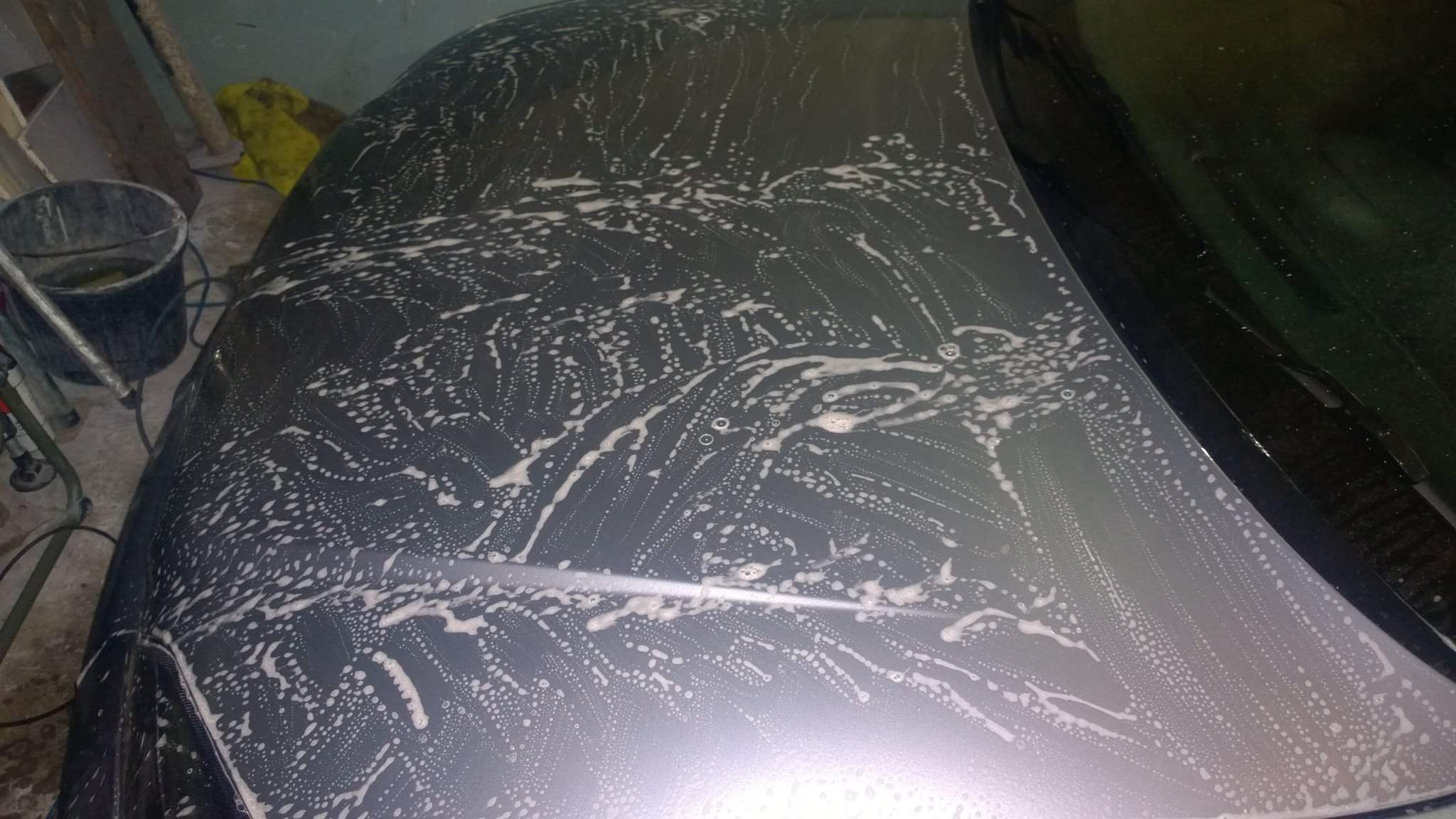

step 3 - megs #7 applied by hand removed before dry

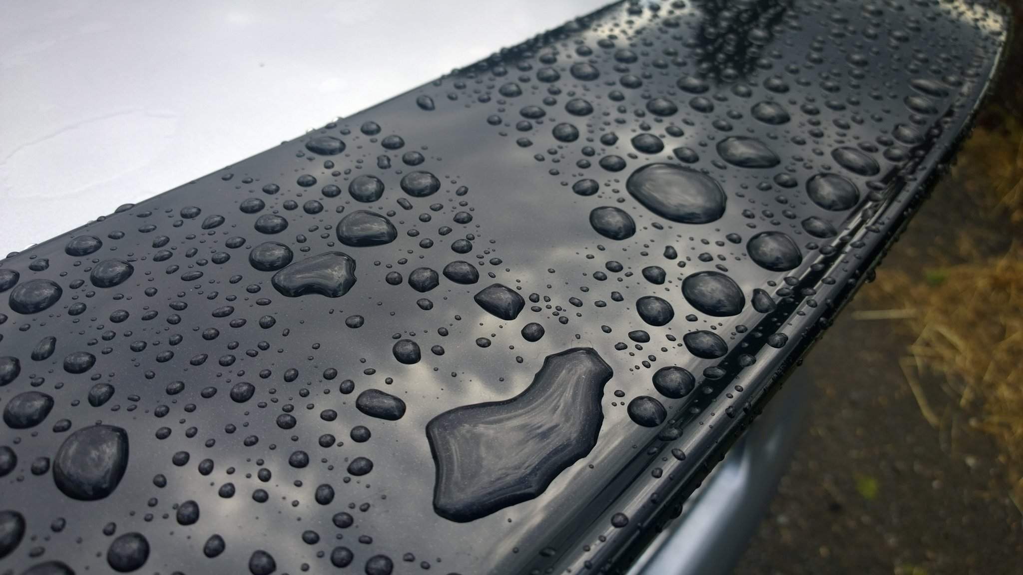

step 4 - megs #21 applied by hand buffed with meg microfiber after 10mins

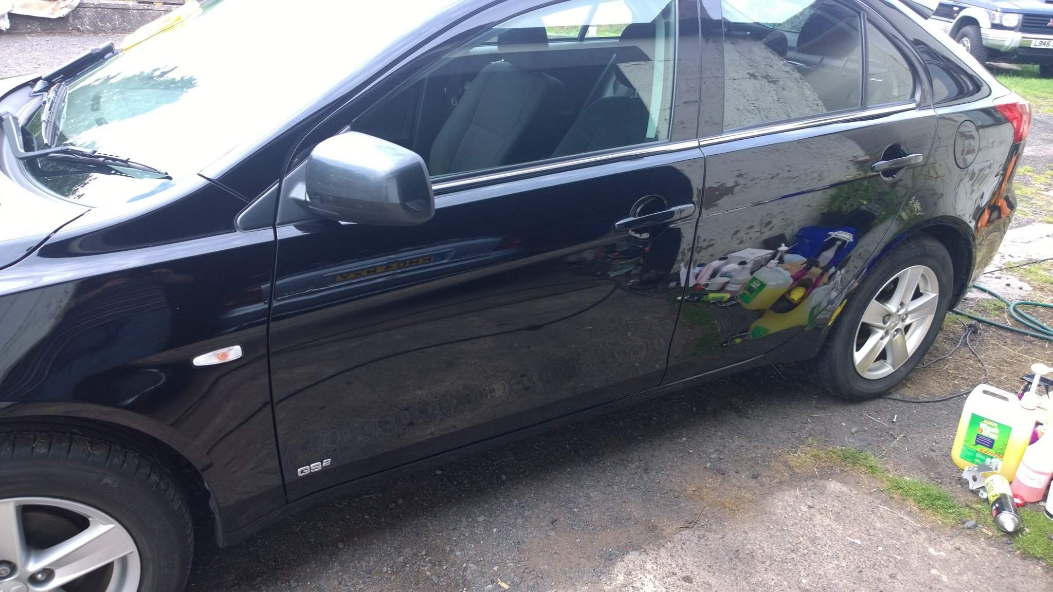

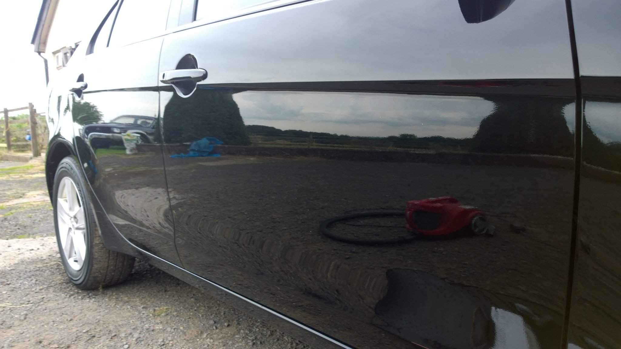

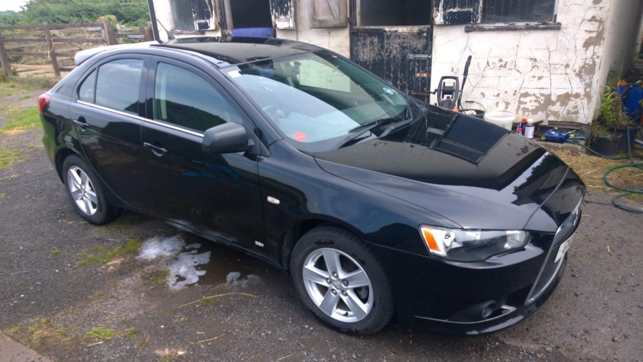

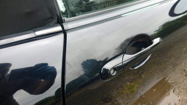

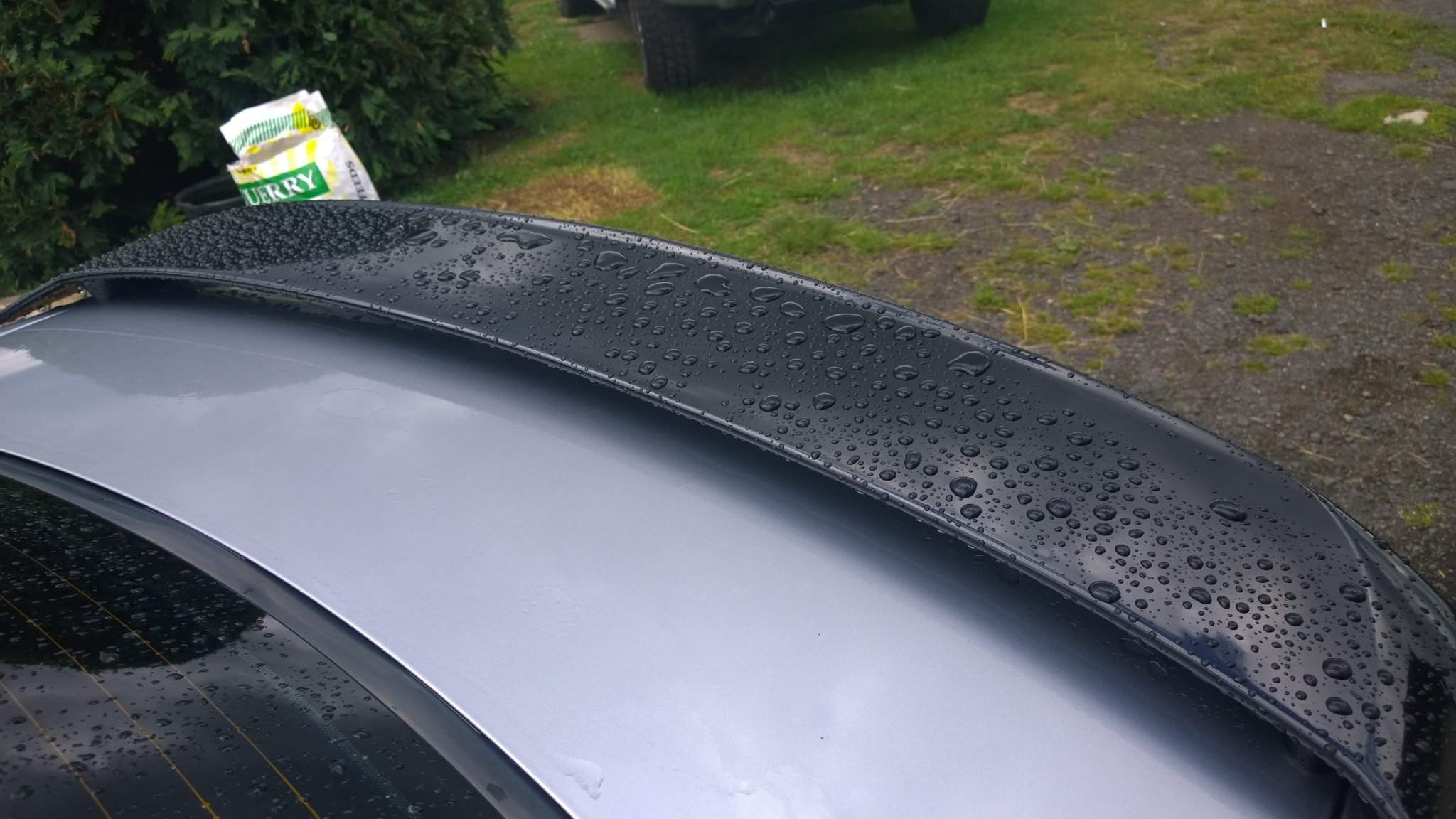

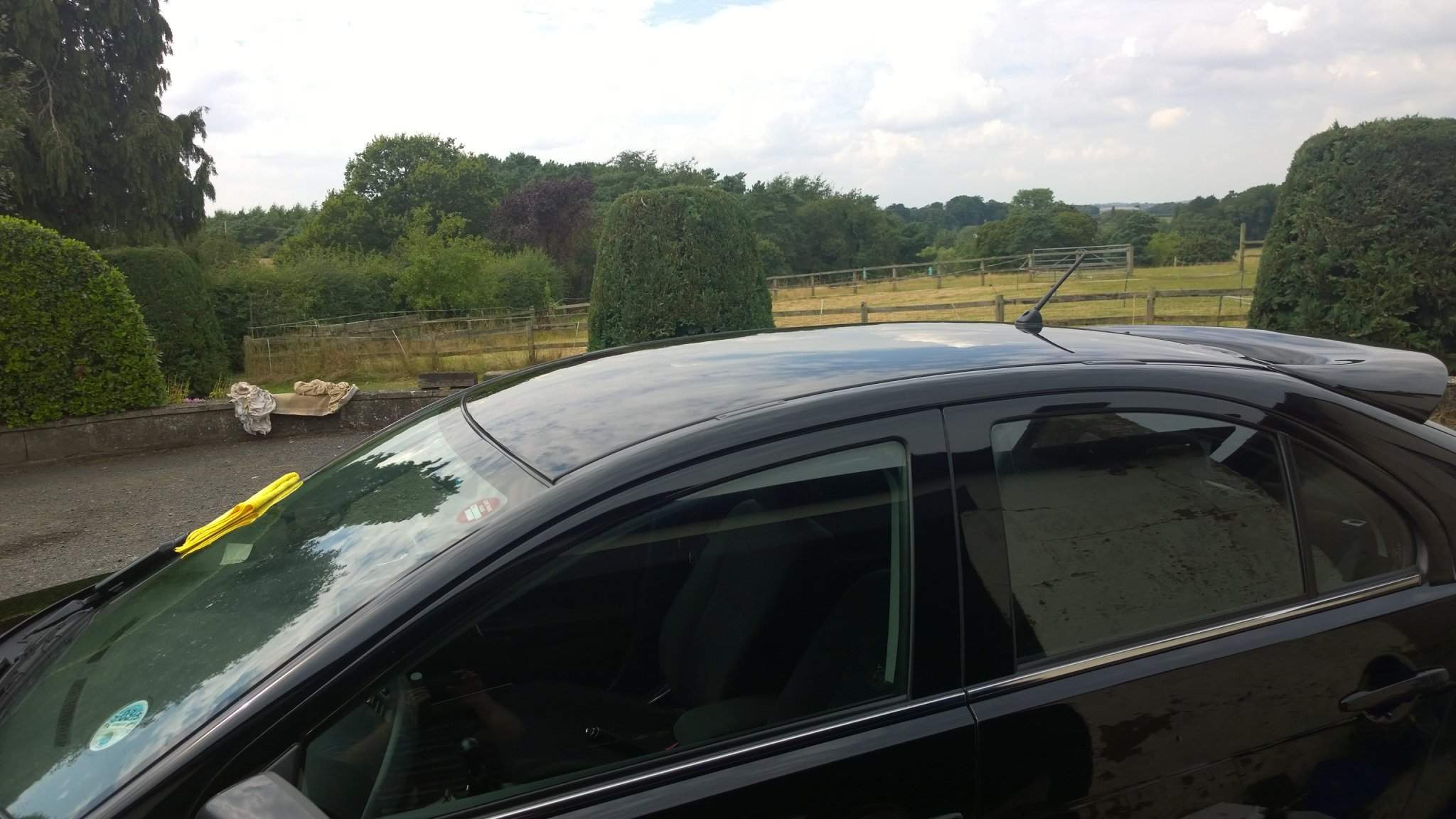

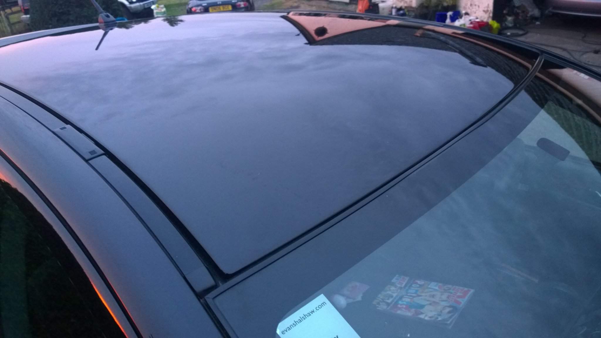

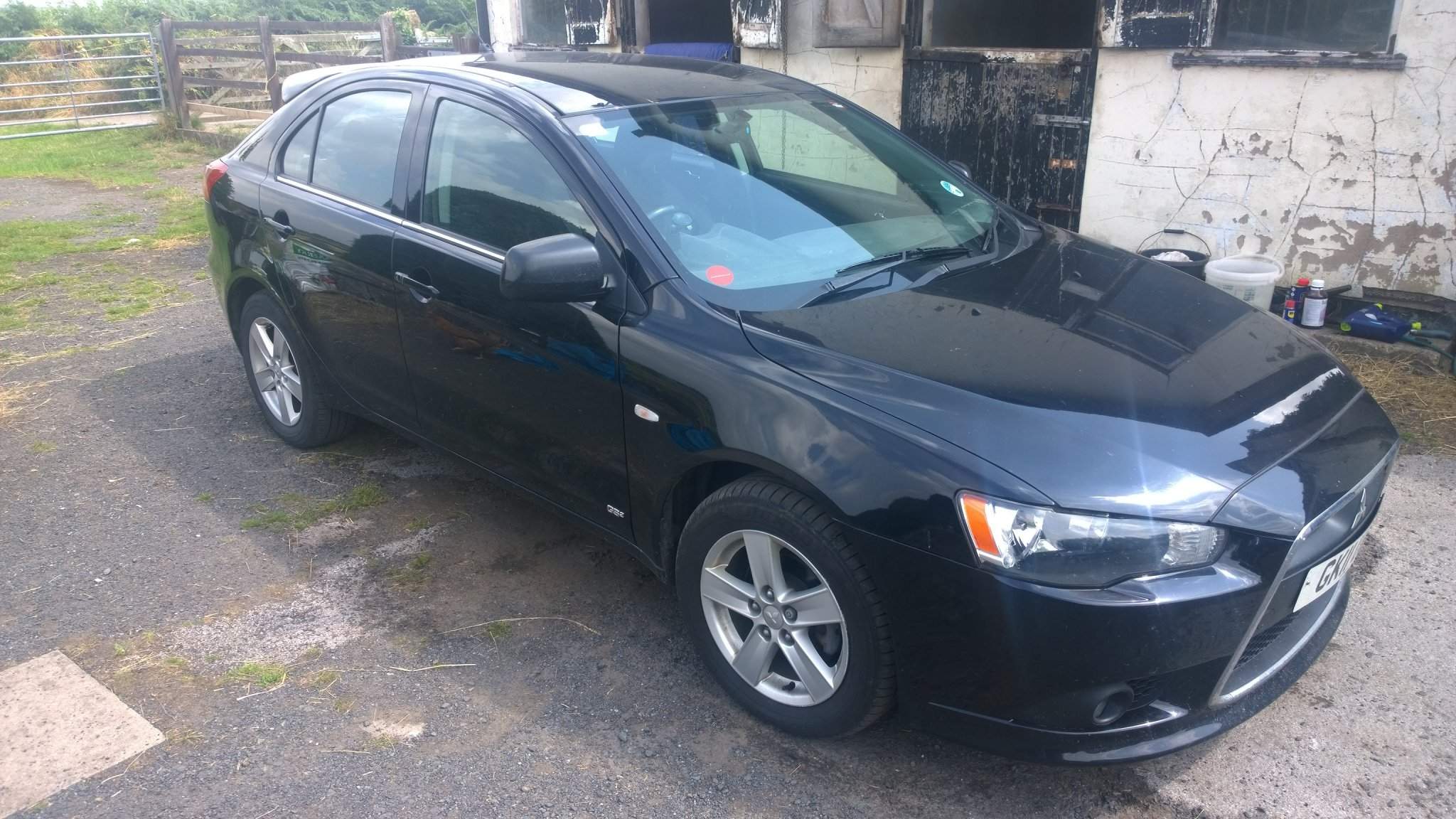

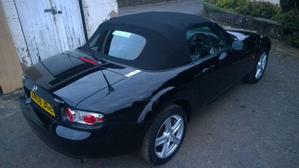

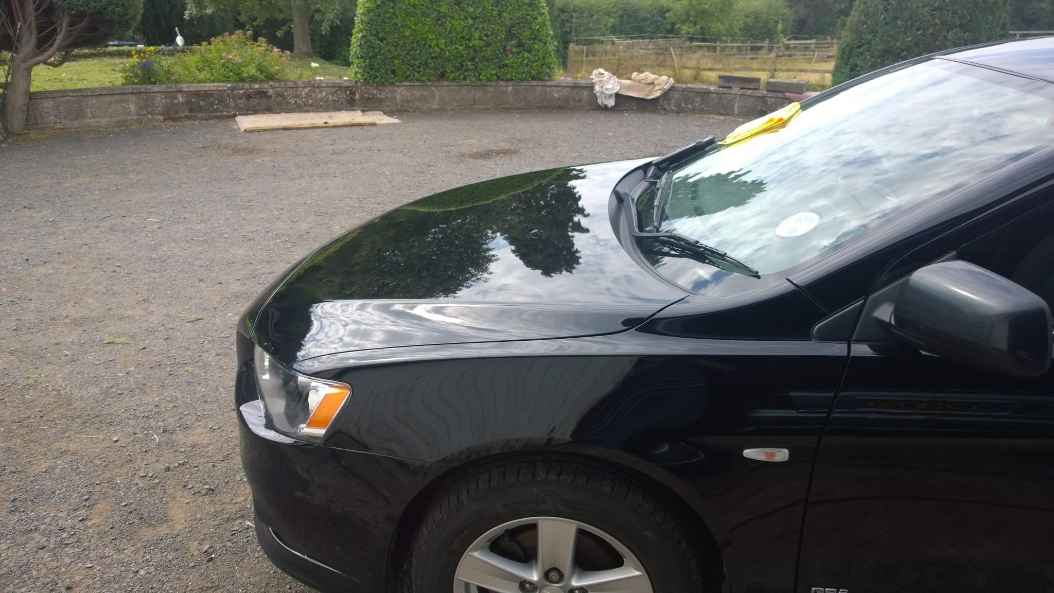

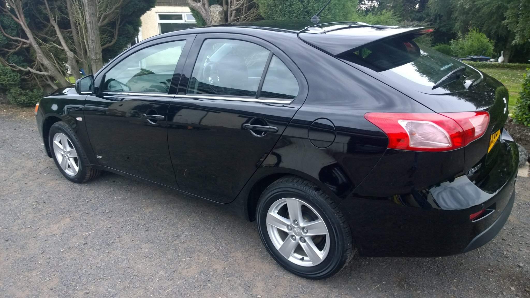

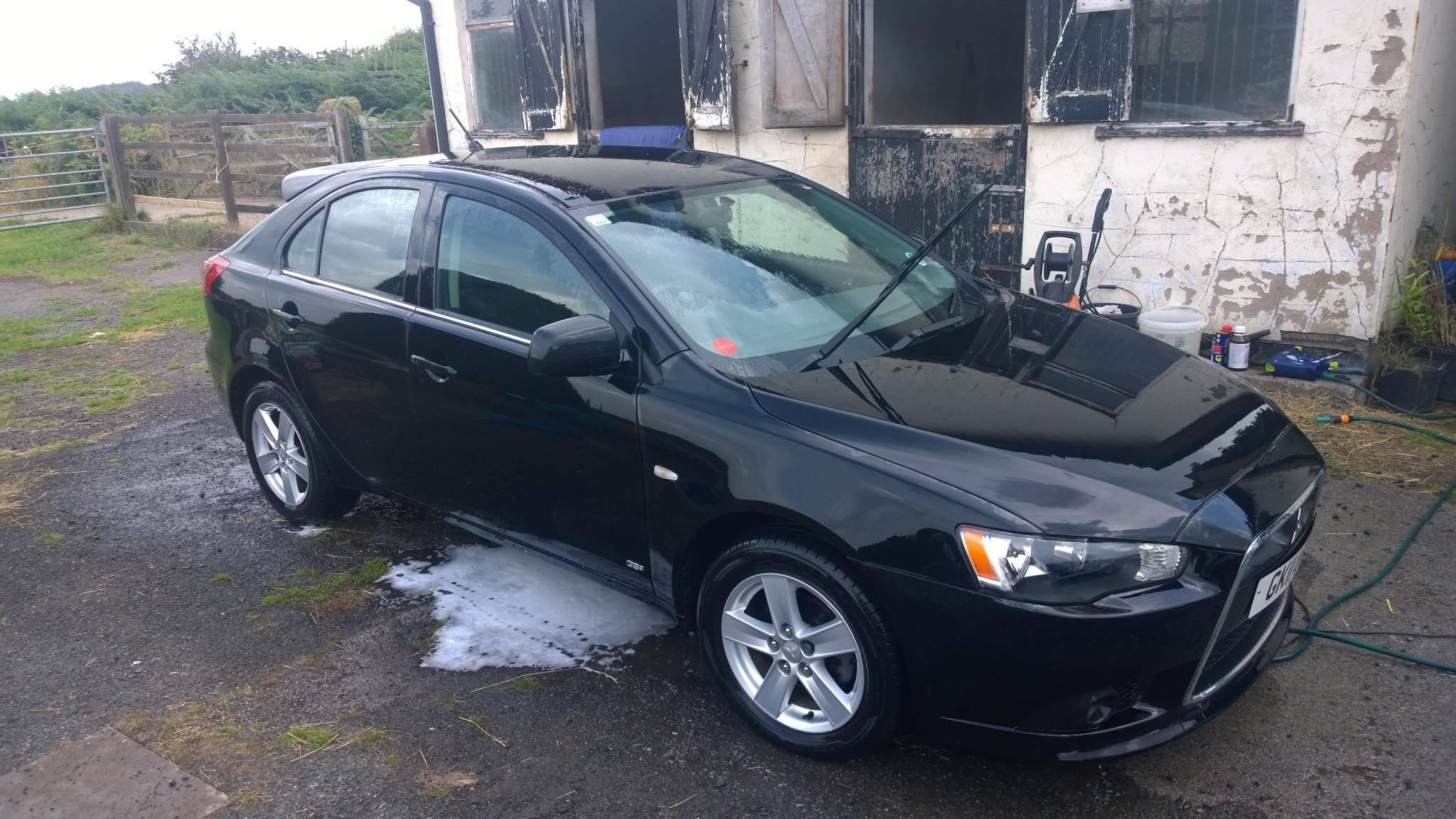

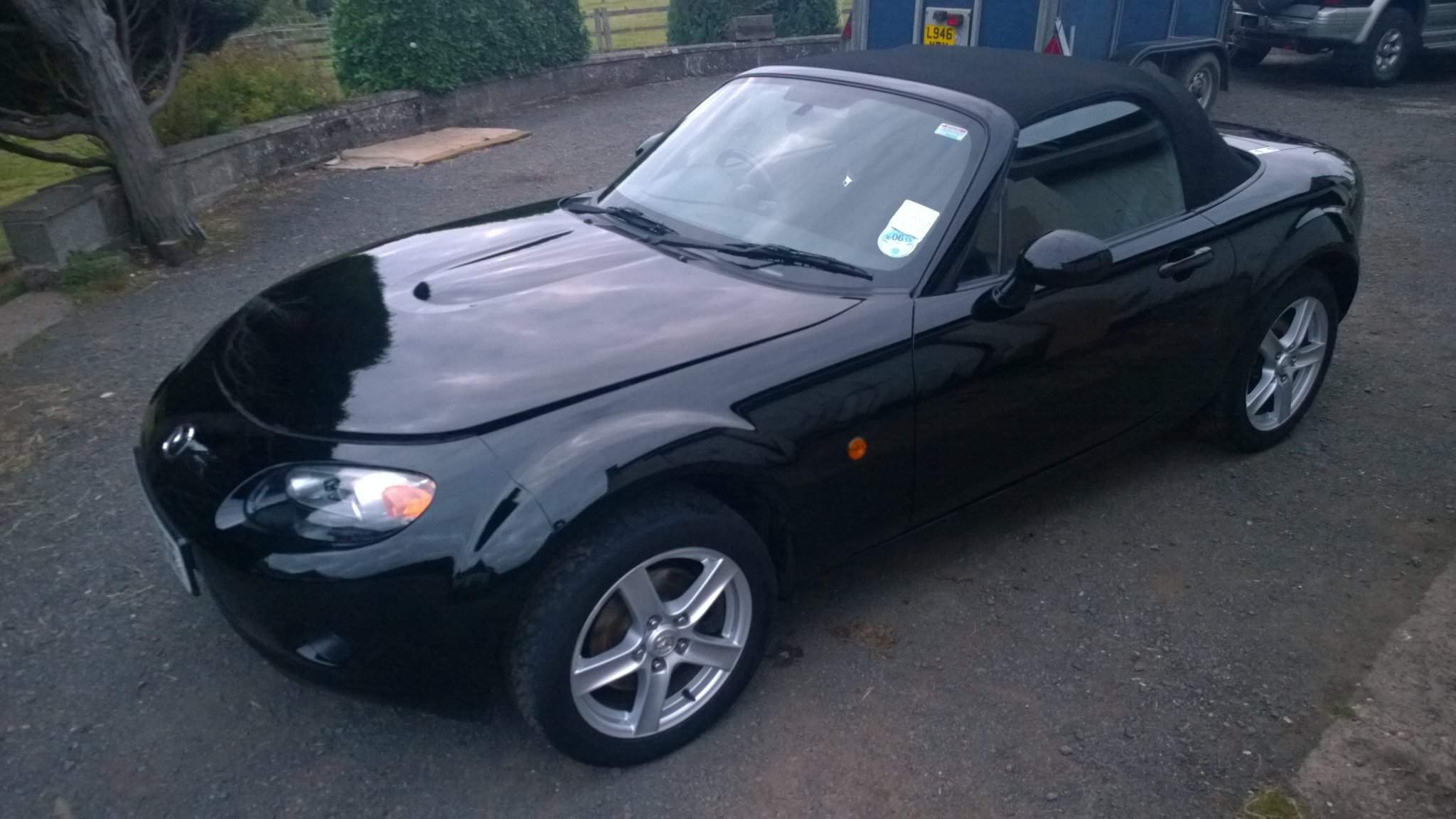

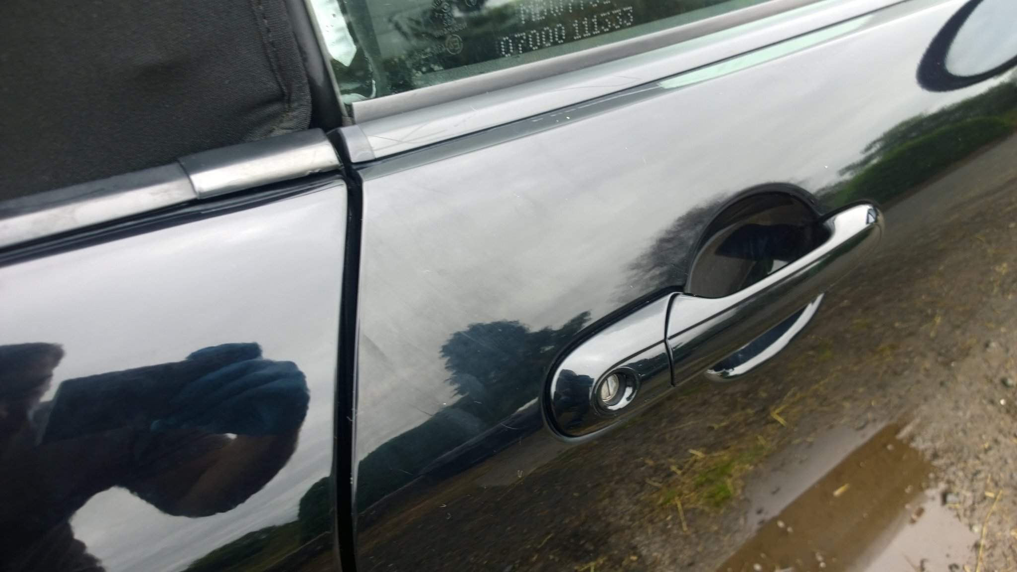

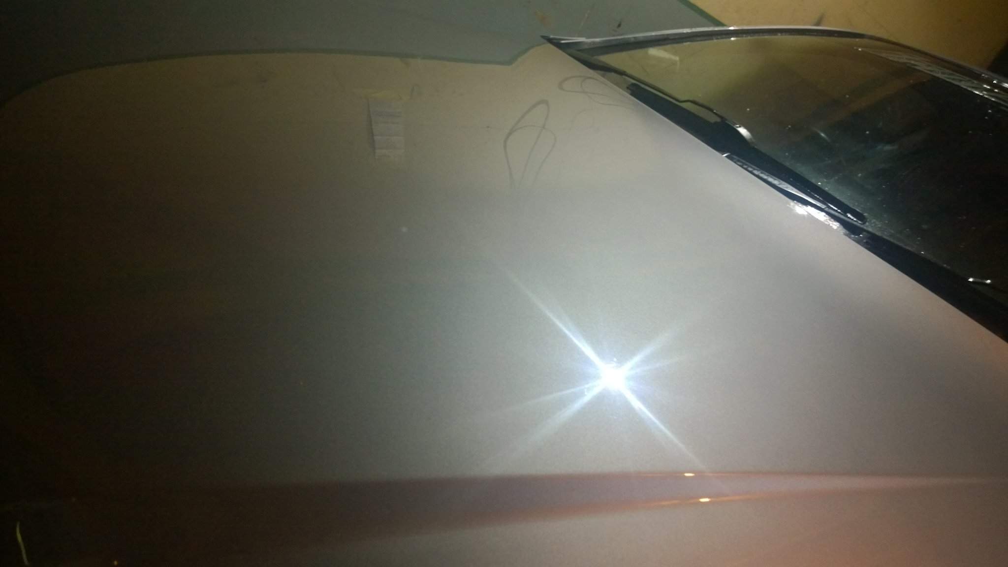

various shots of the finished item
