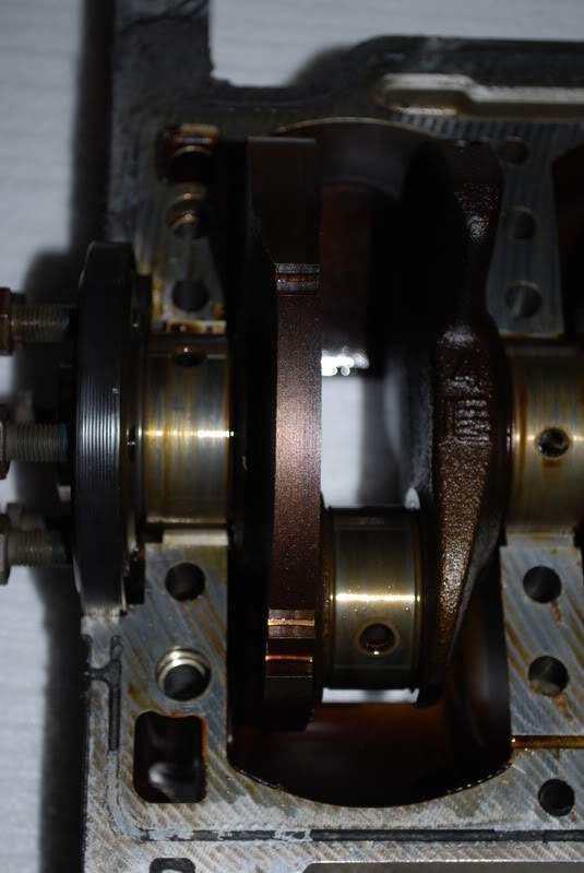

So far it's been self explanatory - sump, flywheel, rods, pistons; but now what
Am I safe to seperate the bottom third from the rest of it without causing future problems, or would I be best leaving it out in the elements with a cover over it :unsure:
If I do seperate the bottom to remove the crank, which of these sets of bolts do I need to remove (I'm presuming the crank is the massive weight that's left behind, and there isn't anything else I could take off to make it much lighter?)
Can I remove the crank by just undoing the ones circled in red, or can I remove the ones circled in green and bring it away as an assembly, or do I need to remove all of them?

is the crank posistion sensor wheel in the block or external?
if its internal can you get some piccies and also count the teeth etc :)
mandarinvx
Looks like this is the crank sensor hole on the right, located in the upper part of the block, but the sensor is obviously missing from this block
Looks like the switch to the left of it is either oil temp or pressure (this is a Vectra engine)
There are 7 positions on the built in trigger wheel, but one of those positions has two slots notsure.gif
