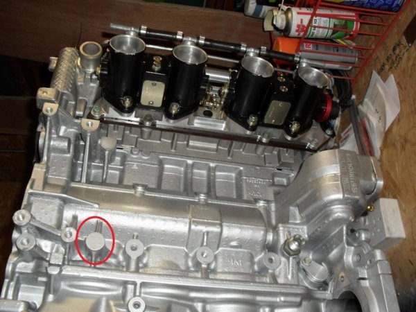

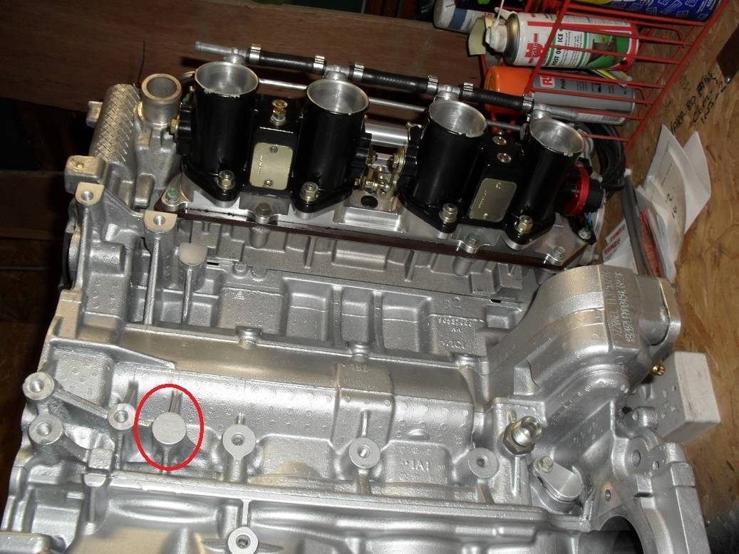

quite easy, the earlier B207 engines had a four balance weight crank and obviously a GEN 1 block, the later B207 have an eight balance weight crank and a GEN 2 block.
I have an early B207 block which came with a four weight crank, circa 2007
If you look hard enough you can see the engine number is a B207

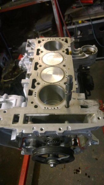

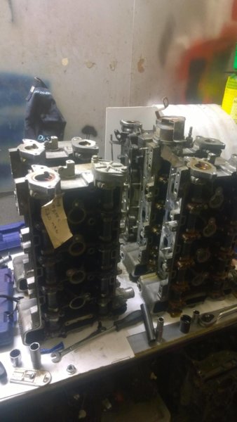

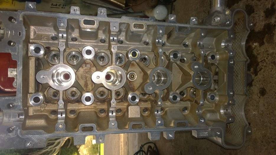

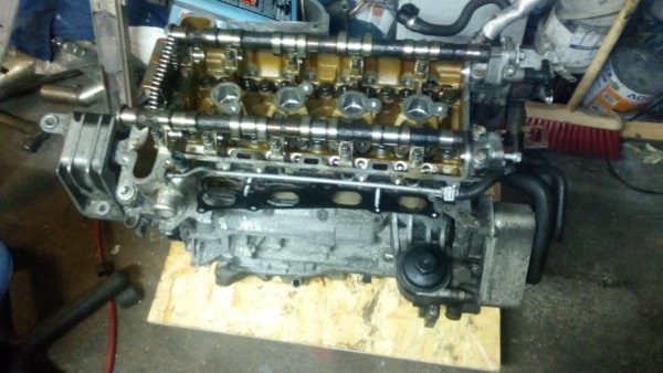

the bat cave saw an engine build this weekend its a wedged 2.0l thats compound charged :)

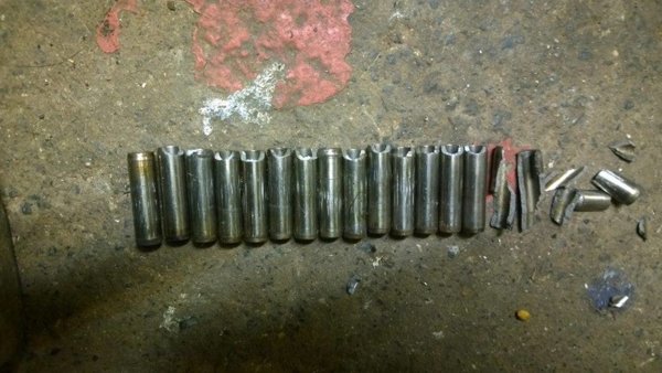

had to replace the dowels they got machined off :confused:
but the new bench got some weight on as the engine came from a mate who had a few heads laying about :)

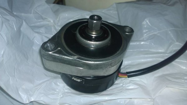

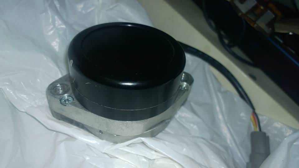

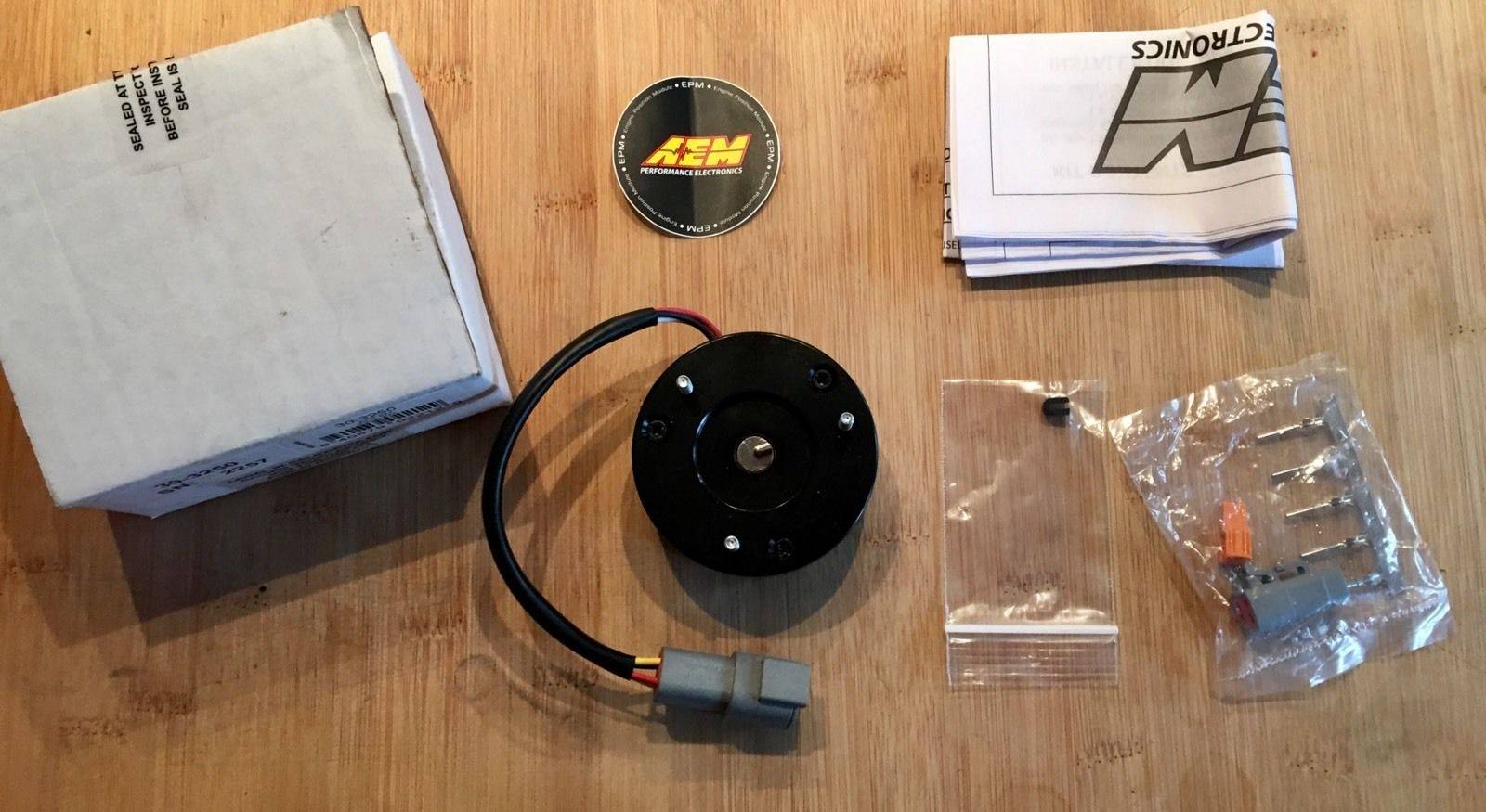

AEM engine position module on its way :confused: 24x crank and 1x cam in one box just need to adpot it to fit the inlet cam
i have a good friend in america who is going to help with mounting hardware :)

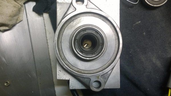

so the epm came and ive spent the last day or so building the contraption to make it work

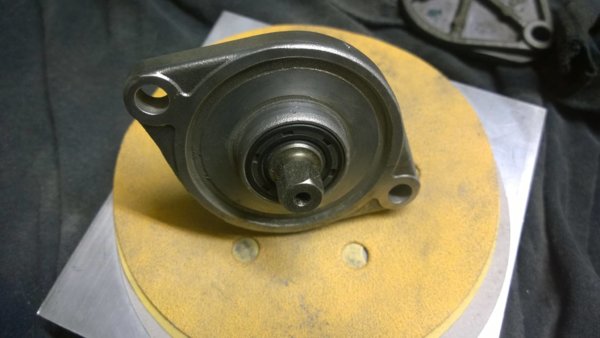

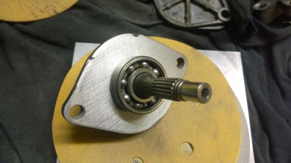

saab power steering pump cut down alot!
back side was flat sanded as i don't have a milling machine

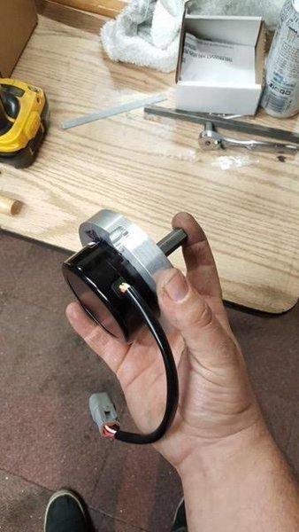

mounting the epm to a spacer plate

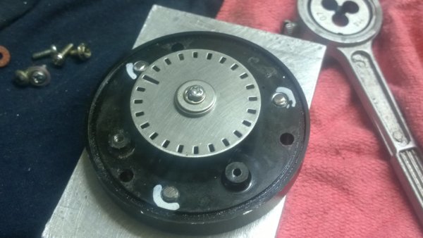

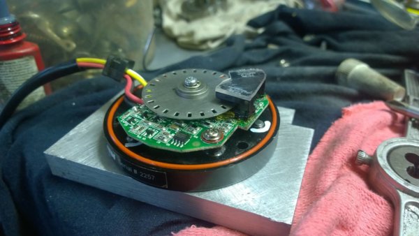

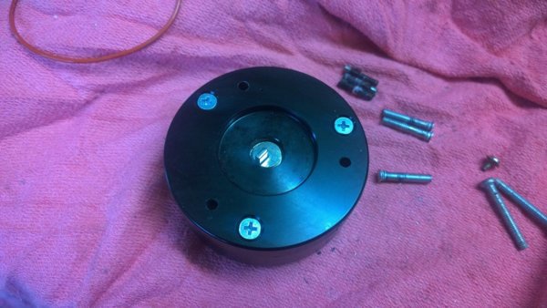

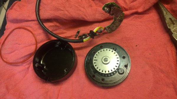

was not happy with the imperial bolts on the epm so stripped the unit to change them only to find one bolt on the pcb broken from the factory no screw head in sight and the main case screws were glued in
fixed it with an old pc case screw
changed the 8/32 studs to m5 threads then cut the bolts to length
made sure they would clear the pcb when bolted in
like so :)
taped the outer case for m4 bolts and then fitted new ones

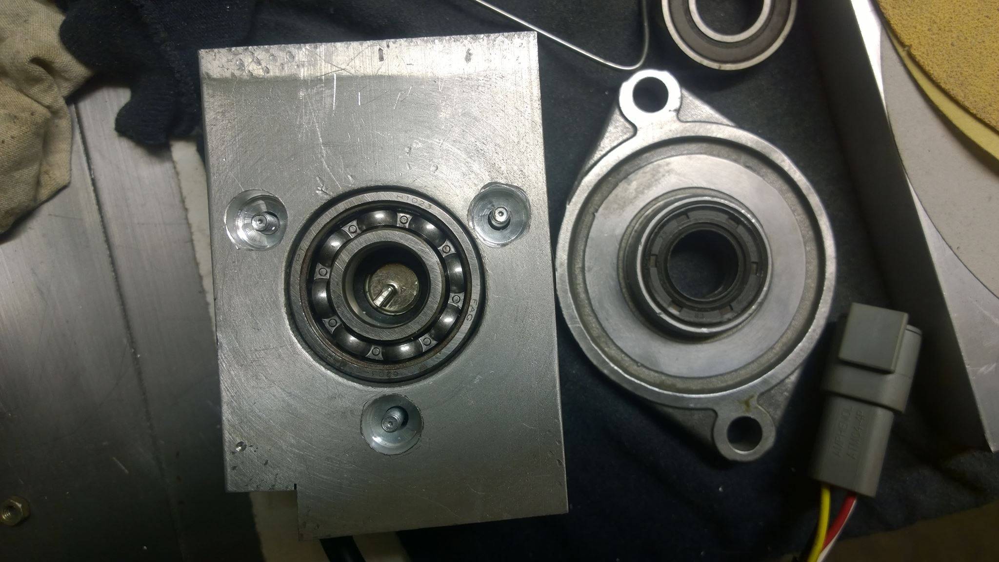

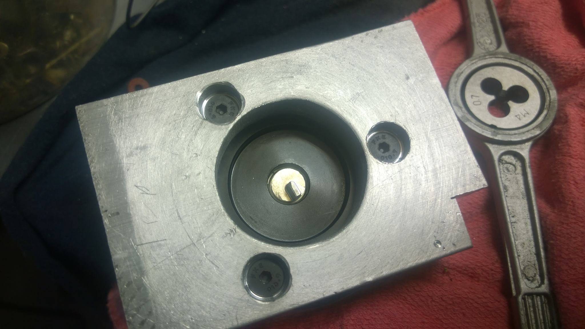

cut the shaft and put the notch in for the drive on the epm then shaped the spacer to the same shape as the ps plate then made sure it was running as true as i could
added 2 m4 countersunk bolts to hold the two plate together

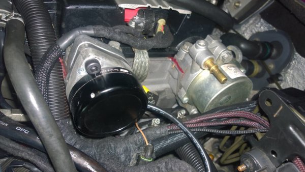

and thats the unit complete just need to add the wires to the ecu loom for the cam and crank signal and power and ground
this will give me the option to run full sequential and wasted spark once i change the firmware from semi sequential (crank only)

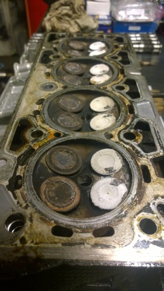

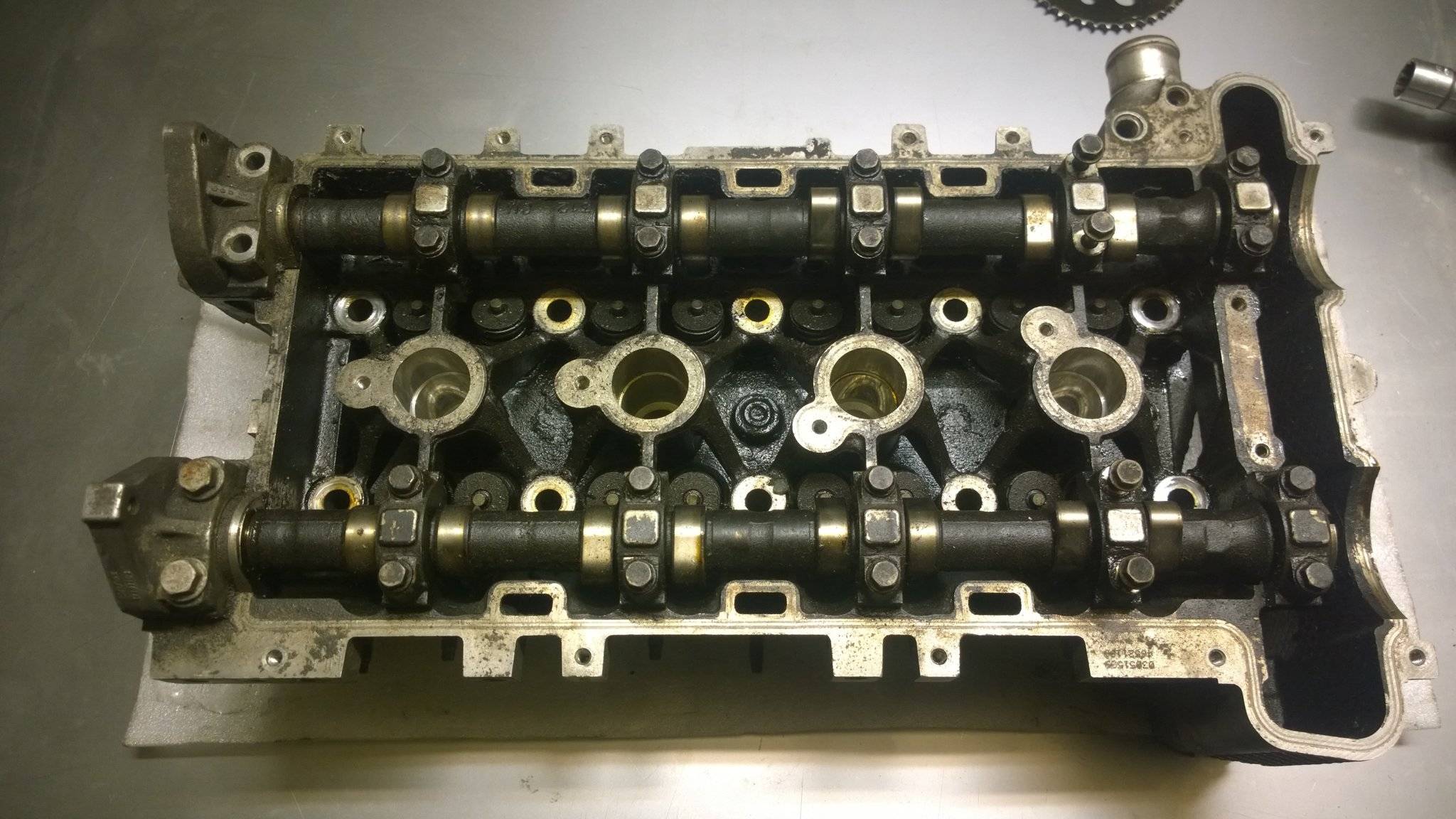

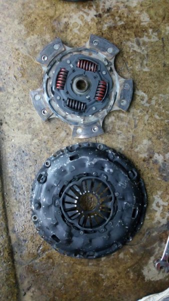

in other news clutch has had it
and the head gasket
rince and repeat
lack of cooling from a single fan and having the temp probe in the wrong location so it was not giving the right reading its like its melted the coating on the gasket and then i got water in the oil :confused:

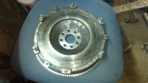

yeah the clutch did well for what it was its been funky for a while some days hard some days normal so guess it been going slowly
ive now got a list of jobs as long as my arm and then a parts list the same lol
i thought you had some fancy clutch before?
Had the twin plate when the f23 was in but then went back to a single plate with the m32

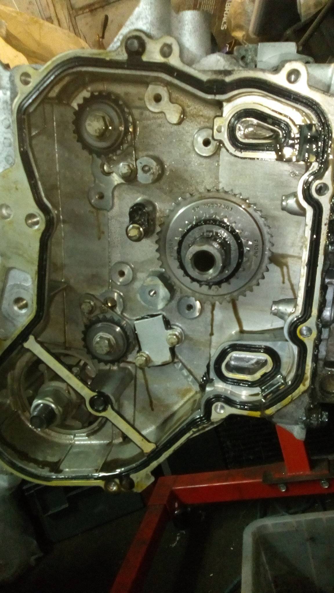

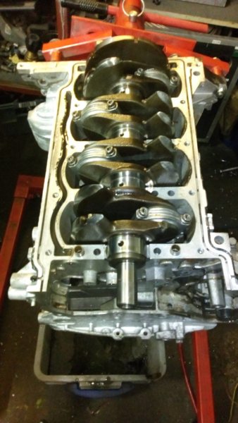

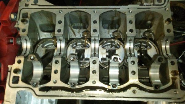

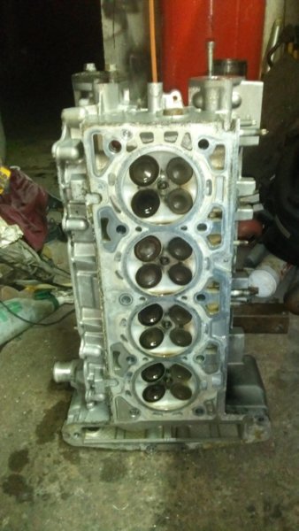

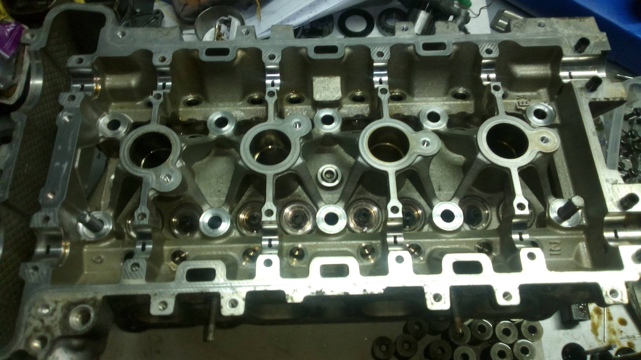

The old block now stripped the evans Coolant has washed the insideIMG_20170212_175052.jpg
All shells look normal
Crank looks good to

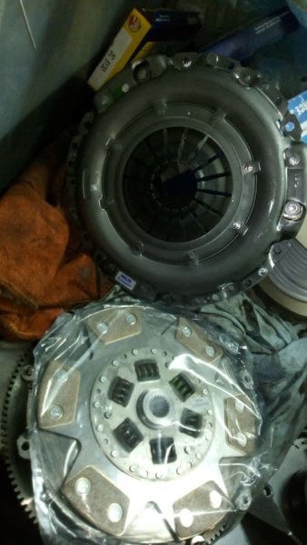

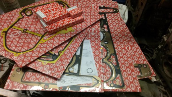

A bunch of new gaskets
And the new clutch
