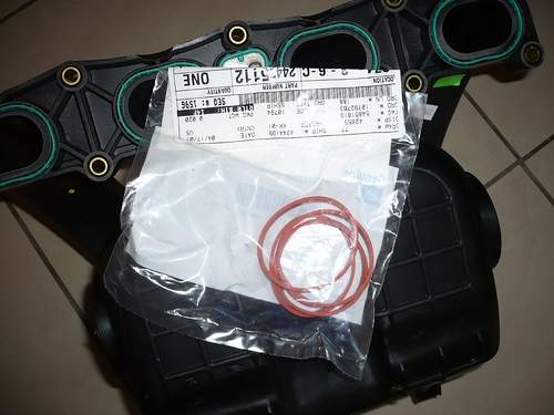

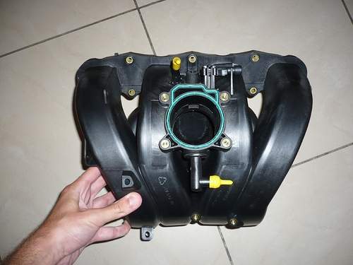

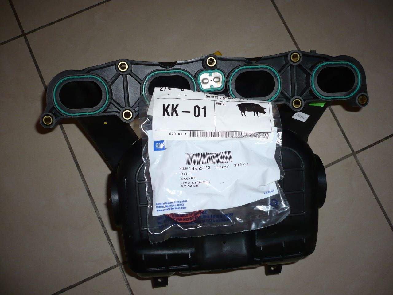

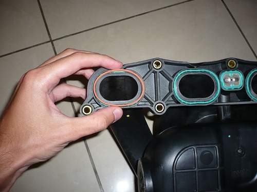

Ok guys, here are the pics
Well, strange gaskets...
wotsthestory
Can't quite read those part numbers, can you type them up please?

the green coloured gaskets are correct, the red gaskets are not needed :roll:
did you fit the green gaskets or did they come with the manifold notsure.gif
alanoo
vocky said:
alanoo
I looked again at your pics and saw you did not have them ?

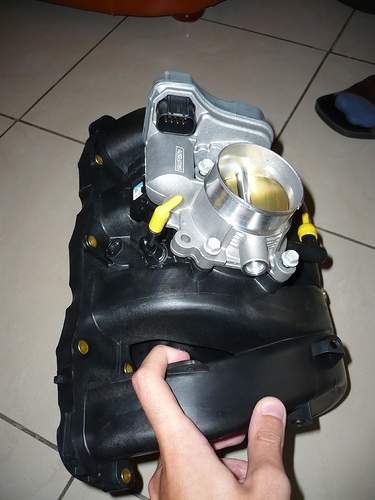

Markv has noticed the 58mm throttle body isn't a perfect match to the 2.4 inlet manifold with the 2.4 tb gasket.
I have just tried a spare 58mm throttle body on my 2.4 inlet manifold with the 2.2 tb gasket and it does seal.
I thought it best to point out you must use the 2.2 gasket if using the 58mm tb :)
p4cks
So the standard one thats on my 2.2 TB?
i.e. can I can use use the standard TB with this manifold and is a straight swap.
yes you need to use the 2.2 gasket, the tb fits but needs the four mounting holes opening up by 1.5mm, I think they are 6.5mm - so a 8mm hole :)
it's just that the gasket seal is close on one side of the tb and the 2.4 gasket is a bit thinner than the 2.2 :roll:
