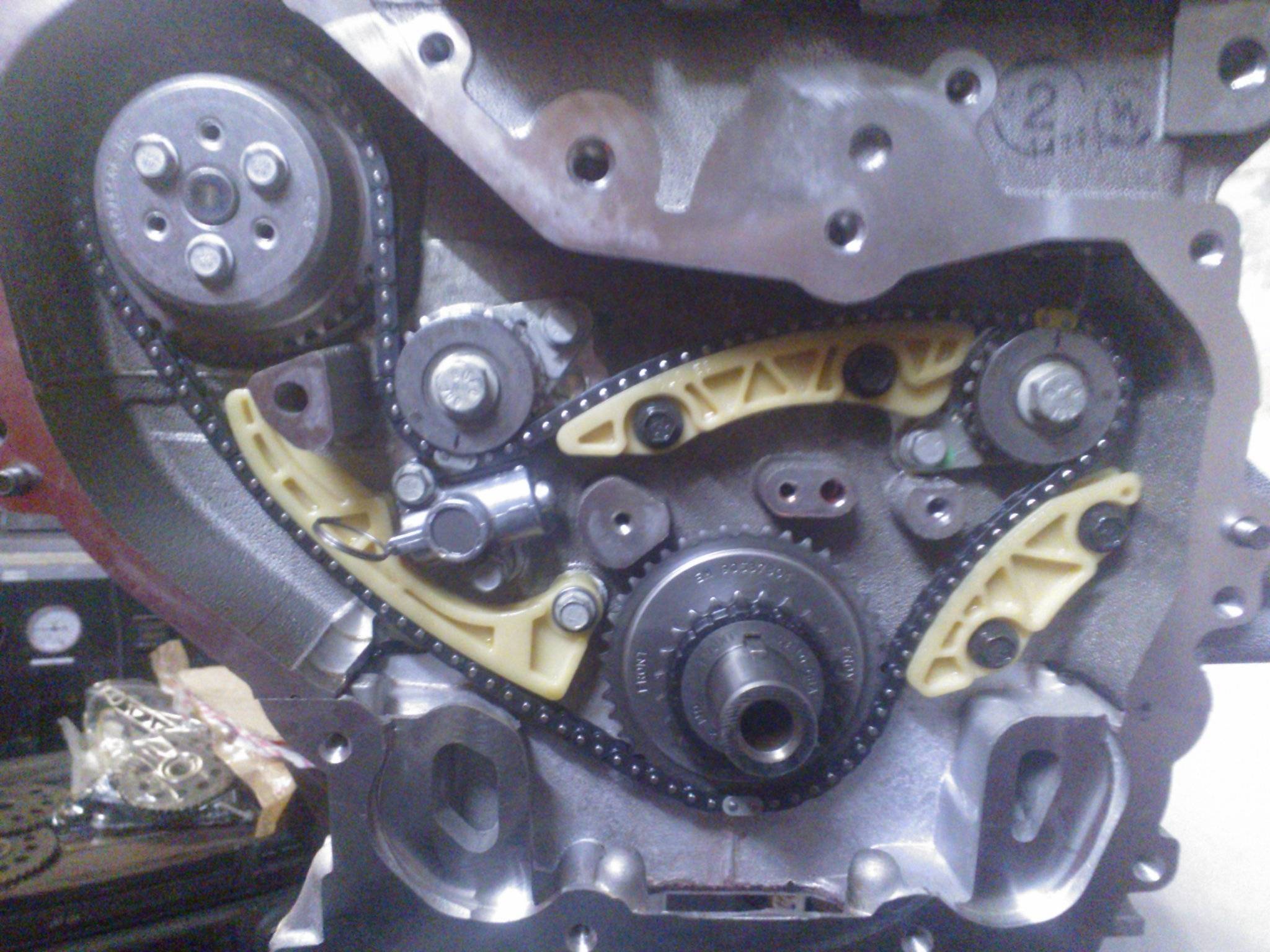

Failed Balance Chain Tensioner
When was your kit purchased / fitted Roy?
Hi matt it twas F.A.I I didn't buy it from you (unfortunately) I bought and fitted it in june 2013
but it's been noisy at start up and vibrating for a while,I got a secondhand manifold before I realised what it was more likely to be ,I changed my cat today and have got the power back,but the vibes are still there!
Roy Appleby
yes the engine needs to be at tdc for balancer chain alignment/fitting
Thanks I thought as much.......TDC.........and I'll be referring to the woodruff key at 12 o'clock
just waiting on my joints-the car's getting on so I'll be re-fitting the old GM tensioner
which works fine,I just hope that I don't find any broken down plastic in there !
Is running out of balance bad for the motor?
yes key facing up at the spark plugs :)
running with it out of time would cause the engine the have an unsteady idle and the fact the shafts would be fighting the movement of the engine would probably cause some power loss
cant say it would do any damage as ive not seen any destruct from it but consider at 6000rpm the balancer shafts are moving at 12000 rpm
THANKS..............I'll open her up Monday!!

100% balance chain tensioner.
if your getting vibration it may have jumped
if you havnt allready I would replave the whole balance chain kit. Get GM its worth the extra 20quid or so.
Problem with doing the balance chain is you have to remove the timing chain to get to it I believe
shame it wasnt done at the same time as the timing chain.
