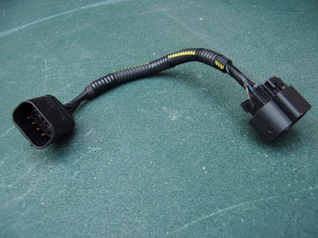

Vocky, if you read this, where did you get the plugs and socket for your 2.0SC TB wiring loom extension (below) or can you make one up for me, for a suitable donation?
