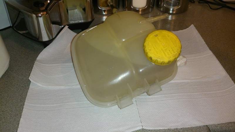

Time to carry out a Coolant header tank leak test on a clean used Coolant header tank with level sensor ready for fitment...

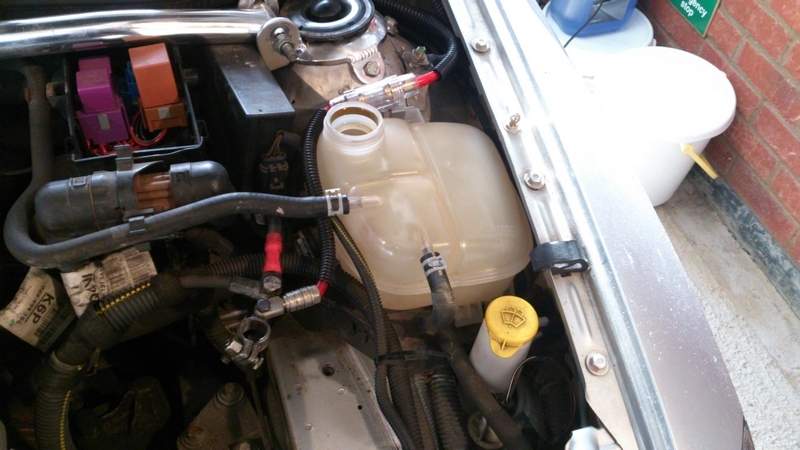

Coolant Header Tank Change

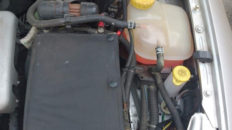

As the cruise control and headlight washer motor pump connectors where on the engine loom I assumed the coolant level sensor would be too, and here it is...
Coolant header tank fitted...
And refilled with coolant...
A massive thanks to @paul_bunce for pretty much doing all the work - cheers mate :).

(Note - the rad top pipe feed return to coolant header tank has been corrected :))

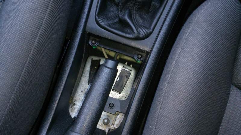

I finally got around to fitting a my Irmscher Black Carbon Gear Knob :). I wasn't keen on destroying the original so done some research - there wasn't much out there tbh! I'll guide you through how I done it, but first the original...
Remove the OBD port trim...
Notice the black gear lever retaining pin at the base of the lever...
Unclip the retaining pin from the lever shaft and pull rearwards to remove...
Pull lever out...

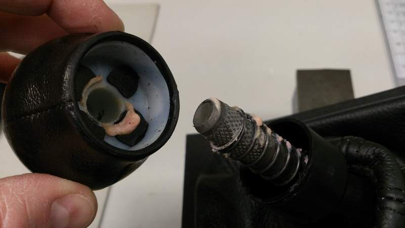

Secure the gear lever into a vice - it needs to be secure but not crushed!!!
Place open ended spanner (32mm) shaft side of gear knob. We need to leave the reverse lift plastic in place. Strike firmly with nylon headed hammer. Please be careful as there is plenty of opportunity to damage or break something here...
The gear knob will detach...
Splined friction fit of the original gear knob...

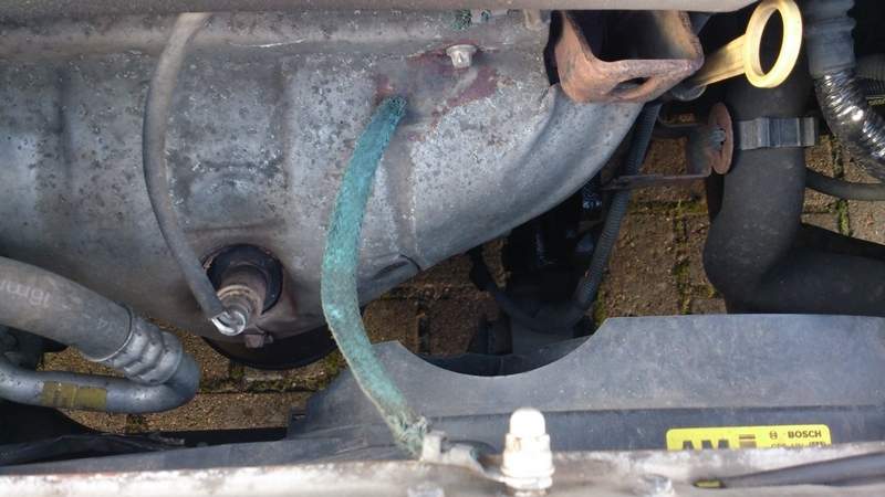

Whilst working on the car last weekend it was clear the engine earth cable needed replacing...
Engine earth cable comparison...
And fitment...

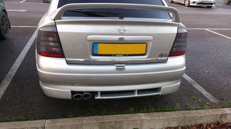

ProDrive SRi-T Rear Splitter & Parking Sensors

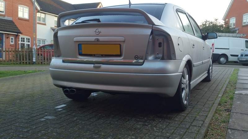

At long, long last I finally got around to fitting the ProDrive SRi-T Rear Spitter I bought from Turbo Chris a good while back. I also changed the rear bumper as mine had slight damage, and whilst I was at it I thought I may aswell fit parking sensors (although they won't be wired up until the weekend).
The first job was to colour code the parking sensors to Star Silver 3 (Z157).
Before...
After...
The car needed a clean first...
All the bumper fixings were removed, well all but the last. I was thwarted by a rounded torx screw (pic taken two days later when I resumed...).
It was then I noticed the black clouds looming so put all the screws back and saved it for two days later...
The problem with the rounded screw was solved by a dremel and making a slot ;)...
Rear lights removed for access...
And bumper off...
You can just make out the line with M250 and M500 arrowed. Whether these are parking sensor marks or not, I used them...
Prefect...
The middle two sensors (2 & 3) needed the foam block hollowing to allow their fitment.
Bumper with parking sensors fitted and rear lights refitted. Next was the long part of the ProDrive SRi-T Rear Splitter (and the stage I ran out of time, unfortunately)...
A new day and an overwhelming urge to complete the job...
The exhaust is slightly skewed, which I plan to investigate soon. I think it's the flange alignment so may not be an easy fix...

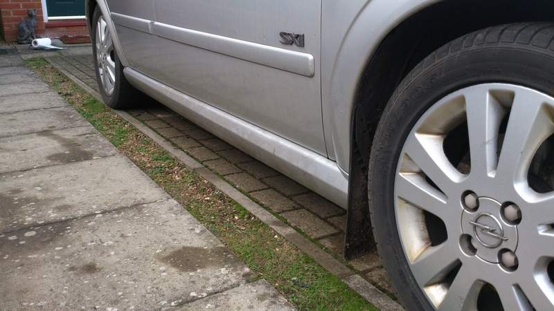

ProDrive Side skirts
I picked up a pair of ProDrive side skirts Star Silver 3 (Z157) from david1.8sxi about three or four weeks ago for the mere sum of £30 plus my standard ones (thanks David :)). These should suit the ProDrive SRi-T rear splitter perfectly. I currently have Star Silver 3 standard skirts fitted (it looks like they've been painted but no complaints). Here's the before...
And here's the after...
Because the ProDrive side skirts are from a 3 door I had to use the 5 door seals and I used trim tape to hold the seals in the absence of the trim fitting point...
I'm very happy with this weeks progress :).
