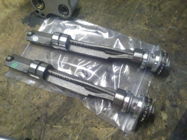

not sure about the hp but it do make it spin up quicker
i would guess its the same as fitting a lightened flywheel
but then you are removing weight so the engine will make more power from not having to spin them
they were only ever fitted to engines to make them run/idle smoother they run at 2 times the speed of the engine 6000rpm = 12000rpm balancer shafts
the dmf is stupid amount of weight to fit on the end of a crank and often cause more problems then good
early x20xev's didn't have balancer shafts but the later ones did and a fancy inlet manifold to get the same power through the rev range as the early engines.
x20xer also didn't have the balancer's which helped them rev out and gain more bhp.

What are peoples experience with the balance delete? Mine runs like a bag of spanners now and the vibration is not something i'll be living with so i'll be pulling the engine again to put them back in.
