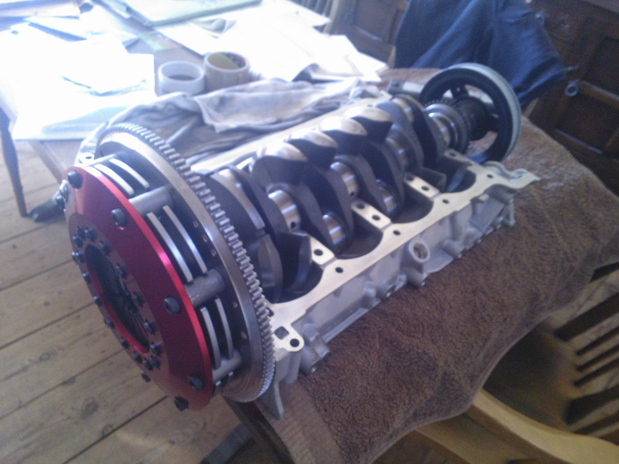

full rotating assembly zero balanced and knife edged crank
done at Andrews Precision i'm not far from worcester so went up and saw him hes a sound bloke and the prices are right well there better than right there brilliant :)
i took him the forged rods and pistons and watched him do the work he weight matched the pistons in 5mins and then balanced the rods end to end in 10mins great to watch he liked my clutch a lot to :)
