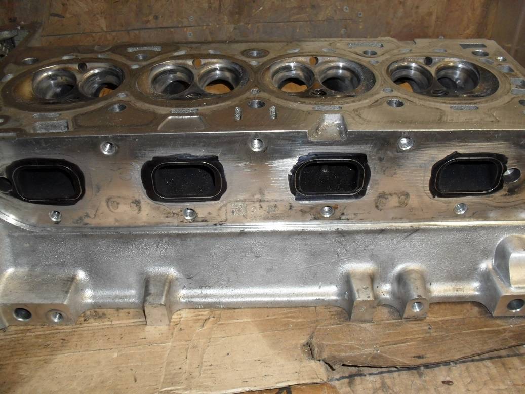

it's been a while but I have made a start on porting the A20NFT cylinder head and inlet manifold
inlet manifold done :)
I have seen a few threads about porting the LNF head and it seems to be a bit 'hit and miss' with opening up the inlet ports
So I made a start on the inlets, if it works great, if not I will stick the original head back on :LOL:

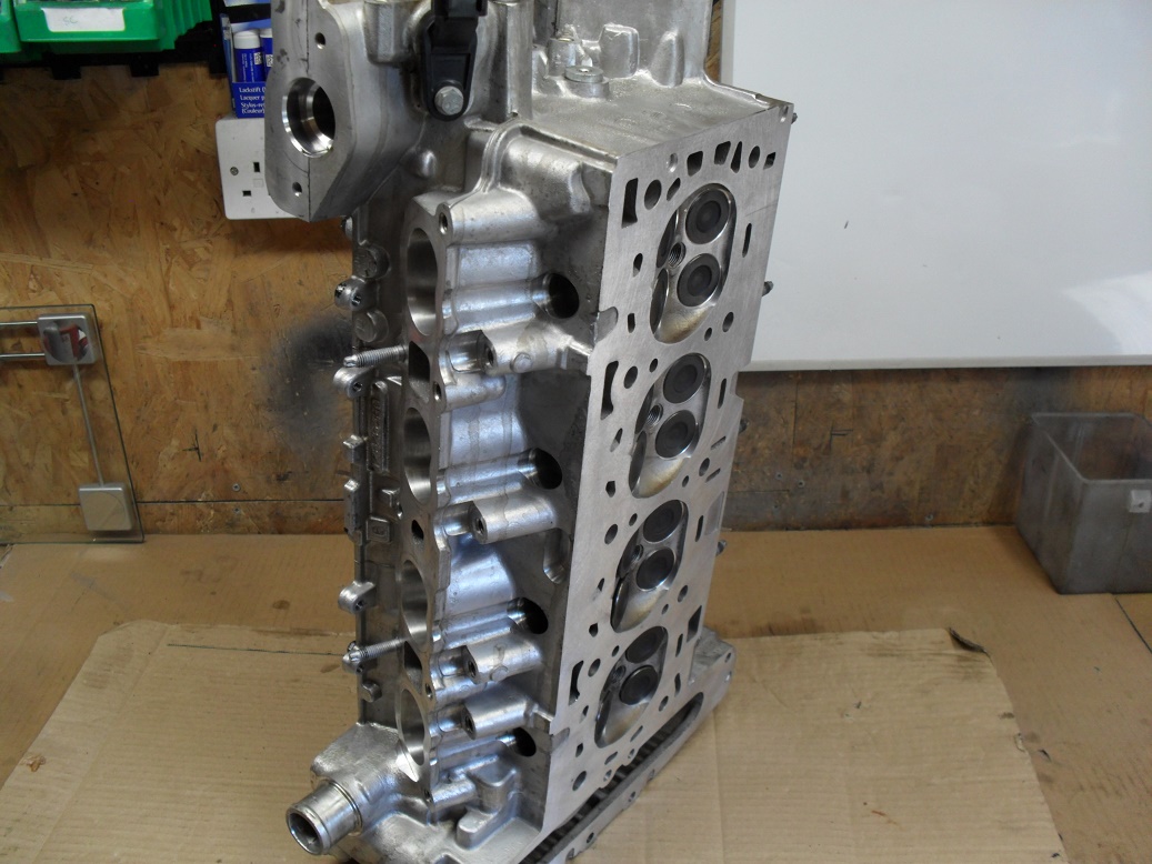

so three years later the cylinder head is finally finished :LOL:
head had a light skim to clean it up, they also did 3 angle valve seats and lapped in the valves
brand new OEM valve stem oil seals fitted
and complete

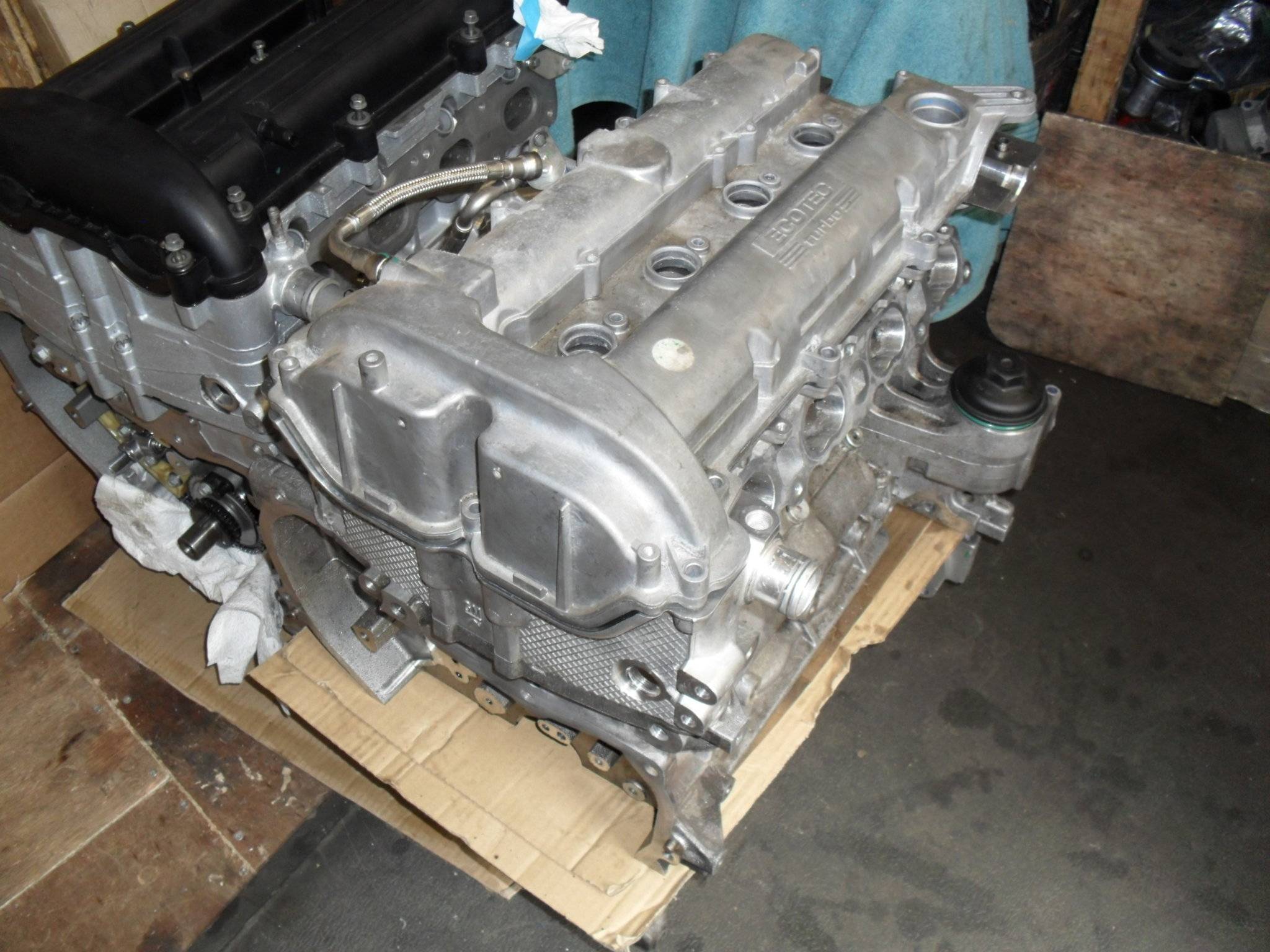

This will now be fitted to my vxr, got to purchase a few goodies before it can be fitted, like pistons and rods :D

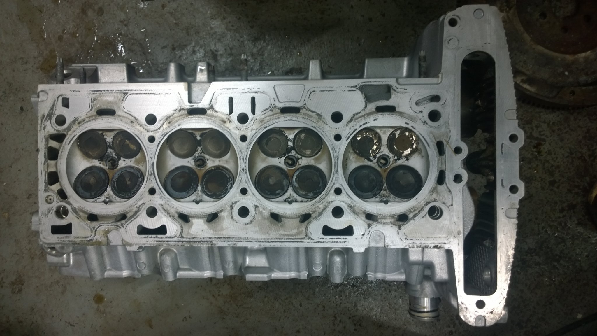

im saving up for bigger valves and bronze guides will be aiming for 450bhp with an efr and 4x4 :) got a head from a astra vxr but it needed some cleaning :confused: and it got 2 bent valves in #1
