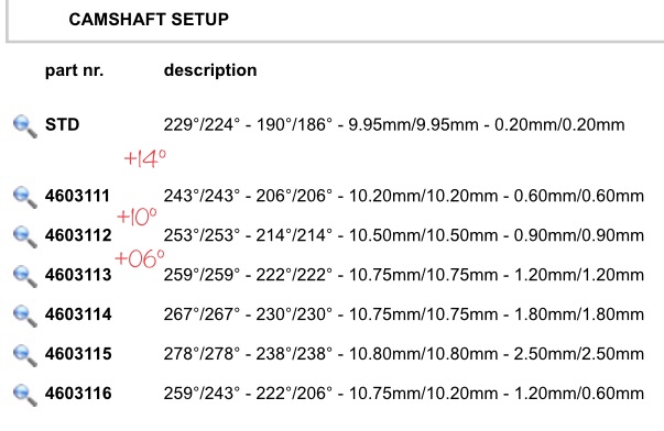

At the rollers and up and running the WOT runs were done and few issues arouse in that the intake tubing was strangling it, car ran 1psi more boost without it so will re design a new airbox set up and the car needs aftermarket cams as it made no more power after 6800rpm so new limit of 7800rpm isn’t needed yet.
