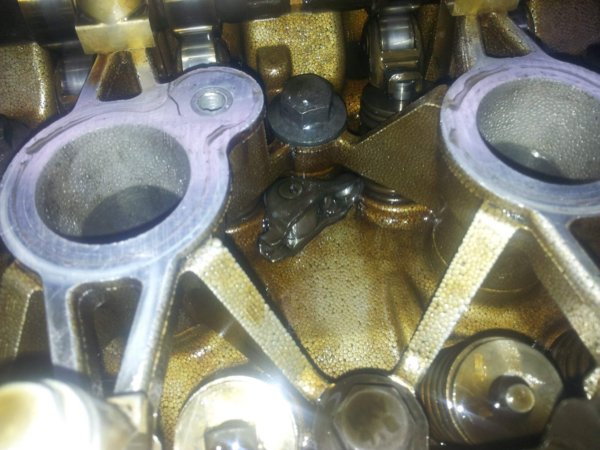

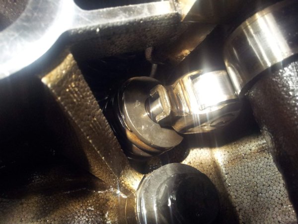

I have just done my first 100 miles took rocker cover off cause i had not used any silicone round gasket and it was leaking a little last night ,so when i removed cover just now to do the work i discovered this was wondering what the cause is @evocarlos .
It did not seem to cause any problems while driving but i think i was lucky to discover this before any serious damage occurred .
Would it be possible to put this back by loosening carrier cap bolts a little to allow it to slip back into place maybe it was not seated properly ,wondering how else this happened

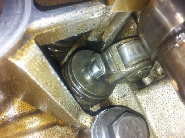

Managed to get it in again hopefully it's sorted, just the tip of the valve sits a bit further under on the other tappets, hoping it moves into position a little better fingers crossed, see if you can spot the difference
Best i could get it with the cam still on
normally a bent valve but you have just done them
you can but it should not be able to remove it after if you can remove it with the cam lobe facing up then theres an issue
there should be less than a 1mm gap between the roller rocker and the cam when fitted
