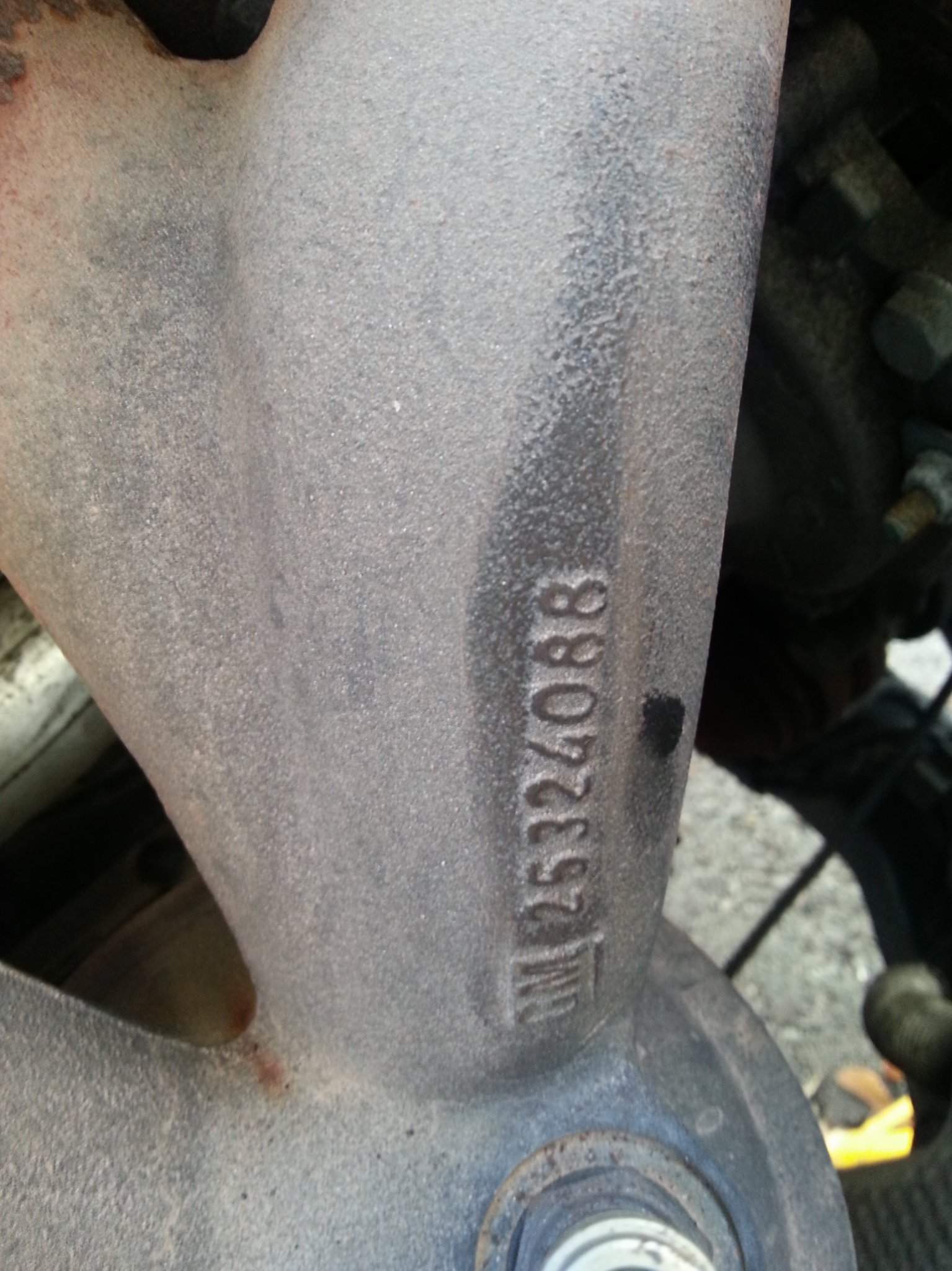

I have a standard z22se cat lying around from when I took it off mine, so if you do go Astra manifold and adaptor pipe that could be welded in to keep it mot friendly. Only want scrap value for it
cheers, i will keep that in mind, im not even 100% sure what the crack is yet, i will get the heat shield off in the morning hopefully.

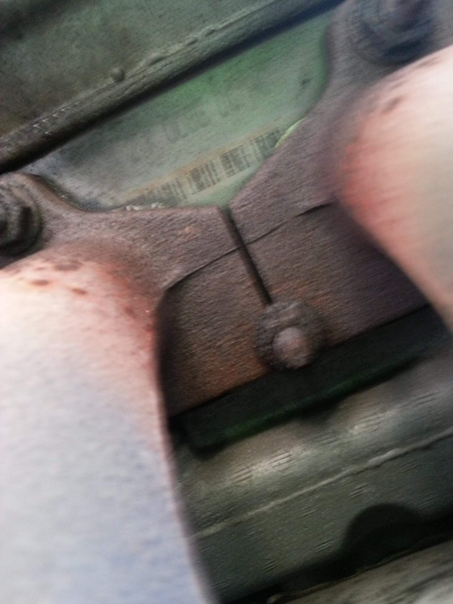

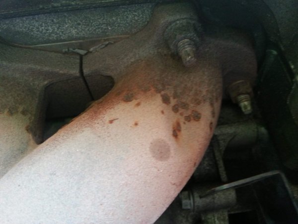

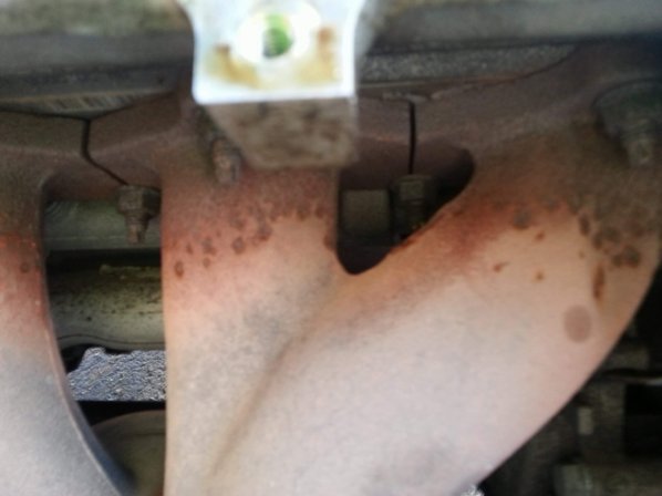

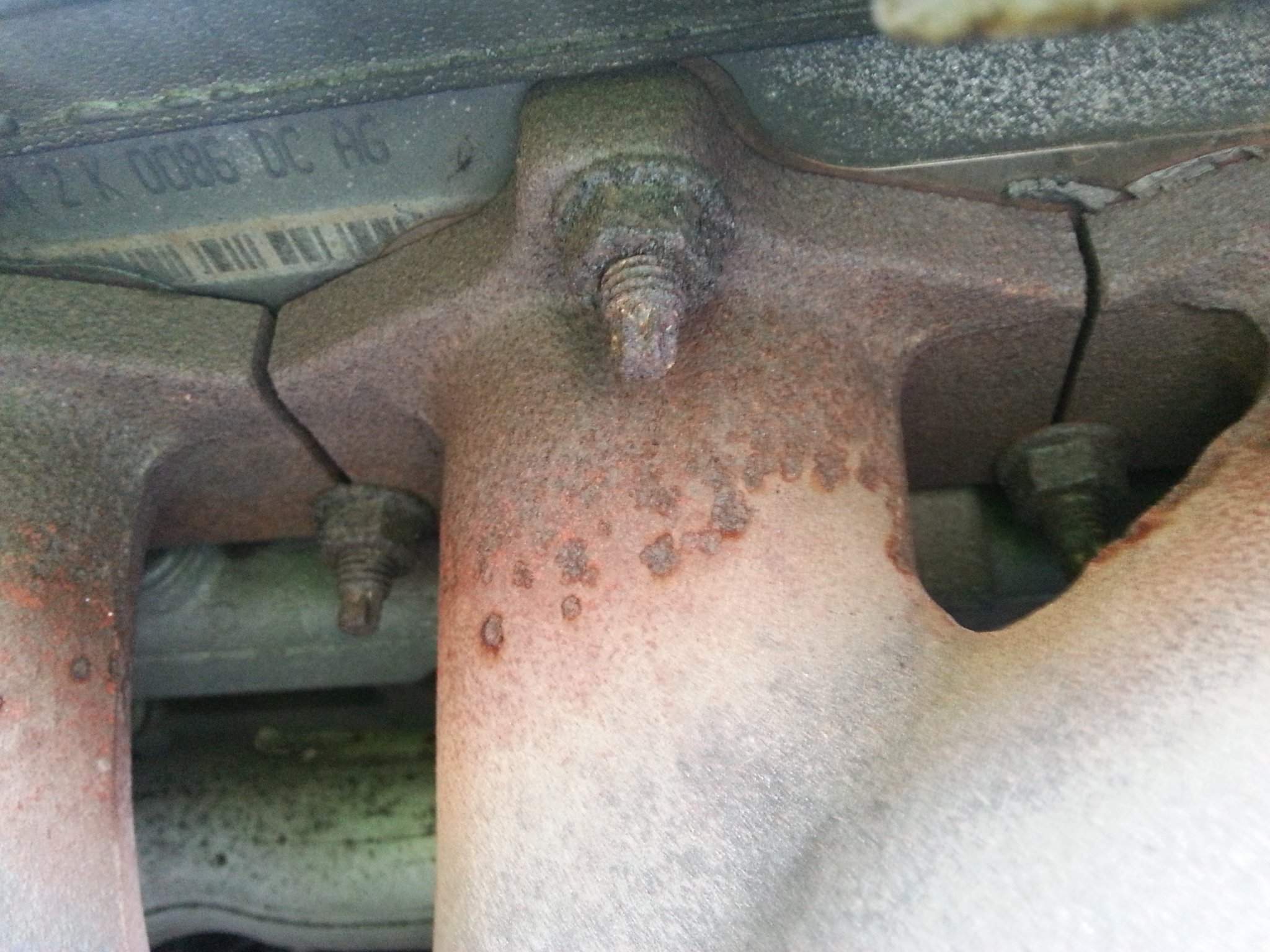

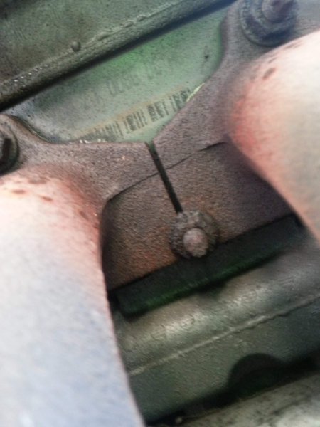

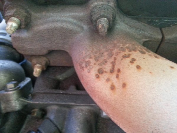

I think the weak point is where all the collectors meet on top
Like this
ai1282.photobucket.com_albums_a524_Chill909_VX_20220_20Project21c27553b0561fcf37dc026bf892342b.jpg
Is it cold ?
If so the crack will be more obvious
When it is cold start up and see if you can here clicking,
If not looks like it's not manifold
No nothing like that. My cats right there so looks different and probably there fix for it.
Looks like im going inside. When the weather lets me.

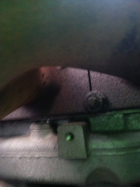

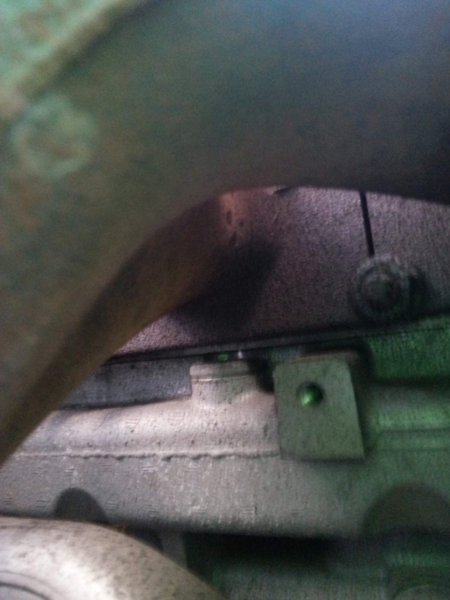

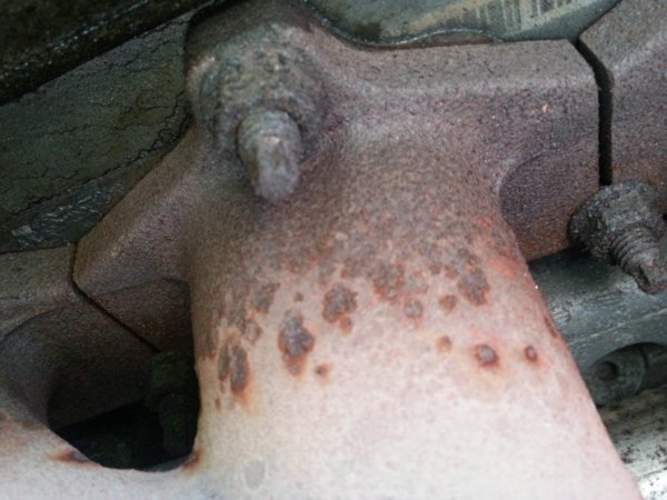

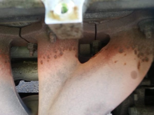

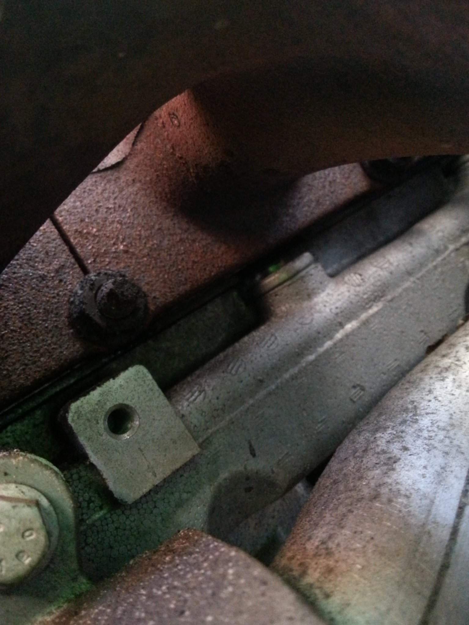

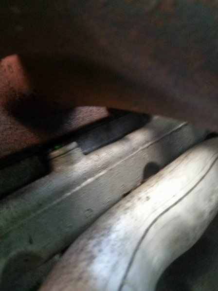

only one thing i spotted from your pics
the stud at the chain end of the manifold is new its shiny the rest are rusty
i think you need to remove the cover and see whats going on
