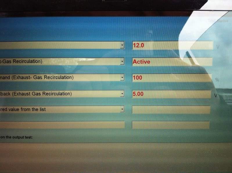

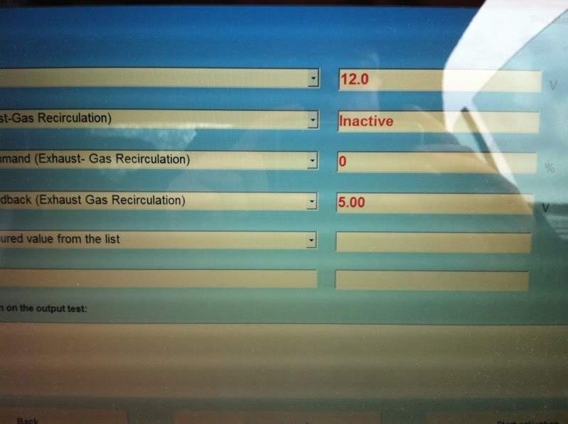

here is a couple of pics from opcom,i did a test activation
and

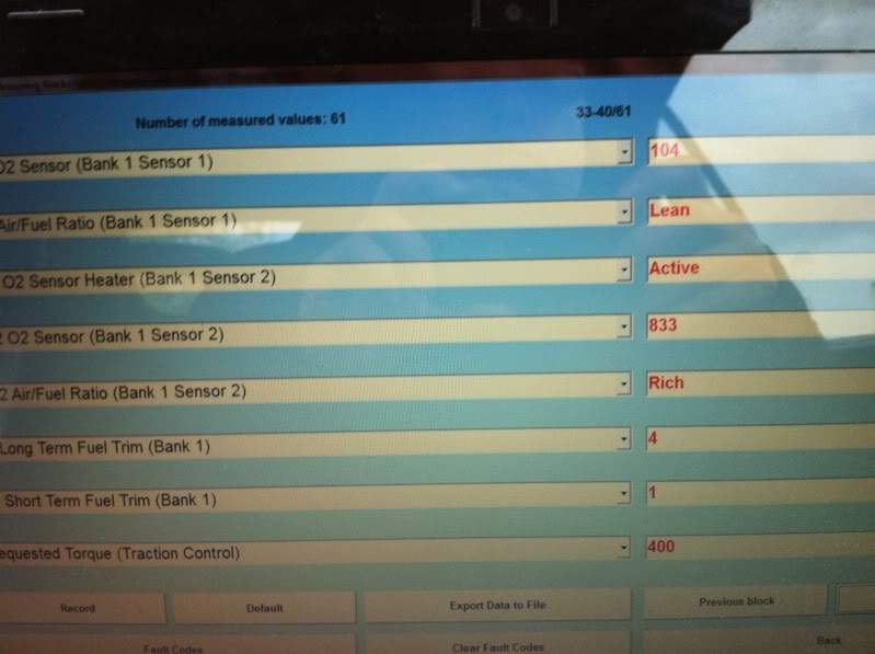

but another problem im getting is a rich reading on the second co sensor,i do not have any error codes saying there is something wrong
any help would be appreciated

on OP-COM the reading should be 1.47v +- 0.02v with cheater.
without cheater iirc my egr was about 0.97v - egr was starting to play up a little bit

voltage is 5v when the valve is open and 1v when closed
without actualy seeing the valve with the car being driven i can say the valve is shut,i have cleaned it up and made sure it was moving freely,one thing i did find out was when i activated the egr valve with the engine running the engine note changed and made it run rough,despite the egr valve not being plumbed in
astra22bertoneauto
Re: egr/cheater problem
solorider said:
When you run the test on OP-COM for the EGR valve it should completely stall the engine (with EGR plugged in). i would say its reasonable to assume without egr plugged in it would make the engine sound rough as you are telling the ecu to stall the engine.
