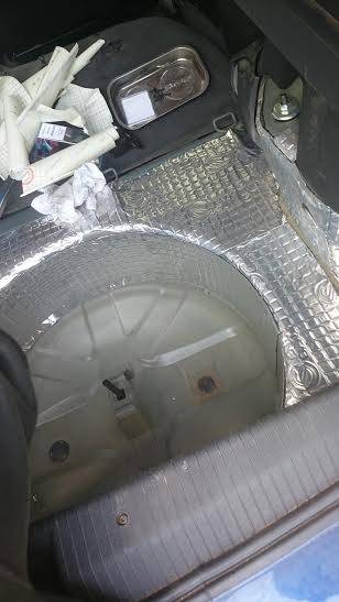

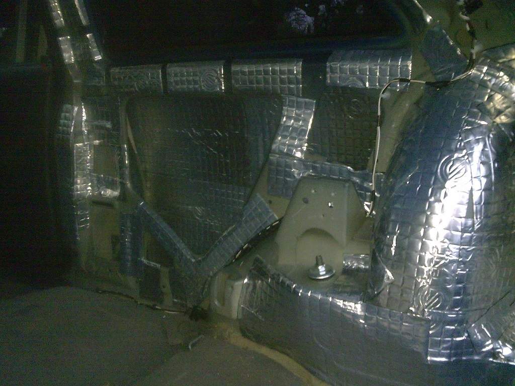

not done to much since the last update but started sound proofing, done roof and rear quarters, only used 80 sheets. 3 layers.
got rear trim and roof lining back in as well
fitted a 2.5" piper cat back instead of the 2" and she's much quieter now :confused:

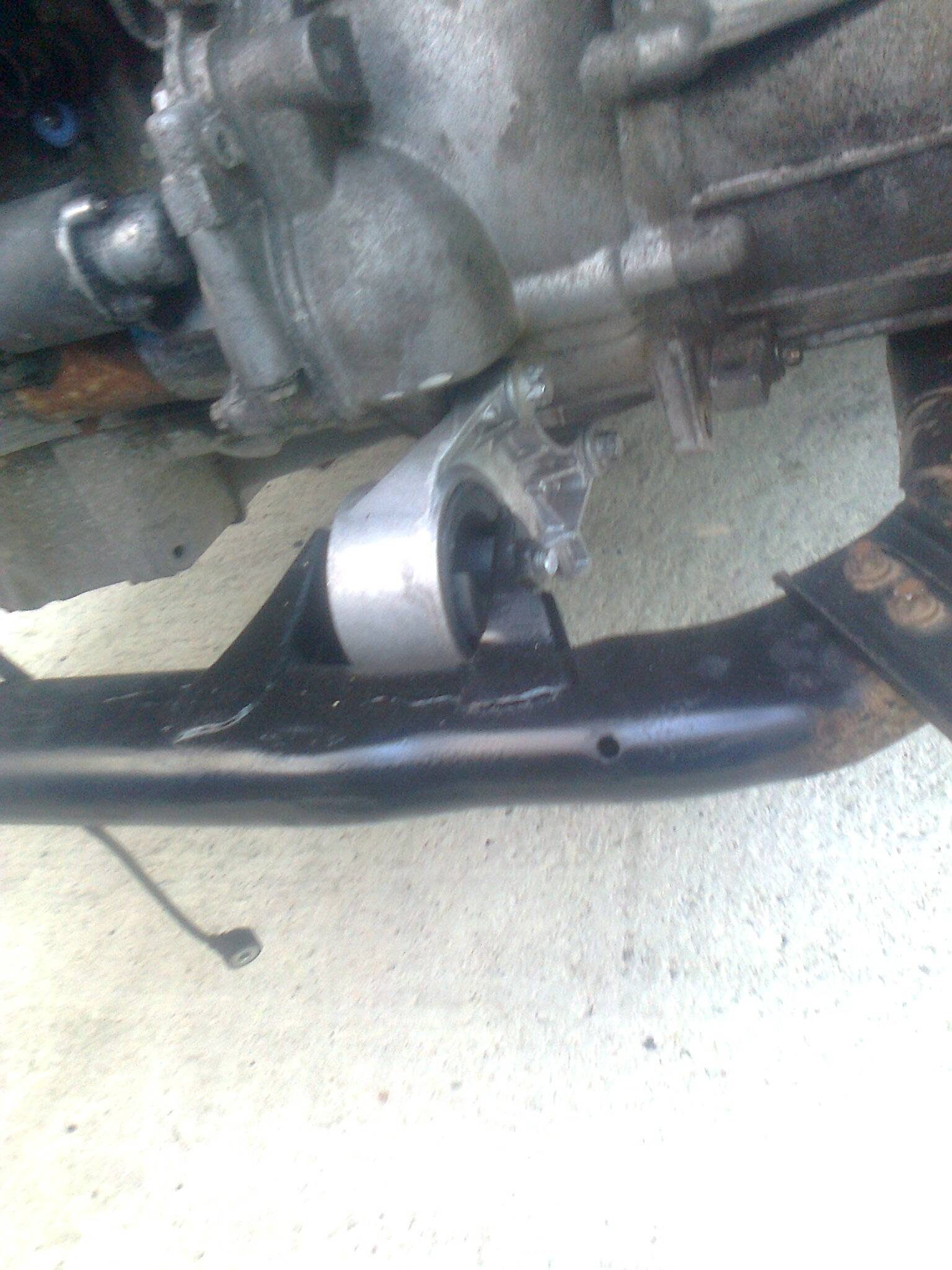

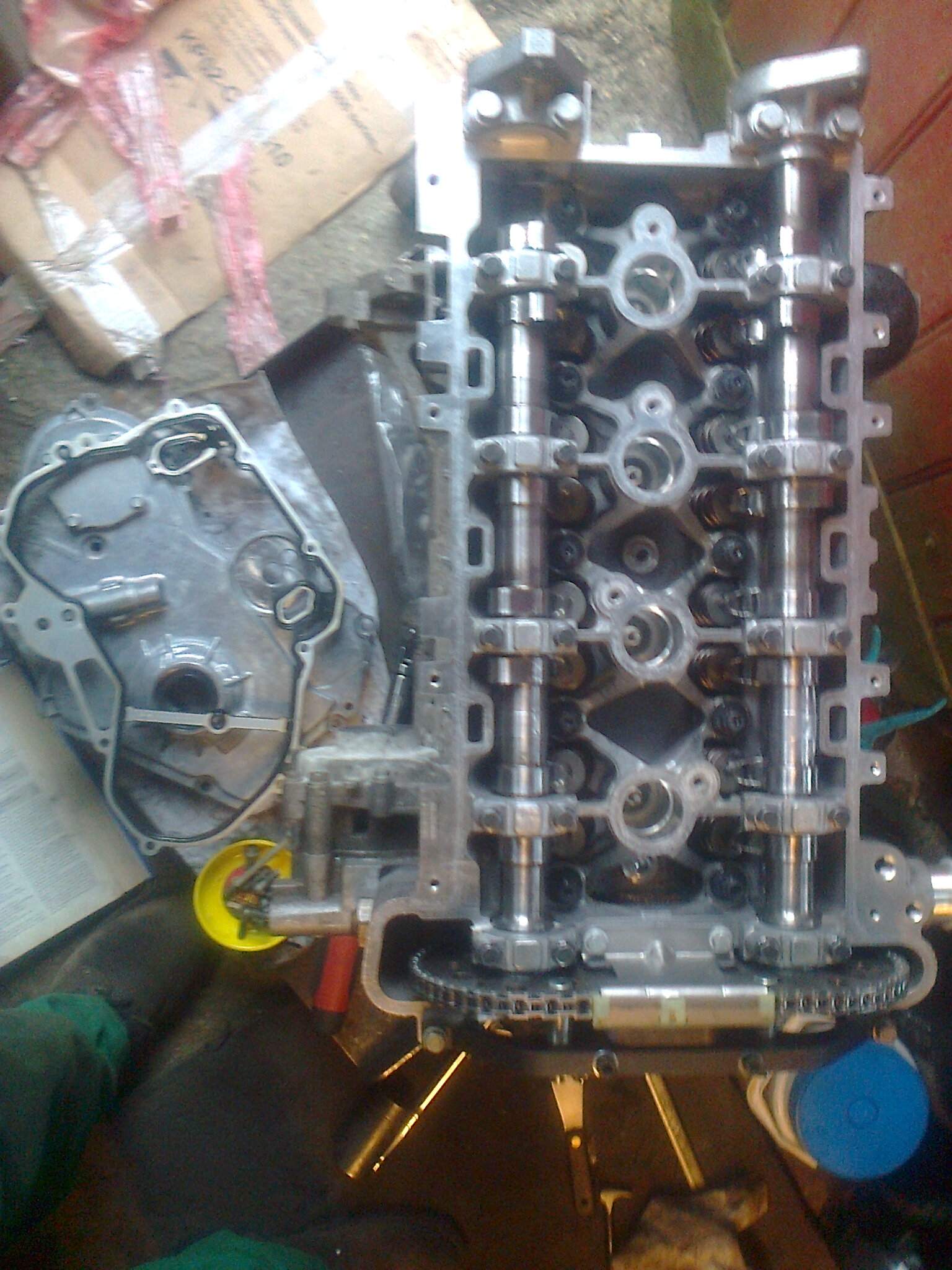

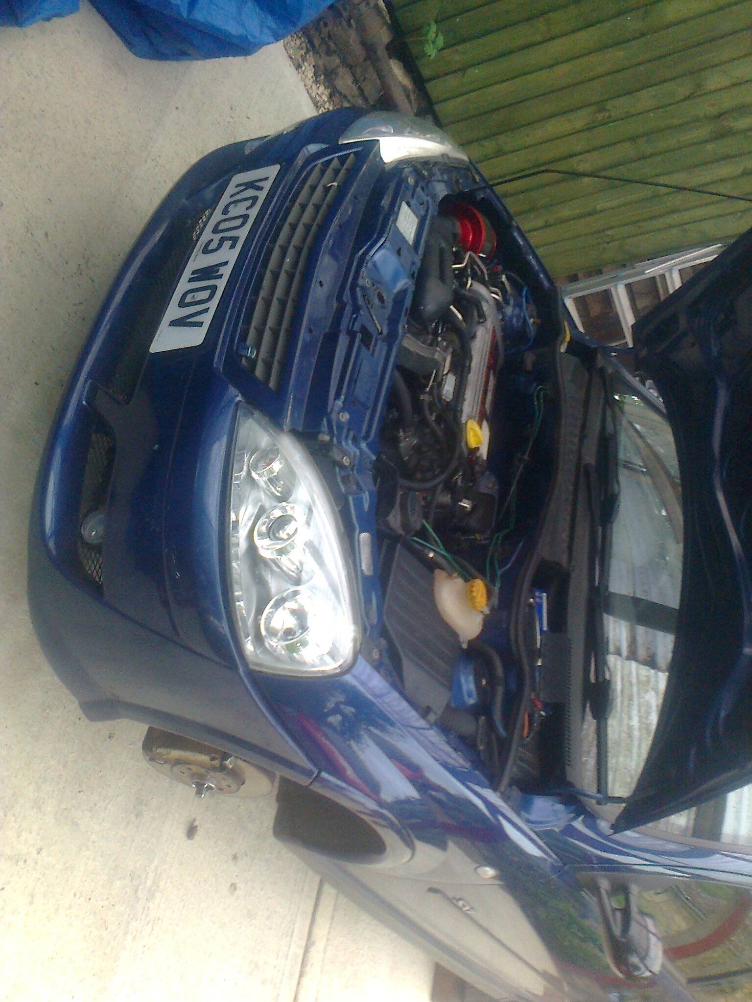

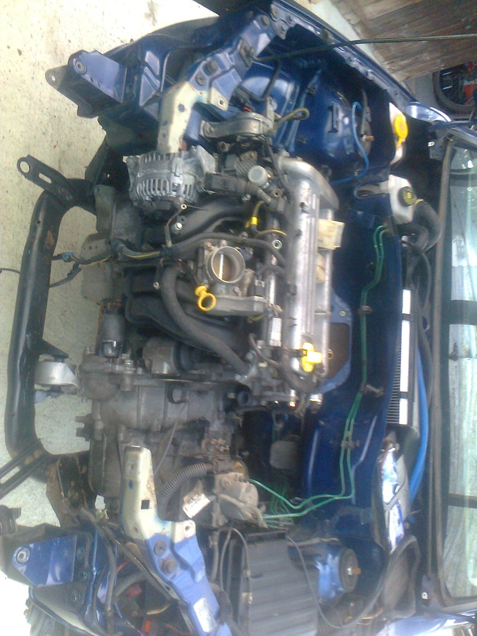

time for an update, z22se engine is now fitted, finished sound proofing the floor, test drive went great.
had a bit of trouble with the clutch, engine came out twice to sort it.
vectra C has a deeper bell housing inside than the earlier z22se cars and the slave cylinder didnt reach the clutch. lucky i had a spare astra g f23 box. wrong ratio's but will do for now until i find another z22se f23 gear box to break for parts.

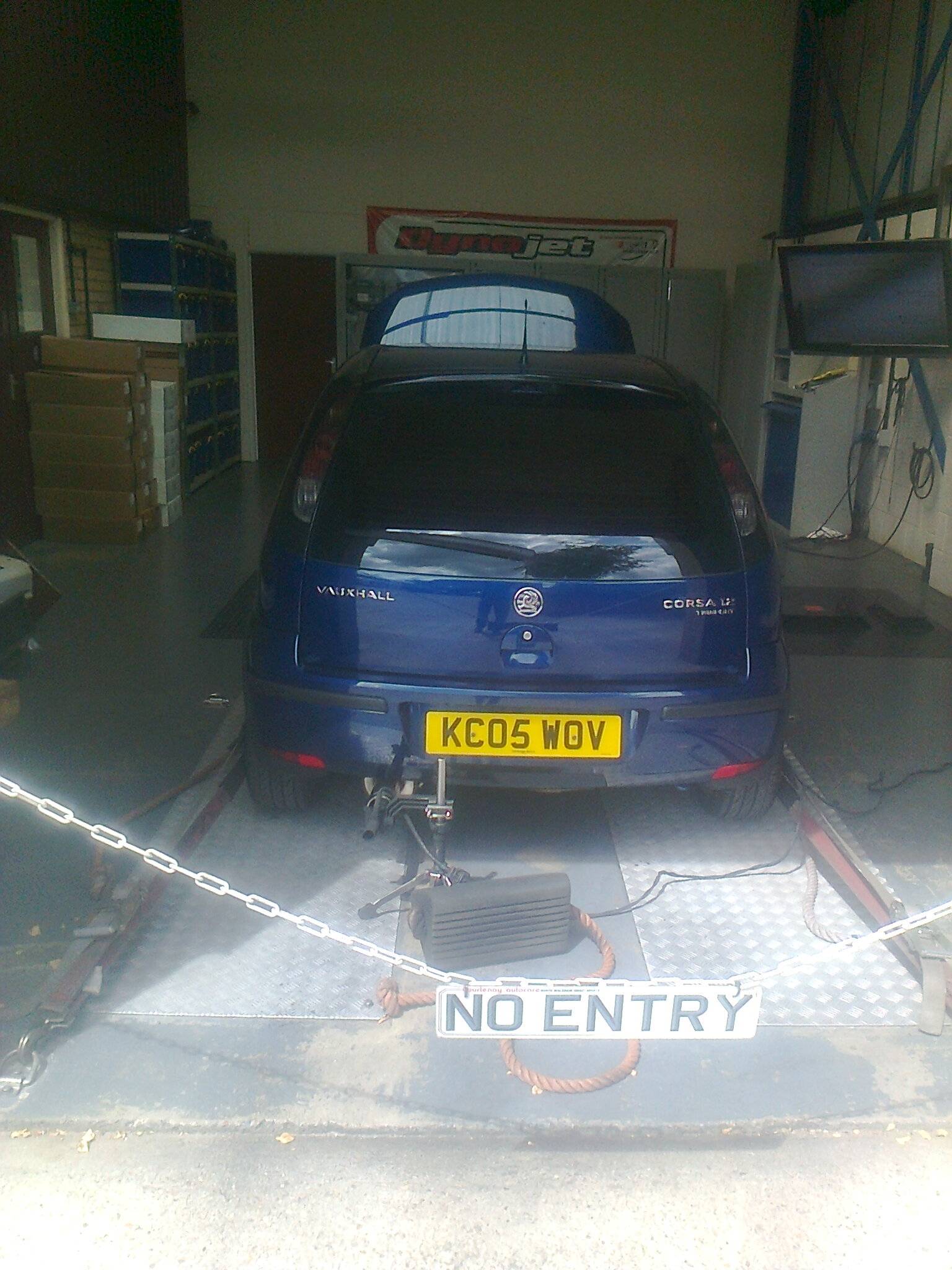

mapping is booked for 25th july up at courtenay sport.
may fit the quaife diff before then if clutch turns up in time?

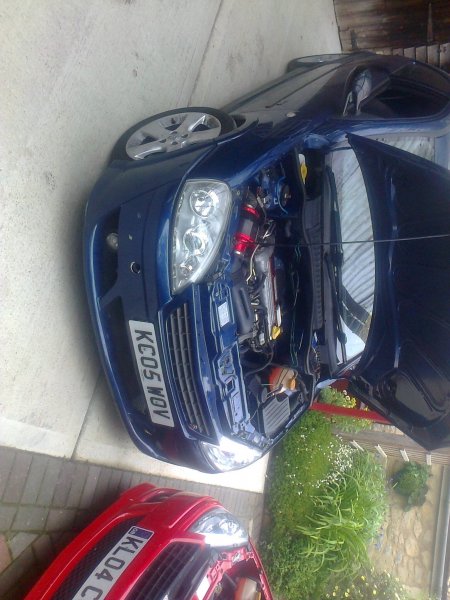

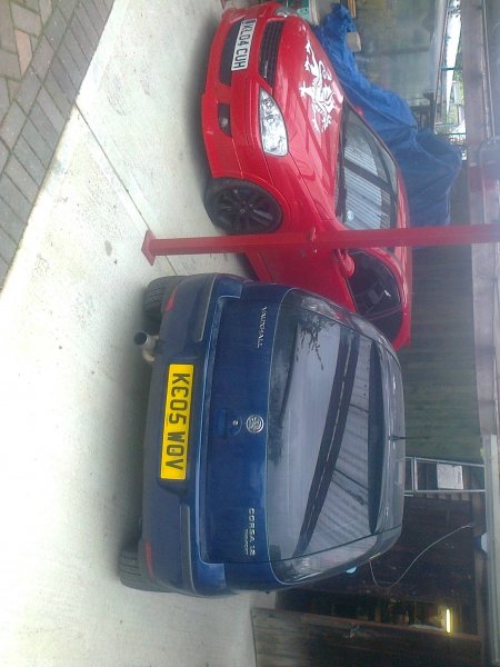

Yi went down to see Betty but the bonnet was closed n nobody about (weather)
Gutted I didn't get to see the engine bay.
Nice to have a quick chat though mate.
corsaZ22se
have to give young Craig a telling off! :LOL:
he may have been sat in the tent out of the rain?
she will be at vboa if i can get a driver?
was good to chat, never found your car, kept getting caught by people and PV mag :)
