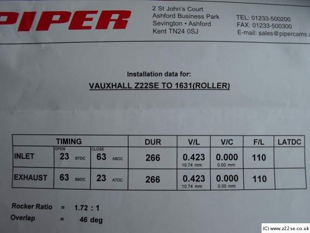

So, I need some cams come early January but which ones to go for? I was kinda set on the piper cams as I have a spare set to send away, especially after the results that zaffman had on the RR day and Vockys recomendations. But heres the confusion, I downloaded the piper products cataloge and it only specifies 260 degree fast road cams for the vx220 / astra 2.2. I'm sure I read that you had 270 degree cams zafman, vocky? could you or anyone else confirm what exactly I should be getting, do they make 270 degree cams on special request, or have I got it wrong and your all running the 260 degree ones?

the term '270' is a brand name
they are infact 266 degree, remember the standard are 244 !
