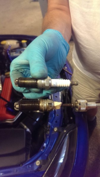

Went to change my plugs today and found one cracked and one broken into pieces and can't get it out, it runs but it misfires under 1500rpm...
Going to mates garage tomorrow to see if they can do it... If not its the spare head off to get ported and stuff then fit that.

That's not good at all :(

Plugs removed with no damaged so it's all good.

I didn't..
I took the coil pack off and that one was like so and another actually came apart when I took it out the plug socket..Garage reckons it must of been a couple of dodgy plugs..They have seen it before... they were NGK's
pop and bang map ?
the shatter if the plug socket is moved over to one side when they're old thats the only time ive seen them go
