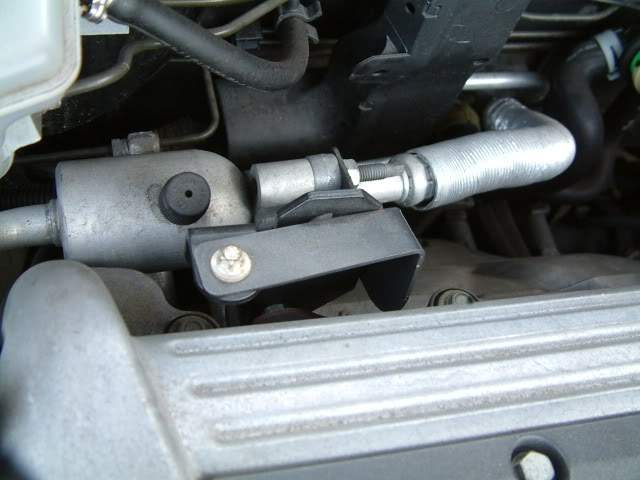

Andy
the pipe snaps at the far left corner of the engine unless the bracket has been fitted as pictured

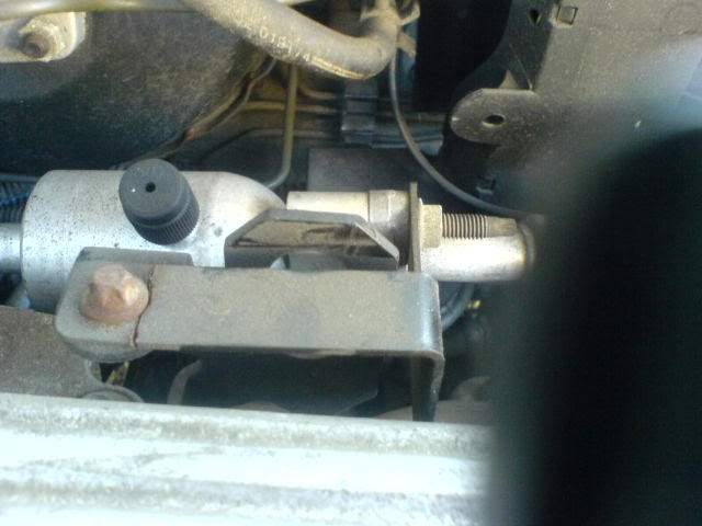

56k_warning said:
I take it im looking @ the correct bracket :?
Whilst having a poke around under the bonnet today (engine woes) I noticed my bracket is also cracked exactly the same as this!
I am really starting to wonder!
