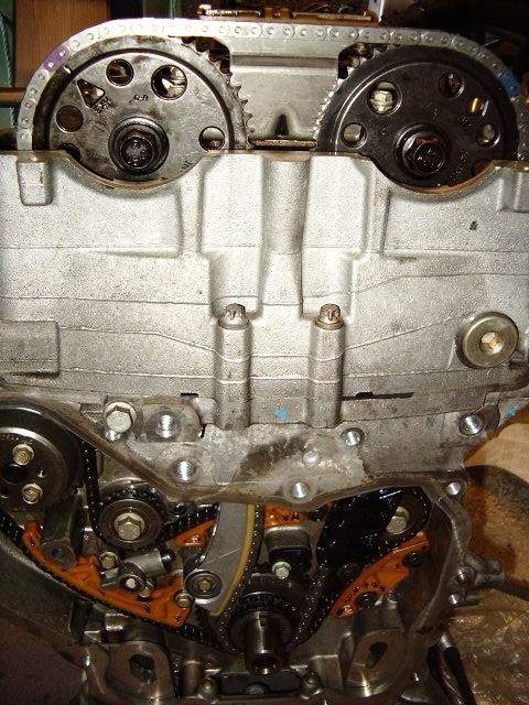

a few pics of the timing marks
balancer chain
note: the balancer chain timing marks have moved due to turning the engine over a couple of times before fitting the cam chain
