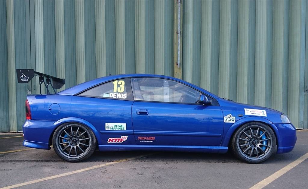

Removed all the gravel and gave it a wash
ai693.photobucket.com_albums_vv292_dewismotorsport_IMG_20170321_170156_255_zpsvawcqlvn.jpg

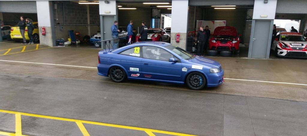

Few pics my friend took on the day, the coupe is just a timeless shape imo

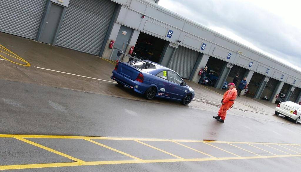

Few more pictures from the race

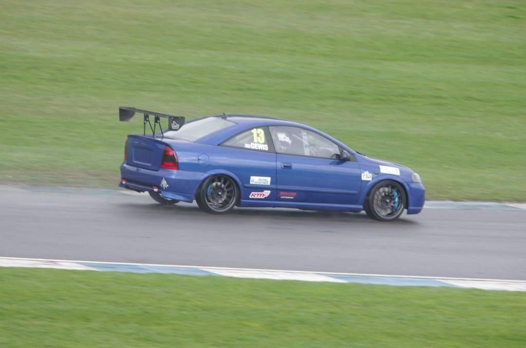

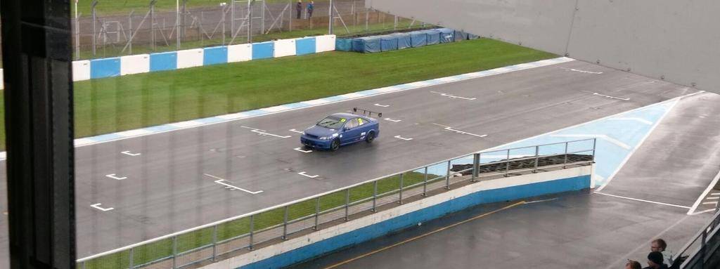

Last few of race day (I promise) and a video (off my laptop screen as my WiFi is still down)
ai693.photobucket.com_albums_vv292_dewismotorsport_FB_IMG_1489966581888_zpshefk0waa.jpg

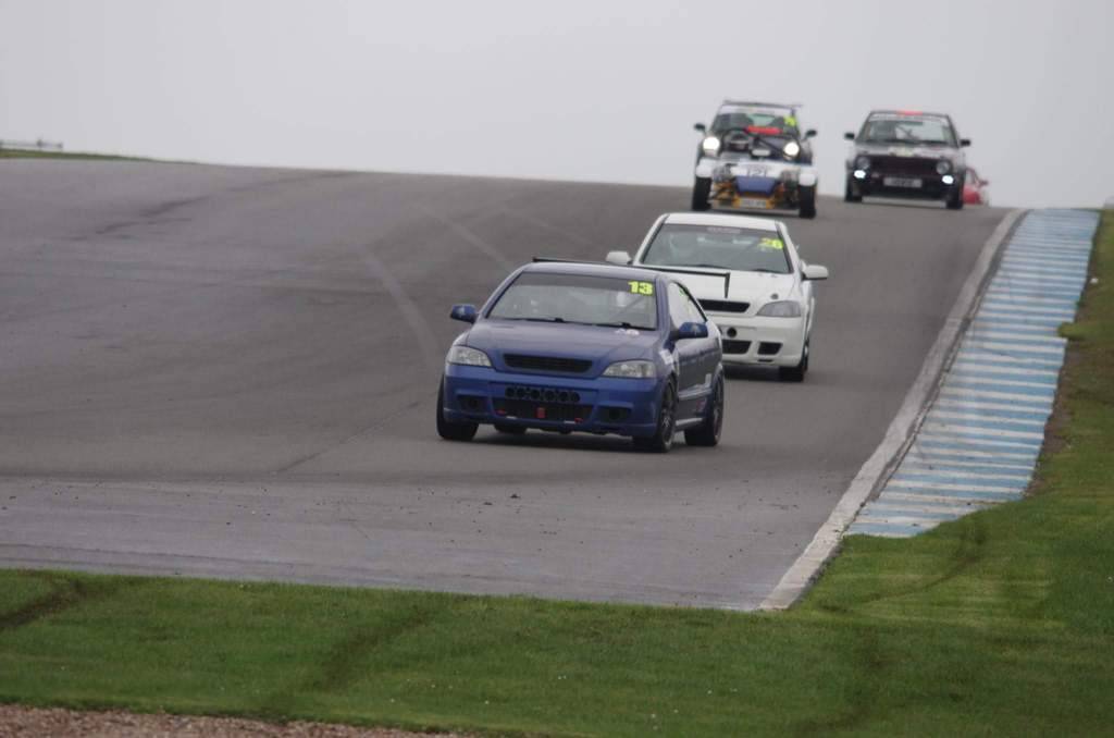

First time at Donington Park GP, just starting to get some heat into the old semi slicks on the cold damp track (dry only on racing line) and chasing down the Army drivers 480bhp AWD R32 Skyline GTR before the high pressure oil feed line to the oil cooler started leaking and eventually span me off into the gravel.

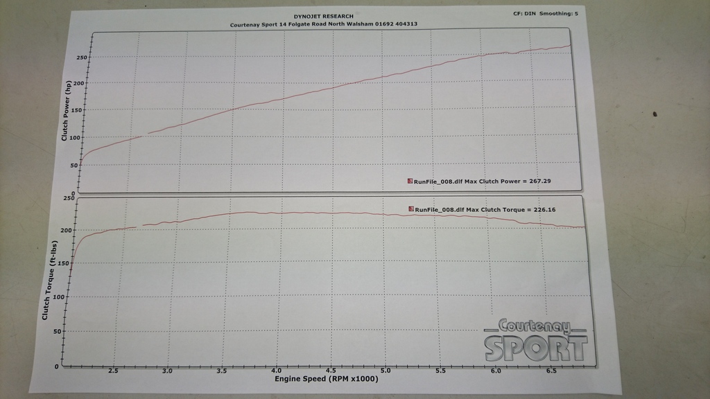

Loaded the car up and set off at 2315 and arrived for mapping at Courtenay sport at 0420 few hours sleep and up again to unload
So the car decided it didn't want to talk via the obd port, I knew it previously worked as that's how I found the immobiliser fault, after several hours Matt had tried everything he could and even bench tested the ecu. I then suggested cutting the immobiliser wire feed I'd added as that's the only thing to have changed and it worked first time.
We'd lost a lot of time so only did a handful of runs just to check the map was safe and luckily it was, the smaller pulley had leaned the map out nicely to 11.9 on the lambda. Turns out my oem wideband sensor must be knackered as was reading 10.0 at WOT so I'll order a new one.
Matt and Jon were really impressed with the intercooler setup having never seen one before and we're certain it would improve the intake temps which was good positive feedback. We did notice that some of the silicones suck in on idle due to the charger screws creating a vacuum and sacking against a closed throttle body but once revved the positive pressure blew them out fully again. Doesn't effect how it runs but will make some solid pipes up with just a few short joiners in future.
So results were 267bhp and 226 lbs ft of torque at the crank which is exactly what I wanted as that now gives me 230whp and 198bhp per ton so I have a little to play with on the weight side but right up to the 200whp per ton Class B limit.

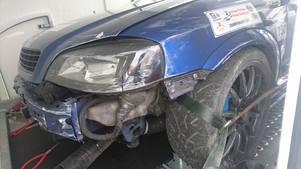

Into the race and after a awful start due to lots of wheel spin I dropped 4 places but fought back to re gain them. Struggling to get heat into the rear tyres I cut too much of copse corner curb at about 100mph sending me a bit sideways, I was expecting a bit more and put too much lock on and got a tank slapper on, pinning the throttle didn't pull me straight and next minute I'm heading backwards into the tyre wall.
ai693.photobucket.com_albums_vv292_dewismotorsport_IMG_20170429_WA0002_zpsqk85cksk.jpg
Cars a bit of a mess at the back but my bodyshop sponsor says it's sortable so it will go again
