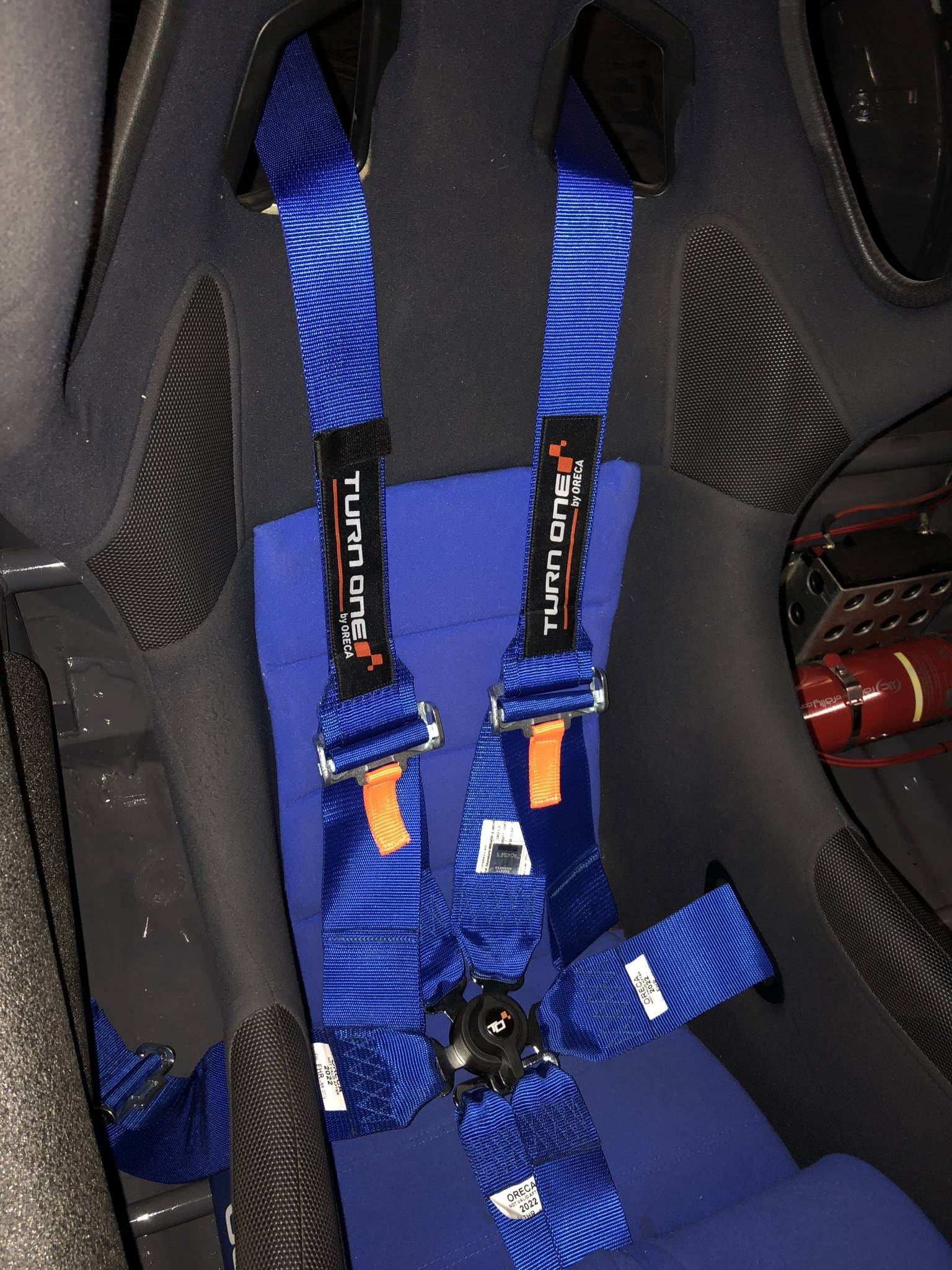

Last few jobs were to fit a new charger belt just as a service item, new fuel filter, trimmed final bits off the 888 kit for tyre clearance and bought a new harness, can’t fault the quality of the Oreca stuff for the money and it’s a 3” to 2” designed specifically for use with Han’s devices.
