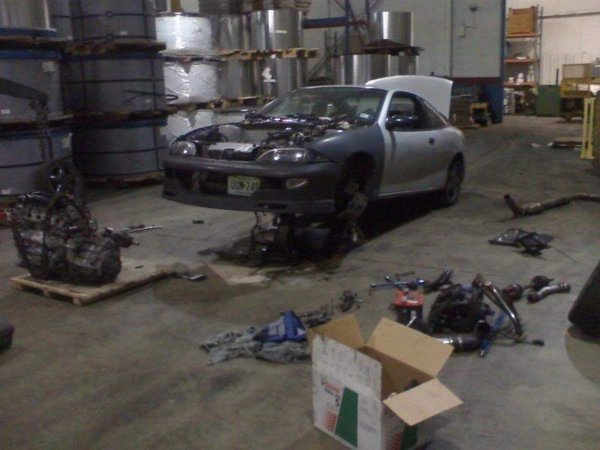

april 13 2008.. it begins.

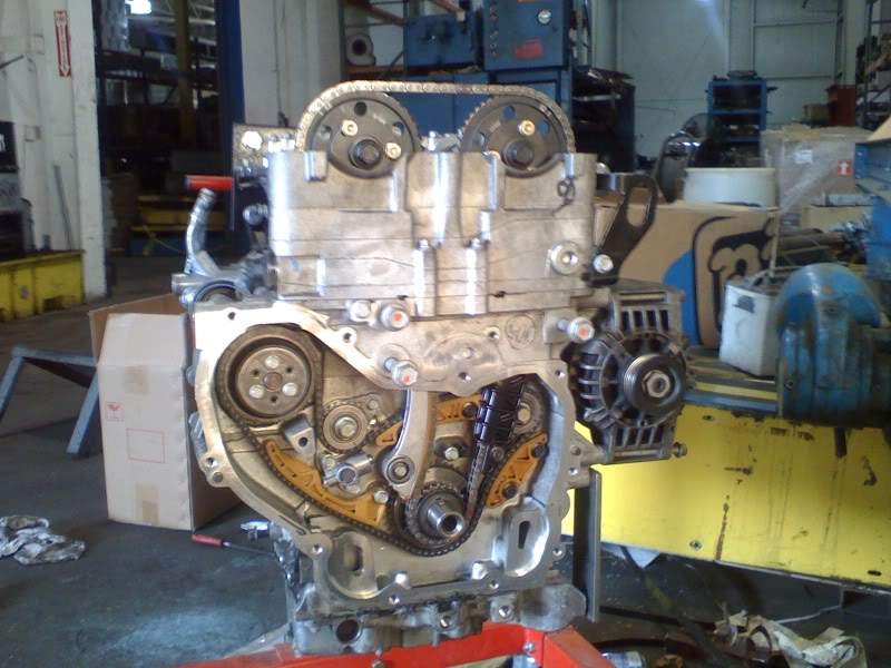

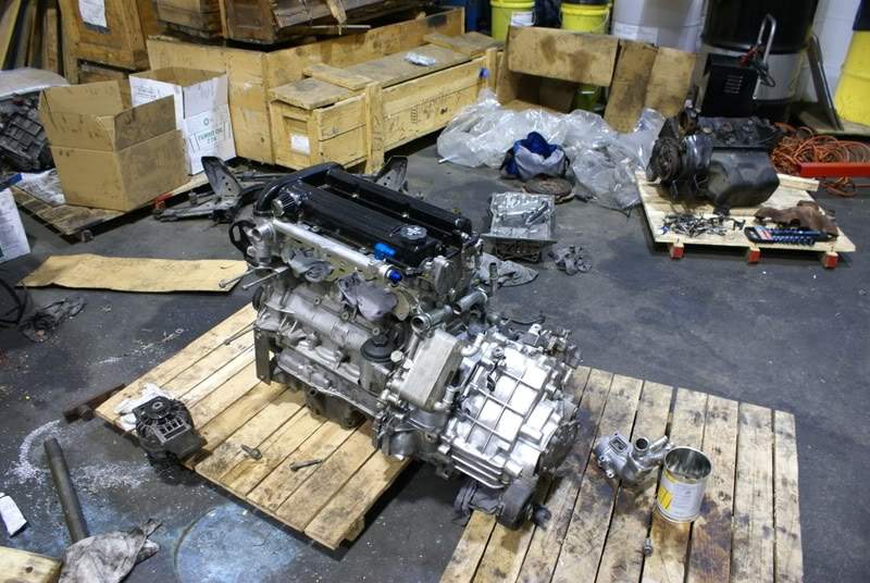

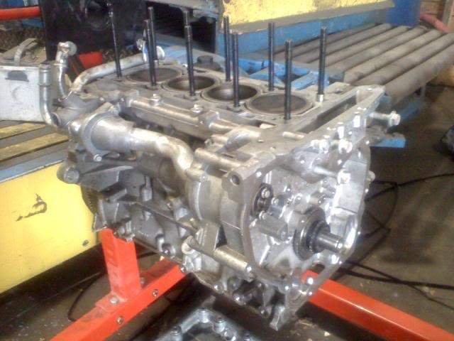

LSJ block with ARP headstuds, ready for assembly.
eliminated balance shafts, adjustable cam gears, 2.2 head

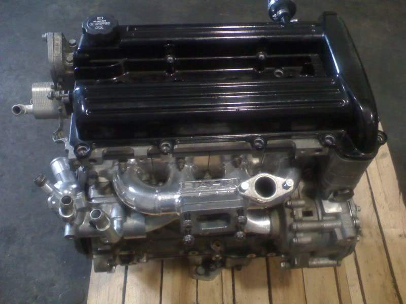

test fitting the turbo manifold. log style for now with external 38mm wastegate

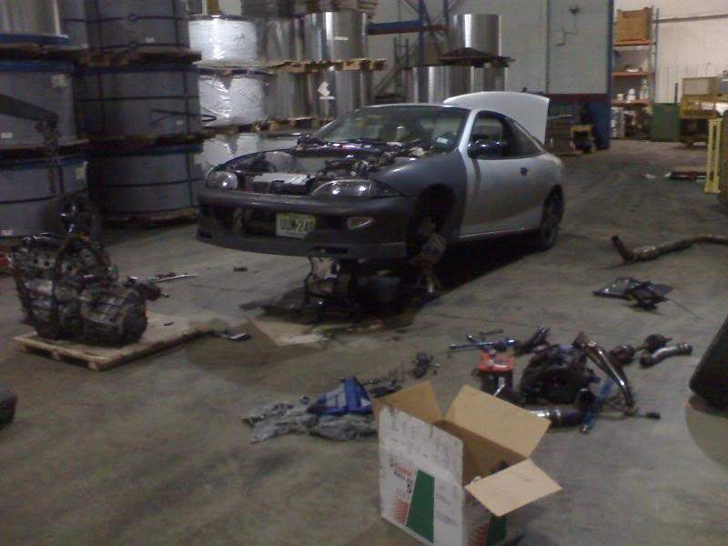

F23 transmission mated to the LSJ (2.0) block. oil cooler was a tight fit, and I had to work around it for the lower rad hose

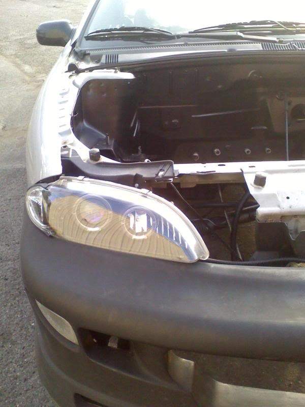

satin black paint under the hood
new look before hood pins
aerocatch hood pins installed

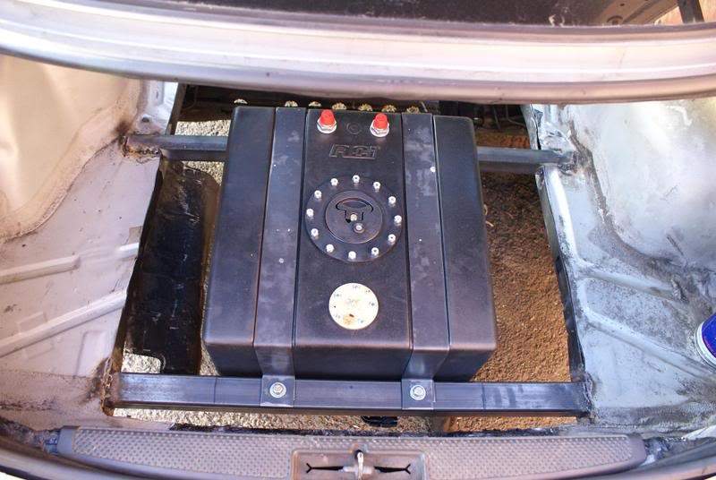

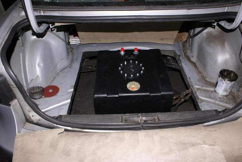

mocking up the fuel cell
fuel cell finished (ignore the crap welds.. its solid!)

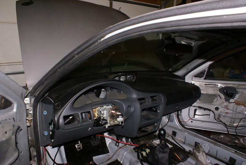

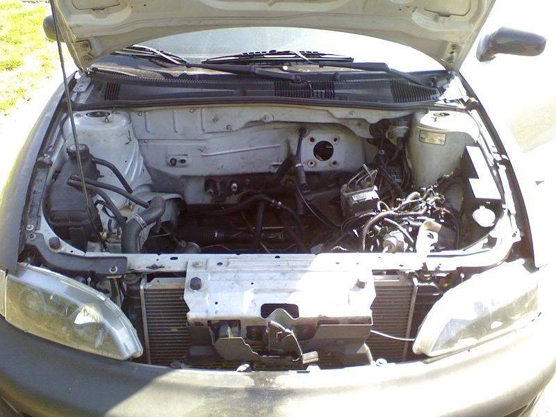

HVAC removed, insulation removed, dash cage painted and reinstalled

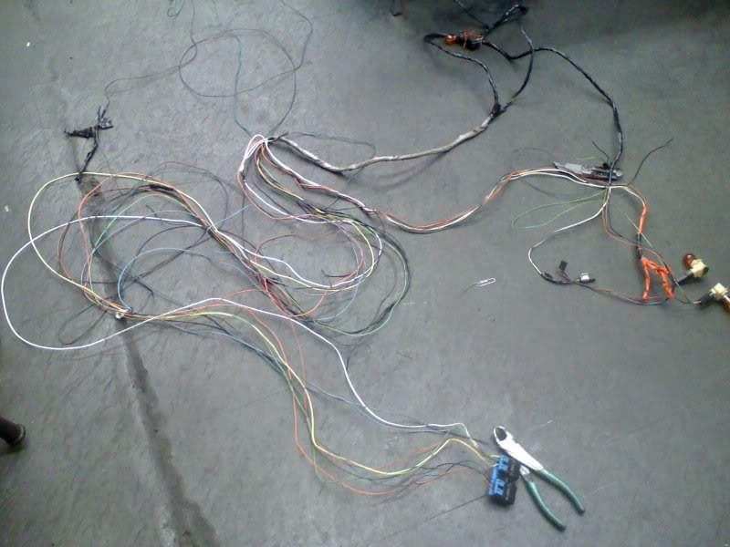

left over wiring..
what remains
fabricated HVAC blockoff plate

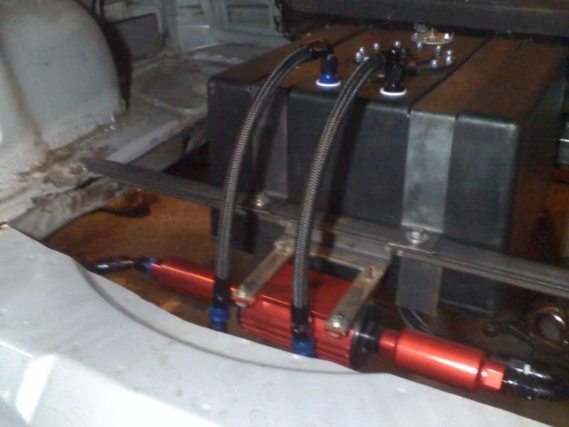

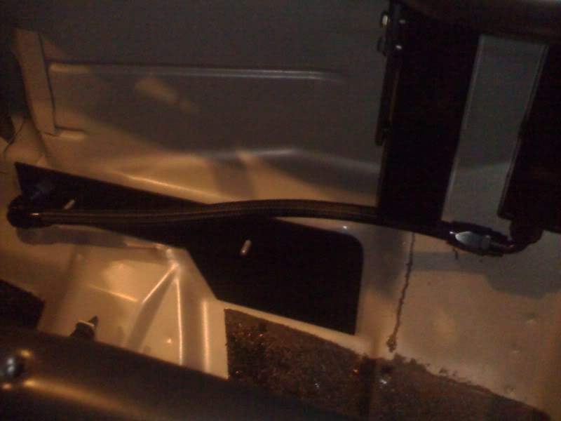

fuel cell, pump, return, vent lines all hooked up

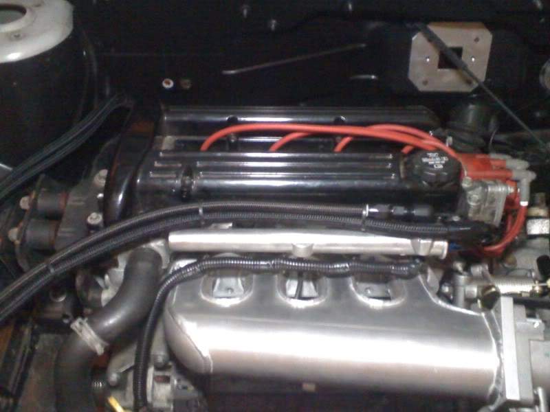

adjustable fuel pressure regulator
fuel lines to the tapped rail

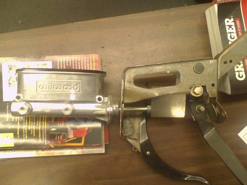

modified brake pedal arm and master cylinder extension (before being cleaned up and painted)

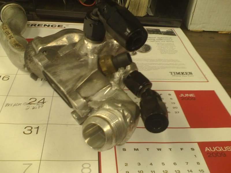

welded fittings on thermostat housing

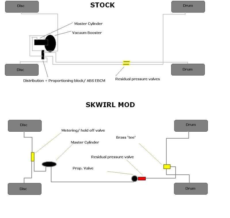

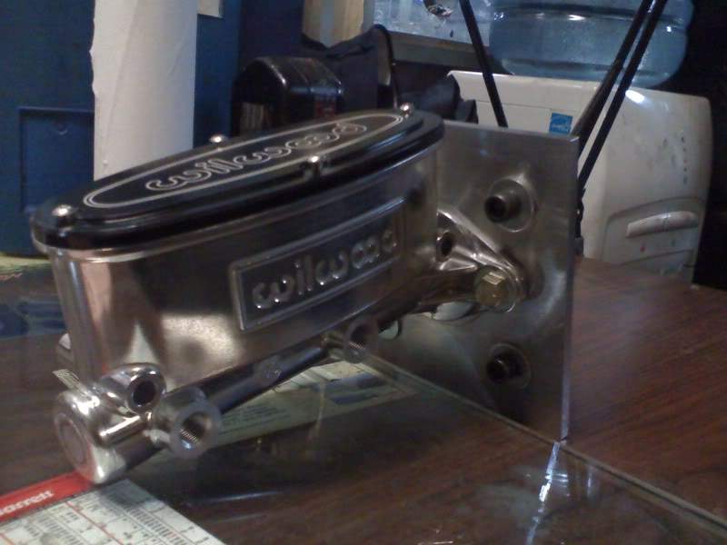

new master cylinder (brake booster and ABS EBCM eliminated)
new brake layout compared to stock.

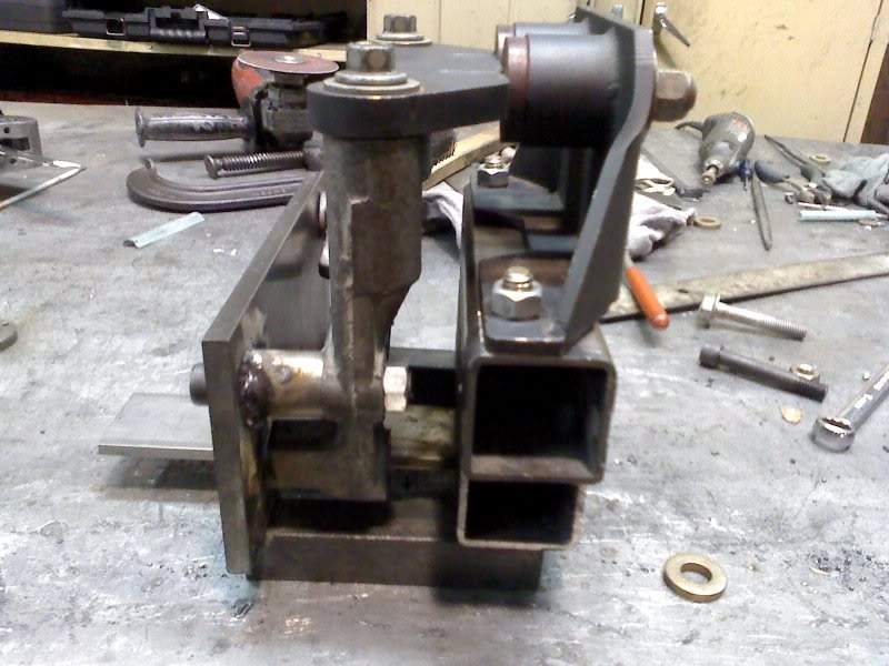

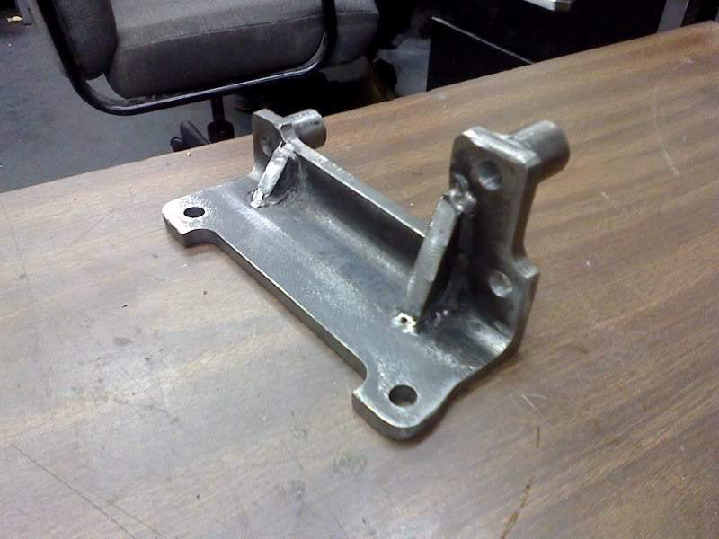

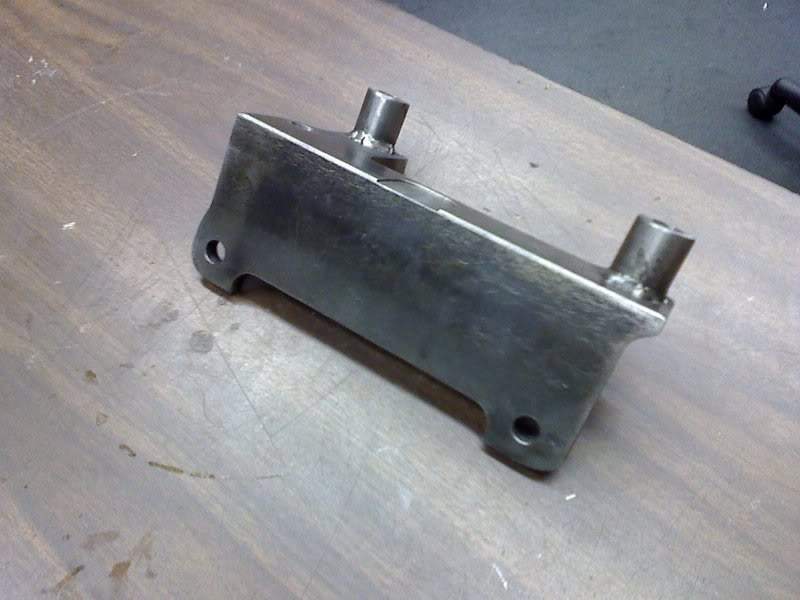

stock boss and rksport mount in jig
my custom mount in jig
test fit
final product

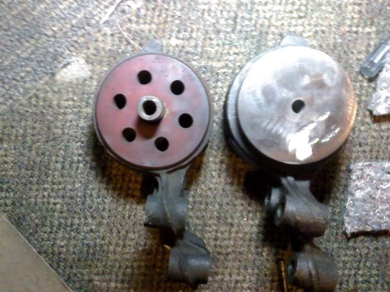

comparison to stock boss/rksport mount

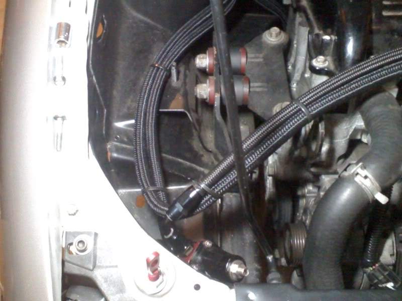

solid transmission bushings
i've also made a solid lower dogbone.

following systems have been completely removed (all wiring associated with as well)
ECM
BCM
HVAC
ABS/ EBCM
Brake vacuum booster
SRS system (airbags)
Radio
EVAP

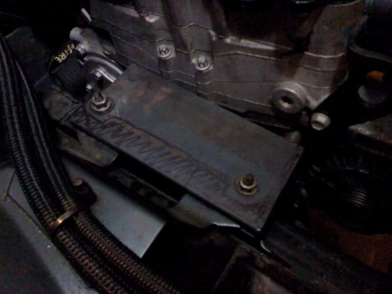

solid one piece upper motor mount

-AN fittings on thermostat housing

-AN tapped fuel rail

rear spare tire well removed, fuel cell bracket welded in
custom fuel pump mount
test fit
final product
