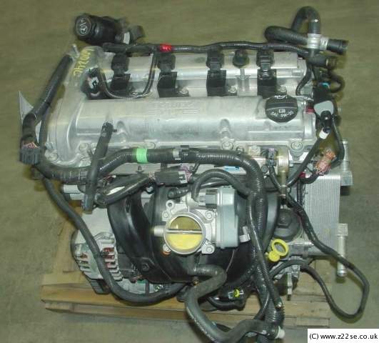

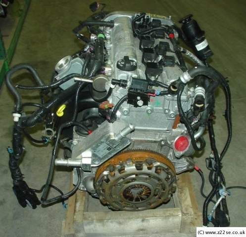

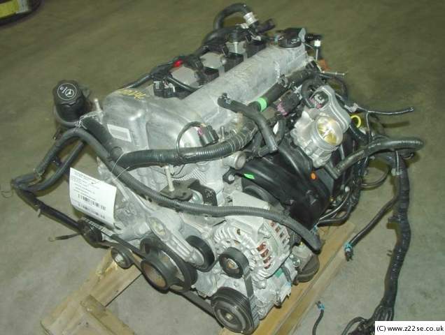

thought I would post some pics of the 2.4 vvt usa engine, should be in european cars next year (maybe)
has some extra goodies, oil cooler, 68mm tb, independent coils :D

the 2.4vvt engine is slightly different to the z22se, so the cranks and rods are not interchangable
so only a complete bottom end swap is available for the 2.4 route
