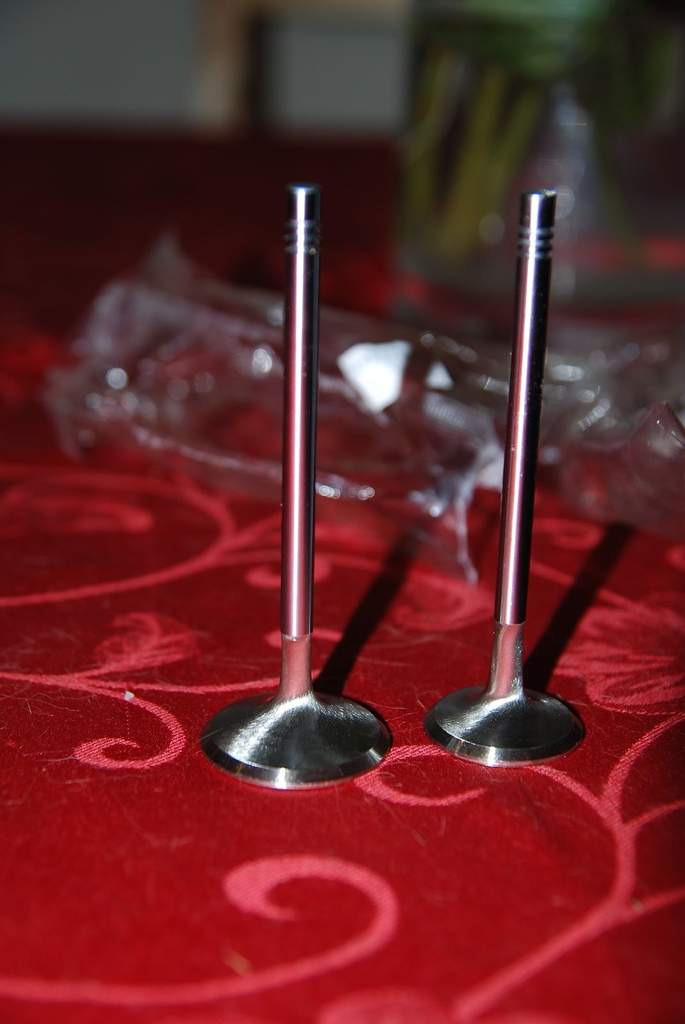

wasited vavles and std valvetrain it is then :D
sod not running stem seals..... the lotus cortina drinks a 1/4 of a pint of oil per 100 miles lmao
alanoo
alanoo
5 grams heavier for the stock sizes ones than OE items...
All located at the combustion chamber side, resulting in an increase of compression ratio
I think that this CP increase is a big part of Vocky's result :D
Anyway, the 5gr increase (maybe ~7 for the +1mm ones) leads the valvetrain to be now limited at 8000rpm in the stress calculations ;)
EDIT : erm, ~0.2 CR increase
EDIT2 : 0.25 CR increase by side, so 0.5 in total :D
