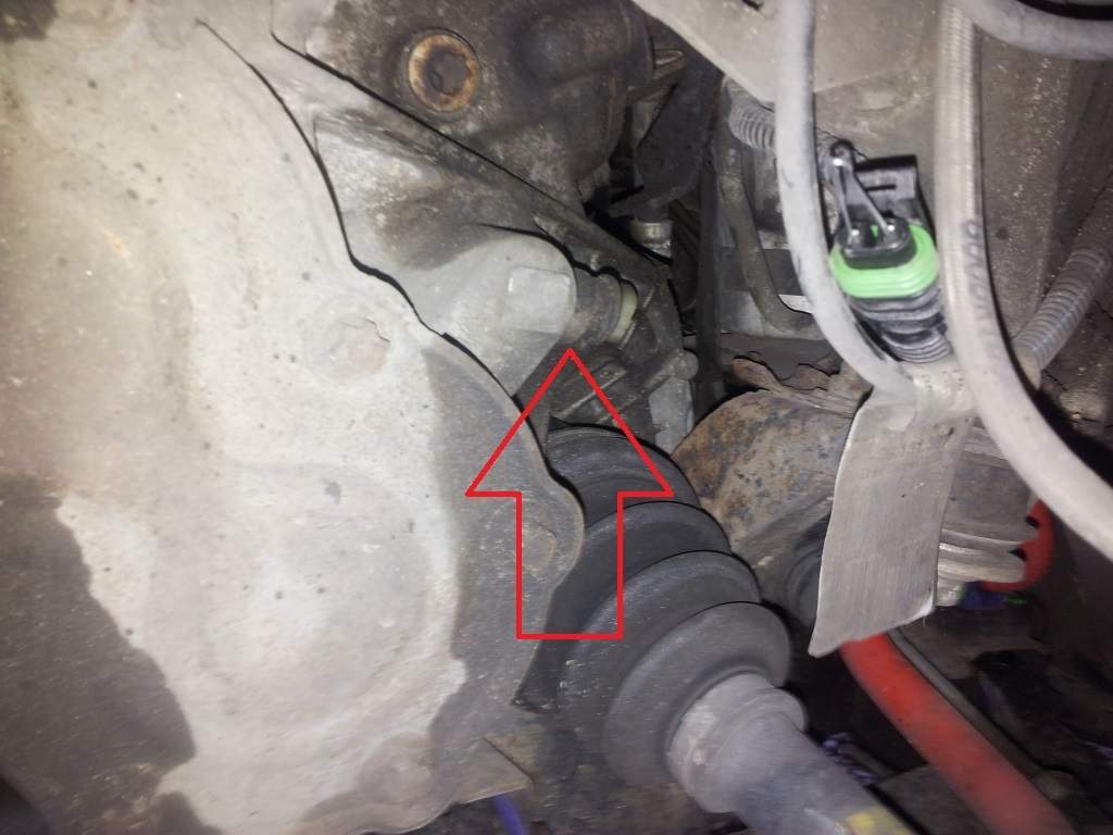

Hi guys can anyone tell me where the reverse light switch is located please thanks daz
passenger side wheel arch behind the shock bolted into the gearbox
thats on the f23 5 speed the m32 6 speed is on the front of the box
