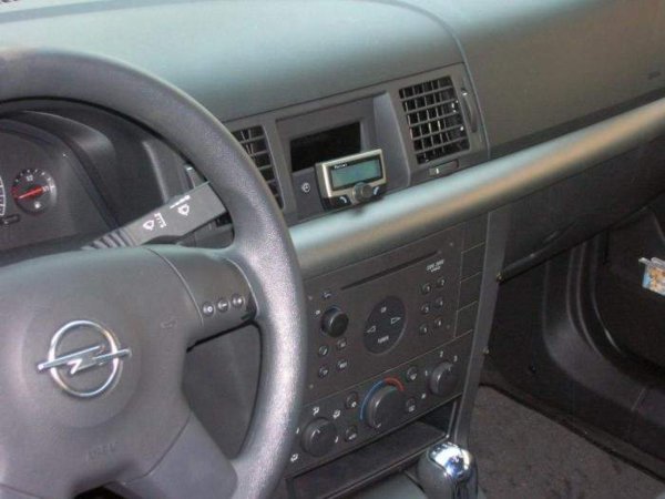

Where will it sit??? isn`t the Vectra a double din set up, can`t remember what it`s like in my parents car.
Just Google`d this pic
The hardest part was finding what colour the dash is. The above is the closet I can find, which is Charcoal Metallic, but that is listed as 1995-2005, and for 2005 on (which is my car) they list Chrome Metallic
which looks nothing like the same colour as my centre
