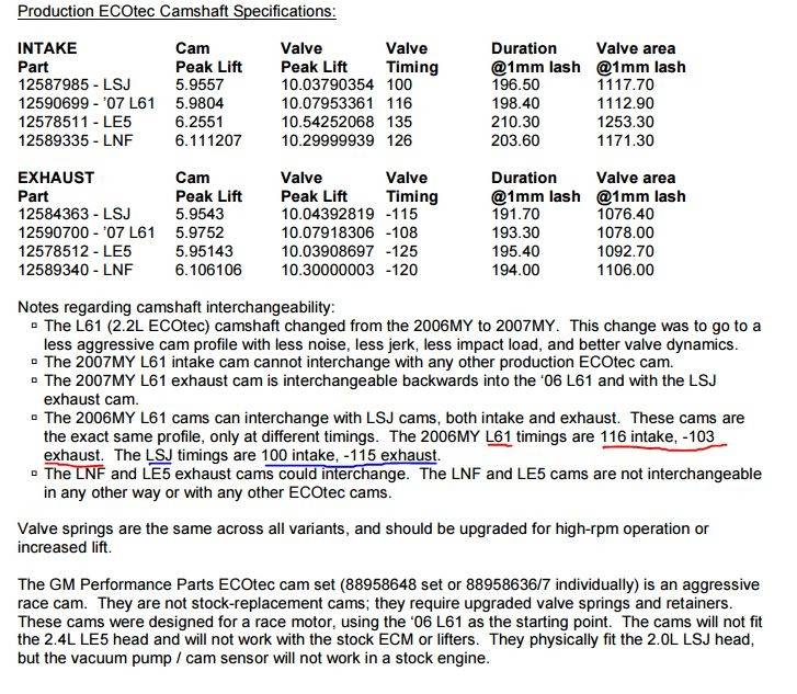

Arnt the cam sprockets different on a z20net?
Maybe the timing out slightly? On the cams
cos the sprockets dont have a key way to lock them into position
but im no pro so dont take my word for it.
yes the timing of the 2.2 is completely different to the 2.0t
the cam blocks are a nightmare there £160 a set and there's 3 different types for the same engine from different years
only info on the cams i could find
