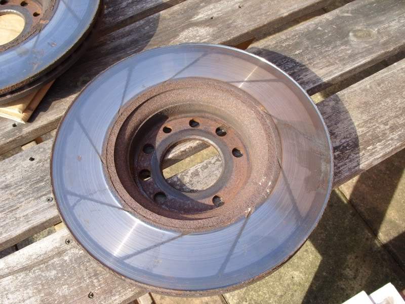

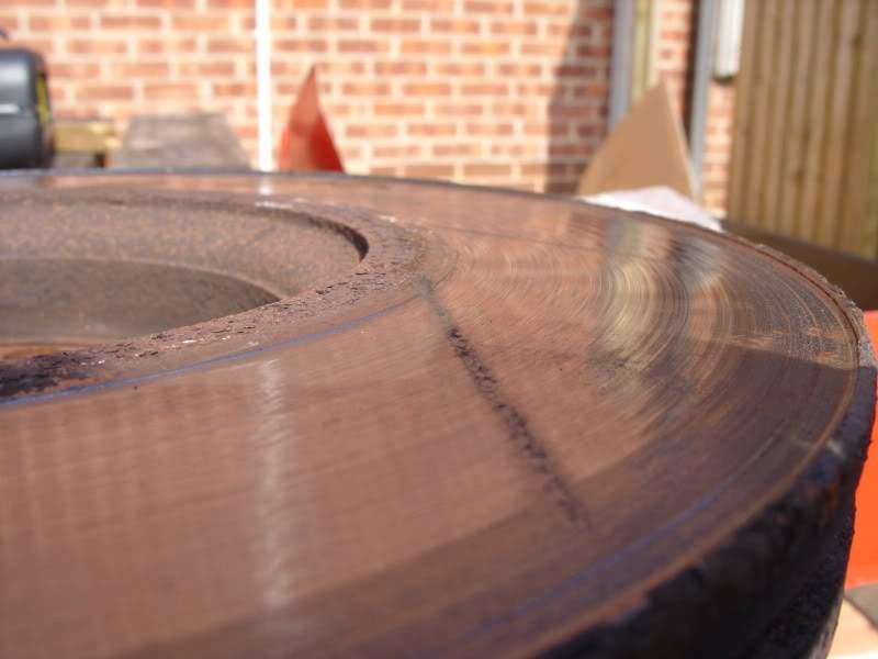

Here are the pictures the old ones although shot had done me good 3 and a bit years and 70K
And not very grovey at all :LOL:

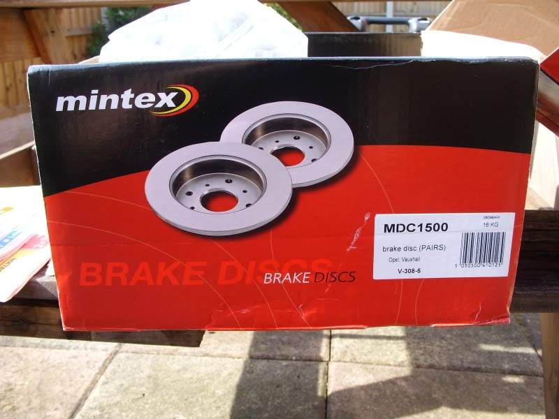

The part number of the Saab disc
The new discs
