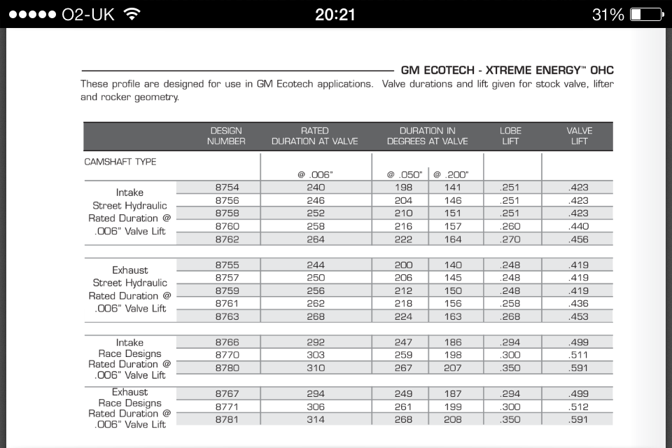

I've been looking at different cams for my supercharged build I'm fully forged but I'm unsure which way to go I've been looking at the stage 3 NA cams from jeggs rpm range from 3500 to 8000 and then I was looking at the lsj zzp cams stage 2 or stage 3
The stage 2 says peak power is at 7800 rpm and stage 3 peak power is 8500
What I don't understand is that the zzp stage 3 is a milder cam than the stage 3 NA but max rpm is higher
If I was to go for a stage 3 zzp would I be sacrificing lower end performance or would I be wasting them by capping my rpms around 7500
I have noticed the the stage 3 zzp inlet cam is identical to the stage 2 zzp only the exhaust is diff.
In case anyone hasn't already guessed I'm clueless about cams just don't wanna order wrongs ones when there 600 a set
Any help or opinions apretiated
