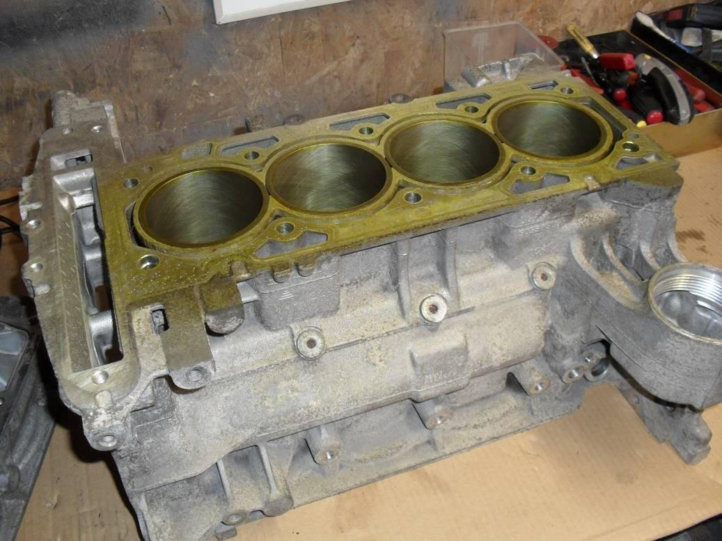

A few pics of a NA build - Eagle rods, Wiseco 10:1 CR pistons, Supertech 94lb springs, Comp stage 2 cams
Sump cleaned by machine shop
Rebored block - with balancer delete
