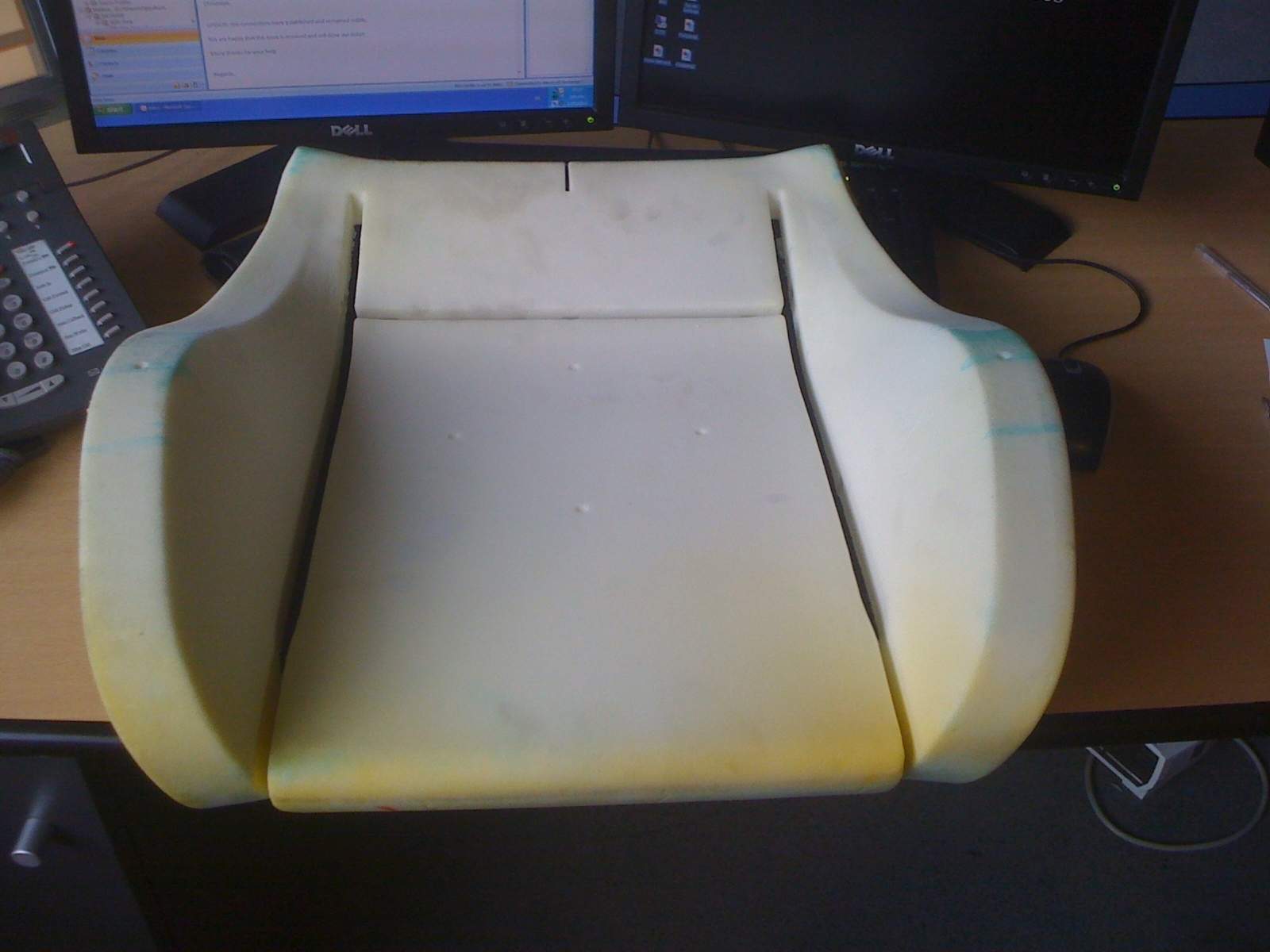

New Foam from Vauxhall

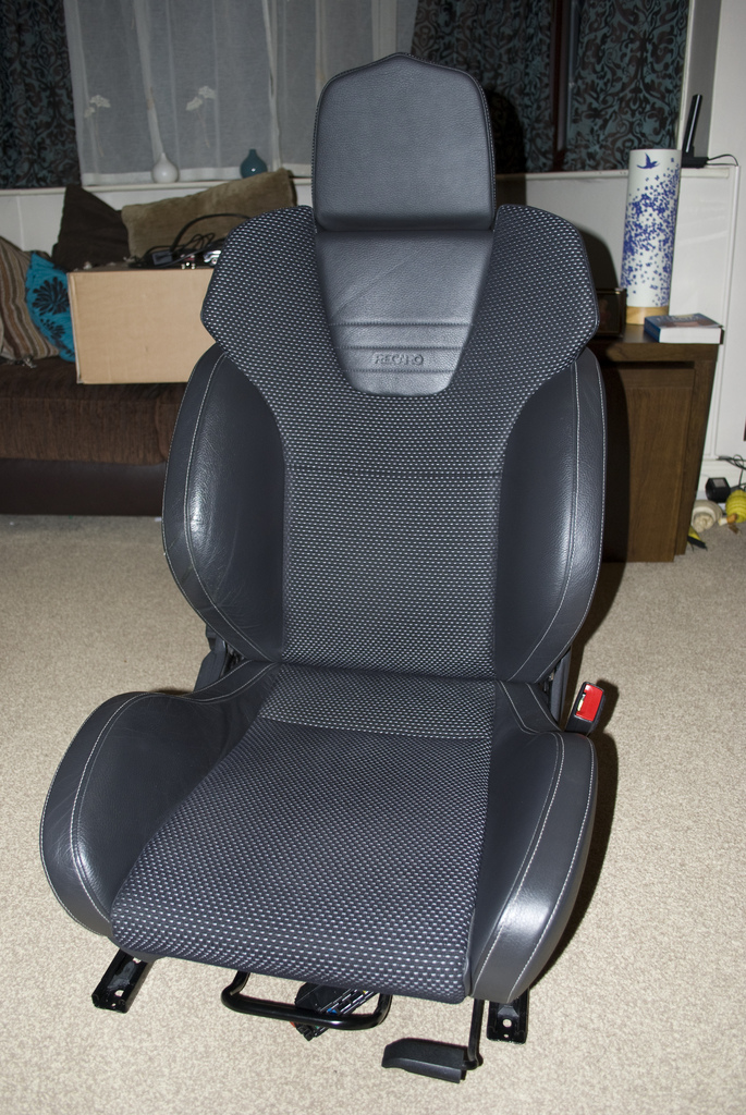

The seat removed from the car

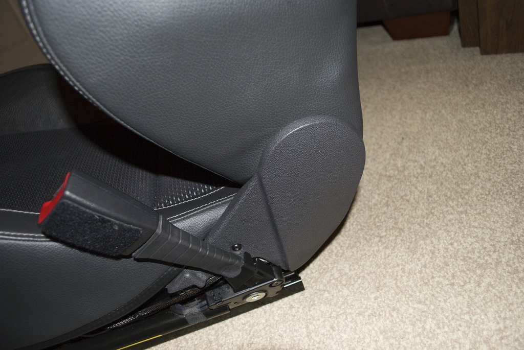

First thing was to undo the screw holding the plastic cover on behind the seat belt fastener

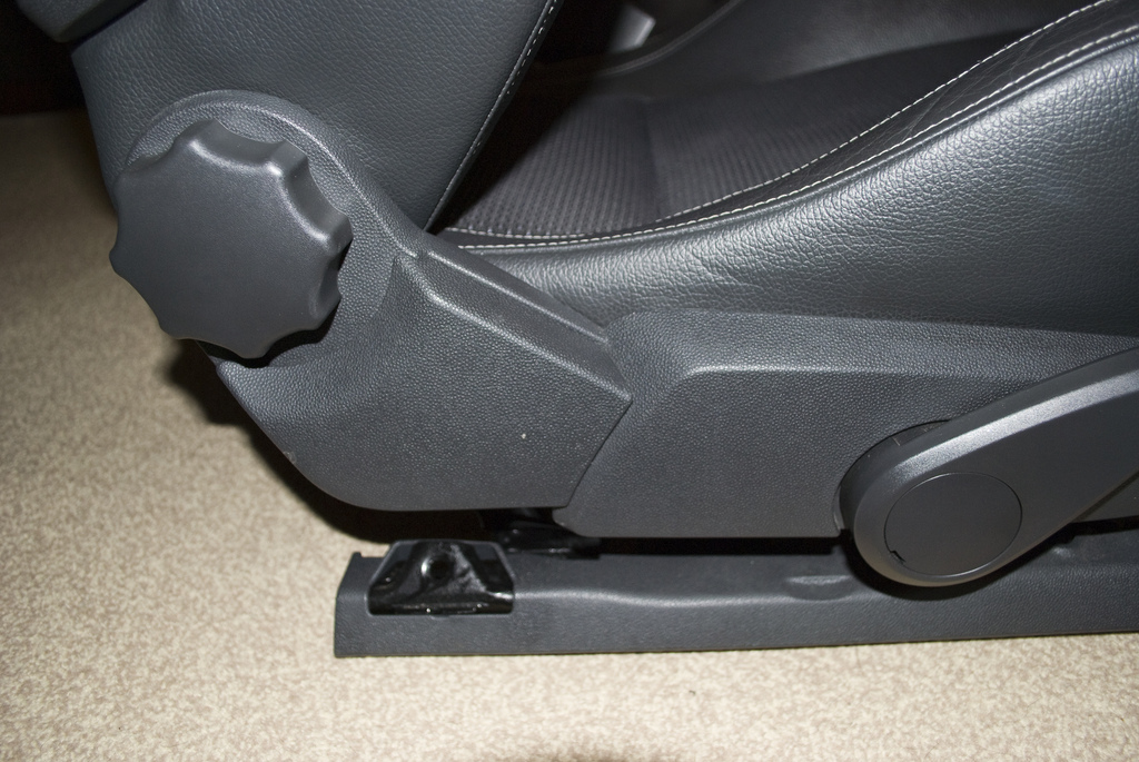

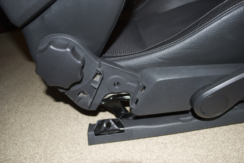

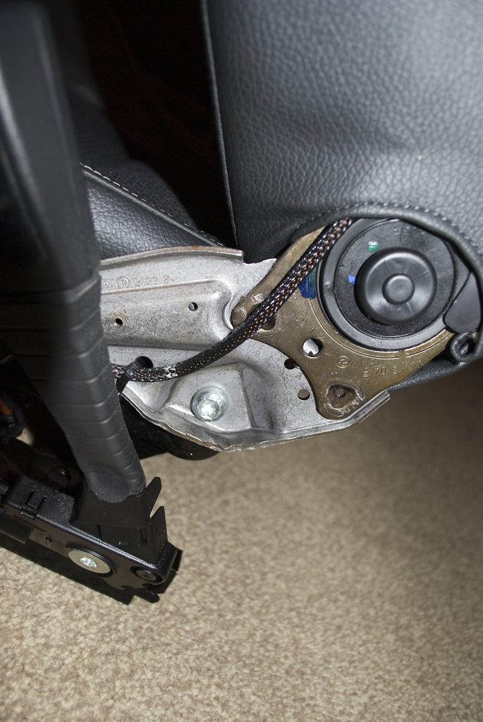

Unclip the outer plastic cover, to reveal the screw

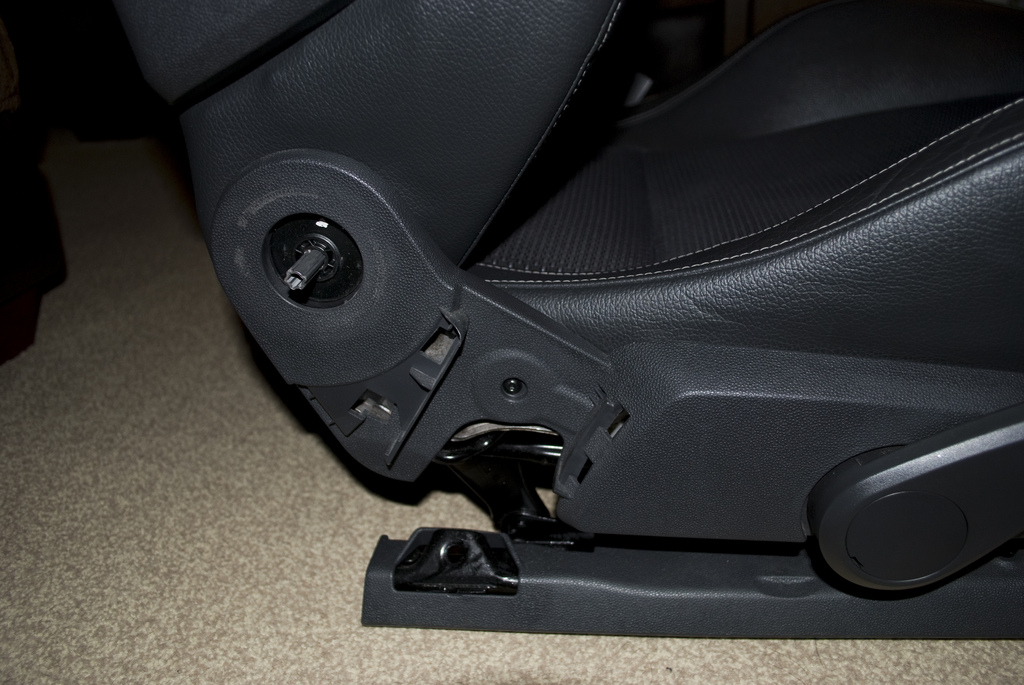

Pop off the back adjuster
and using a flat blade screw driver, remove the outer cover...
