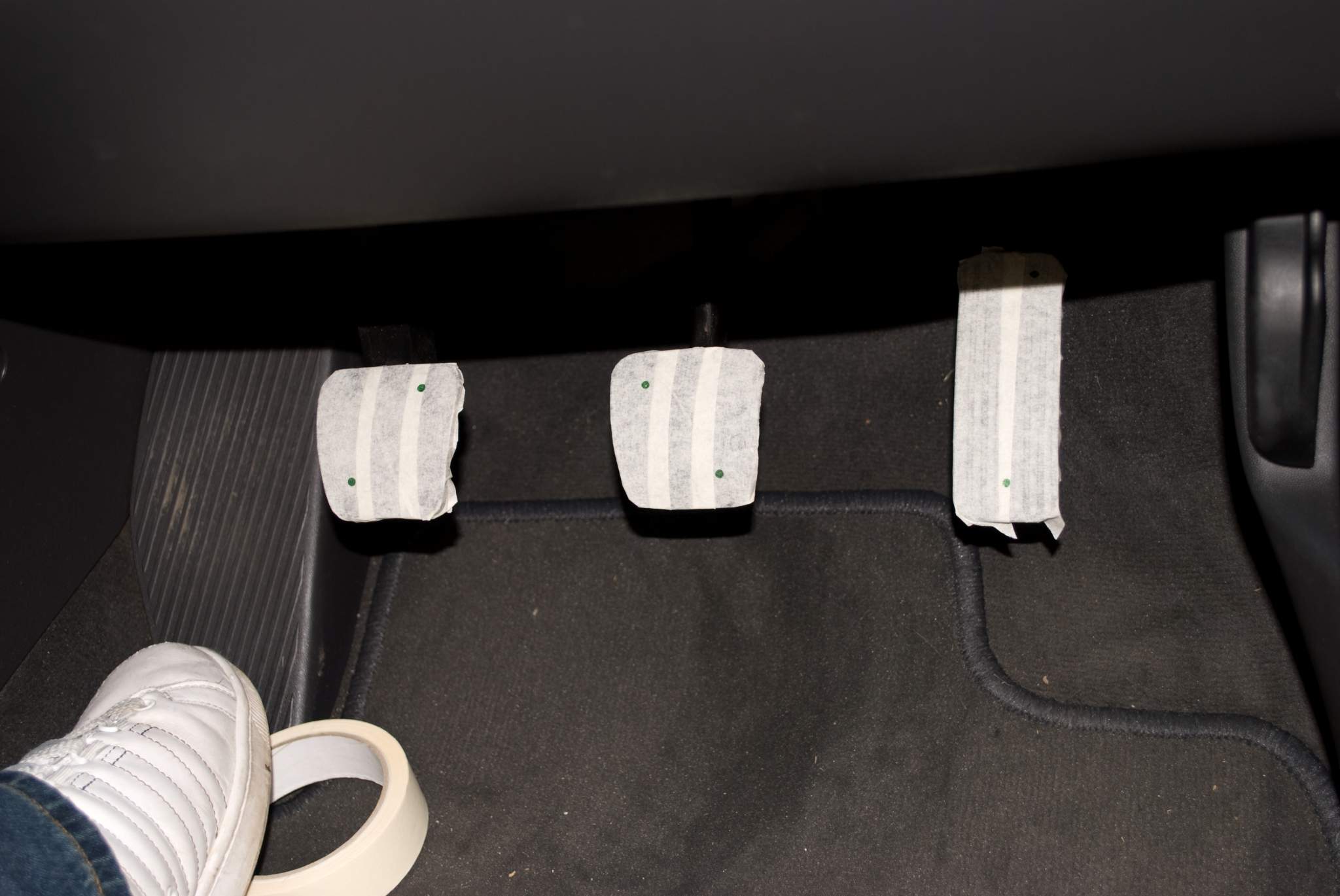

Next, you need to remove the rubber covers from the brake a clutch pedal.
Apply masking tape over all 3 pedals so you are able to mark up with a pen, where you need to drill
Selecting the correct drill bit size for the hole, carefully drill through the pedals.
