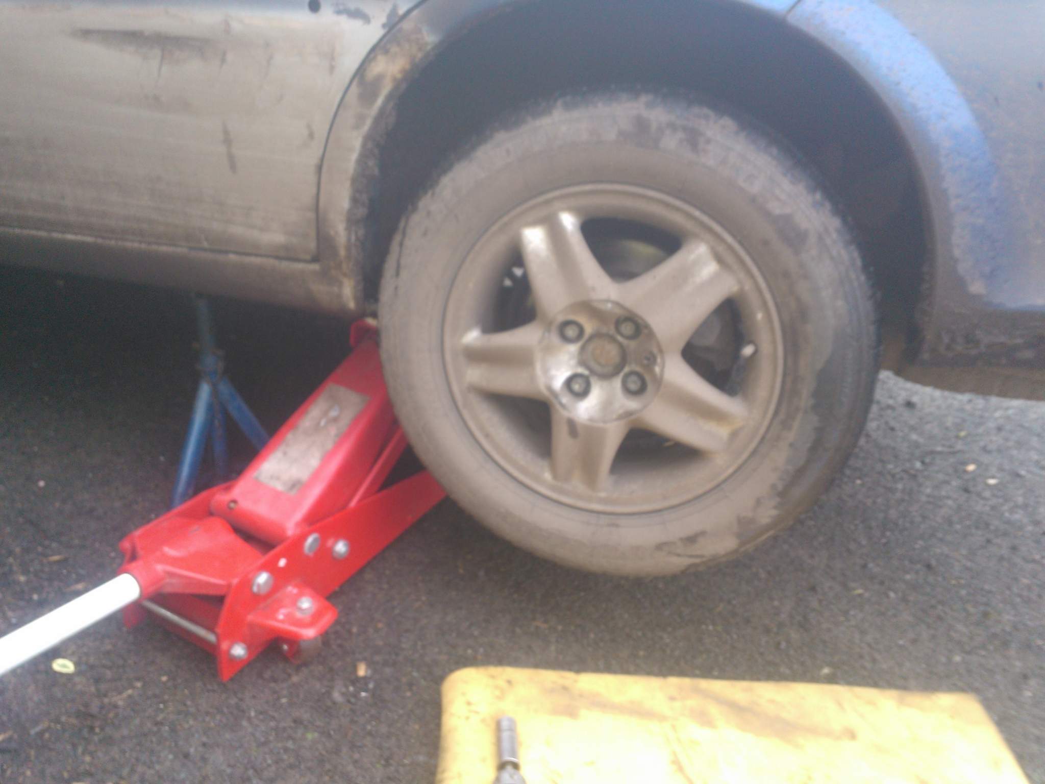

here is a guide to change the rear pads,discs,shoes on a vectra b
park the car on level ground and chock the front wheels
slacked the wheel bolt while the wheel is on the floor
then jack up the car and place the axle stand in a suitable location
then remove the wheel
1st step is to take the Philips screw driver and the hammer
pop the screwdriver in to the screw and hit 2-3 times with the hammer
this step is to check if the screw holding the...
