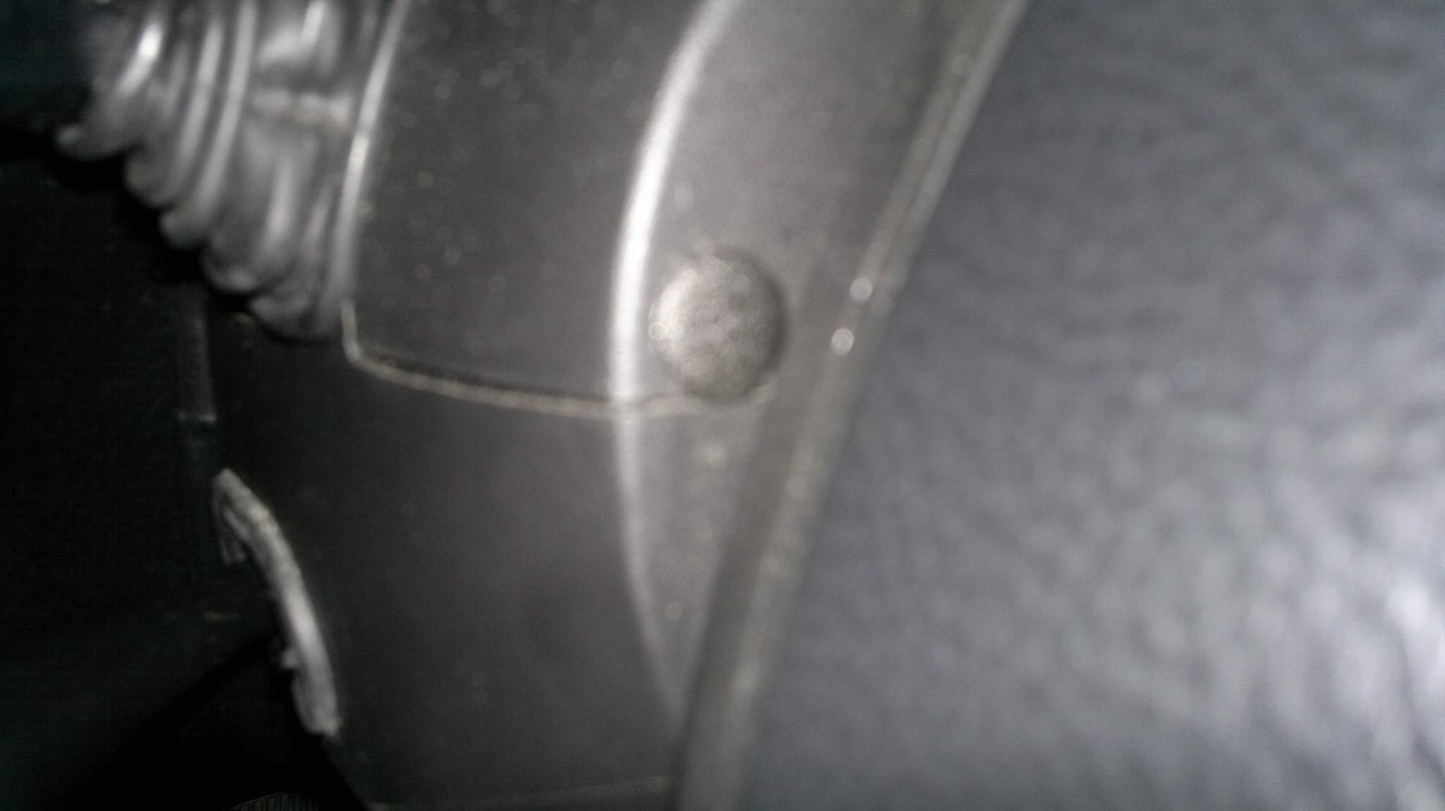

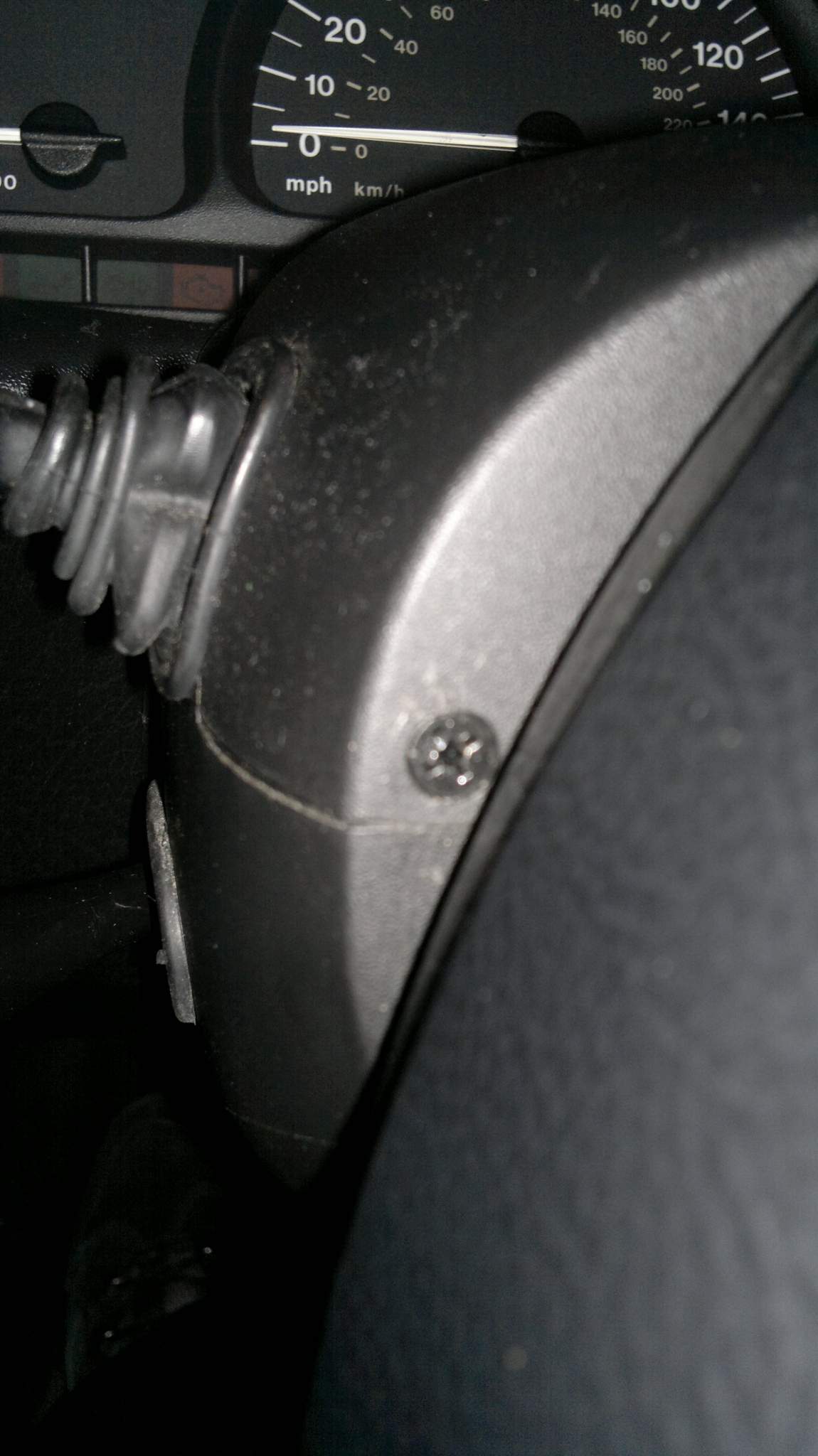

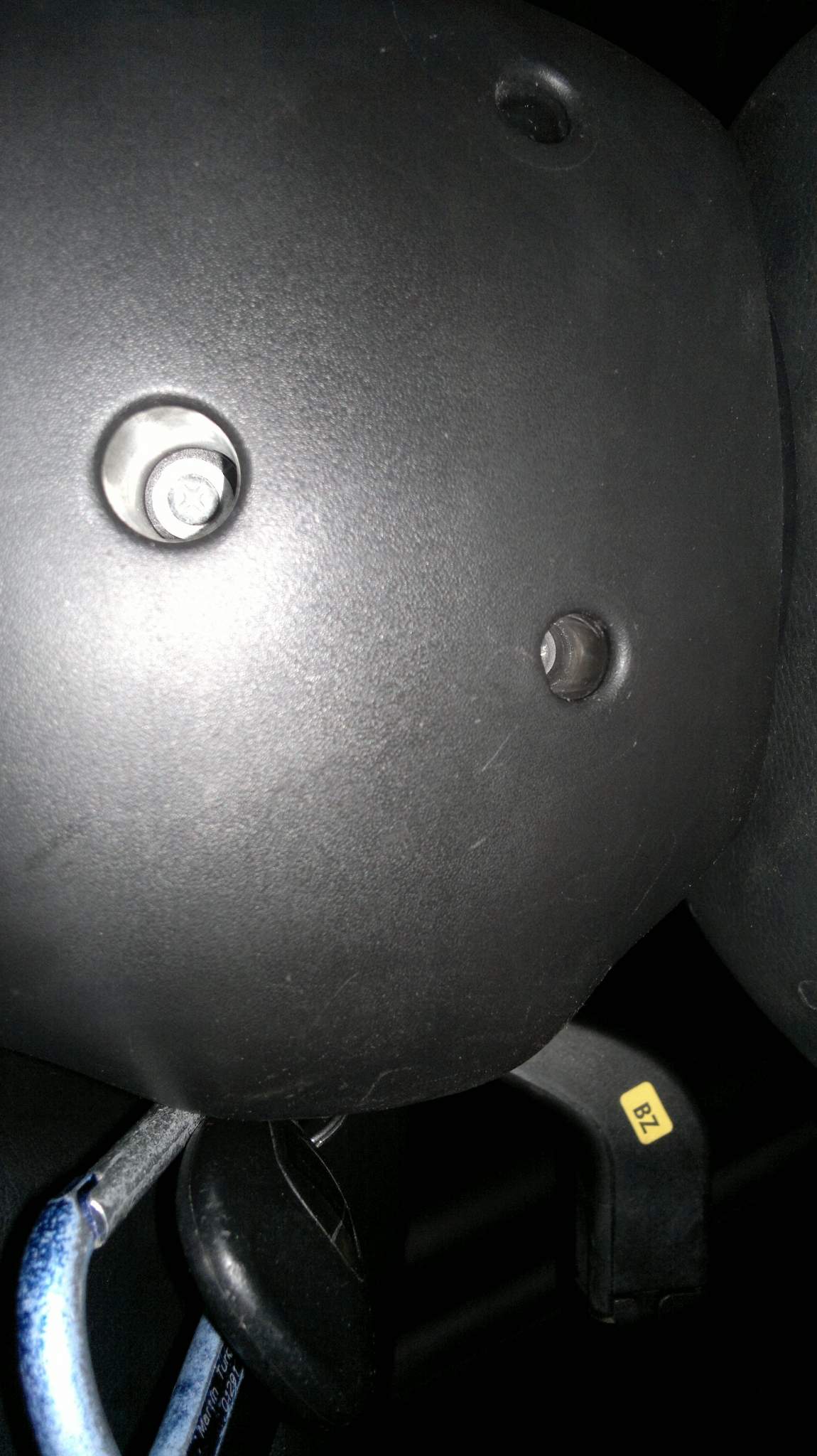

Needed to change my instrument panel bulbs as i couldnt see my speedo at night. Pics from my vectra 1997 model. This may also apply to the improved later ones before the facelift Vectra.
Here is my how to guide for everyone: -
STEP 1: Remove steering column surround. 2 screws holding the top piece to the bottom. Adjust steering wheel as in pics. 3 screws holding the bottom piece. NOTE 1 screw is different!
