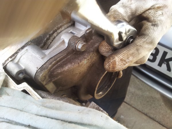

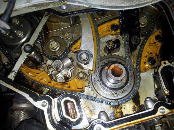

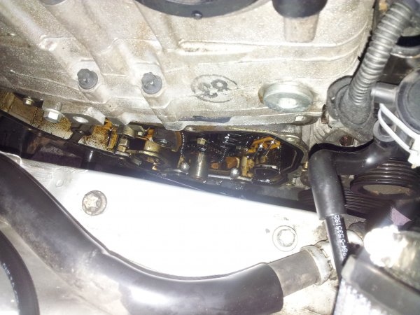

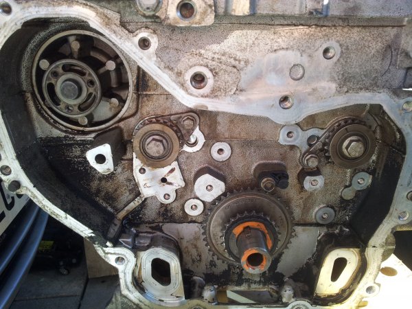

I've taken the side off and there is movement in the exhaust balance shaft that seems to knock like metal to metal even with pushing it with my hand up and down, so I'm thinking its that, or the tensioner not working right but i dont think its the tensioner.
And they had the pistons when it was rebuilt so they added new crank and put everything back in and tested it and it looked good when we got it and looked alright nothing out of place

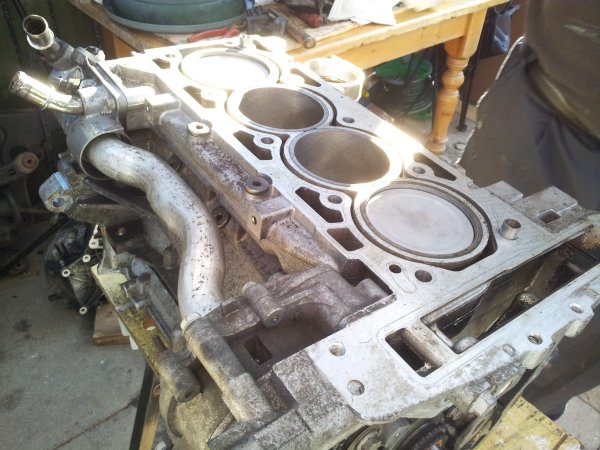

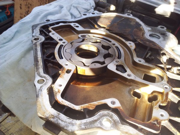

jnaisby
this is the engine when we got it back and adding new stuff on

To look at the exhaust balance shaft sprocket looks old and worn compared with the other one maybe the bearing is worn and that is why the shaft has movement or possibly the sprocket needs replacing
corsaZ22se
if you have play in the balancer shafts i'd say thats where the noise is coming from, you shouldnt be able to feel the end float (in -out movement) by hand. and there shouldnt be any up/down/ side to side movement at all. just spin freely nice and smooth.
jnaisby
well we looked at the balance shafts sprockets and they had no wear and both in and out has movement. we checked timing and everything else and started it up and still same noise. maybe engine out job but i've done a video and uploading it to youtube now

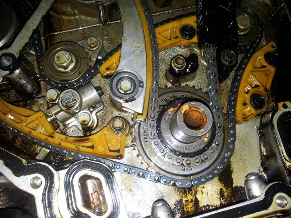

jnaisby
plus look at the clearance on these two photos on the tensioner, its different.

corsaZ22se
from the video i would say you have chain troubles and something else wrong like big end or little end problems. sounds like a diesel. but that might just be the videos sound?
jnaisby
just with the bearings been new and new crankshaft i wouldnt of thought it could of been that but it maybe, i think i should just replace the tensioner first see what happens
