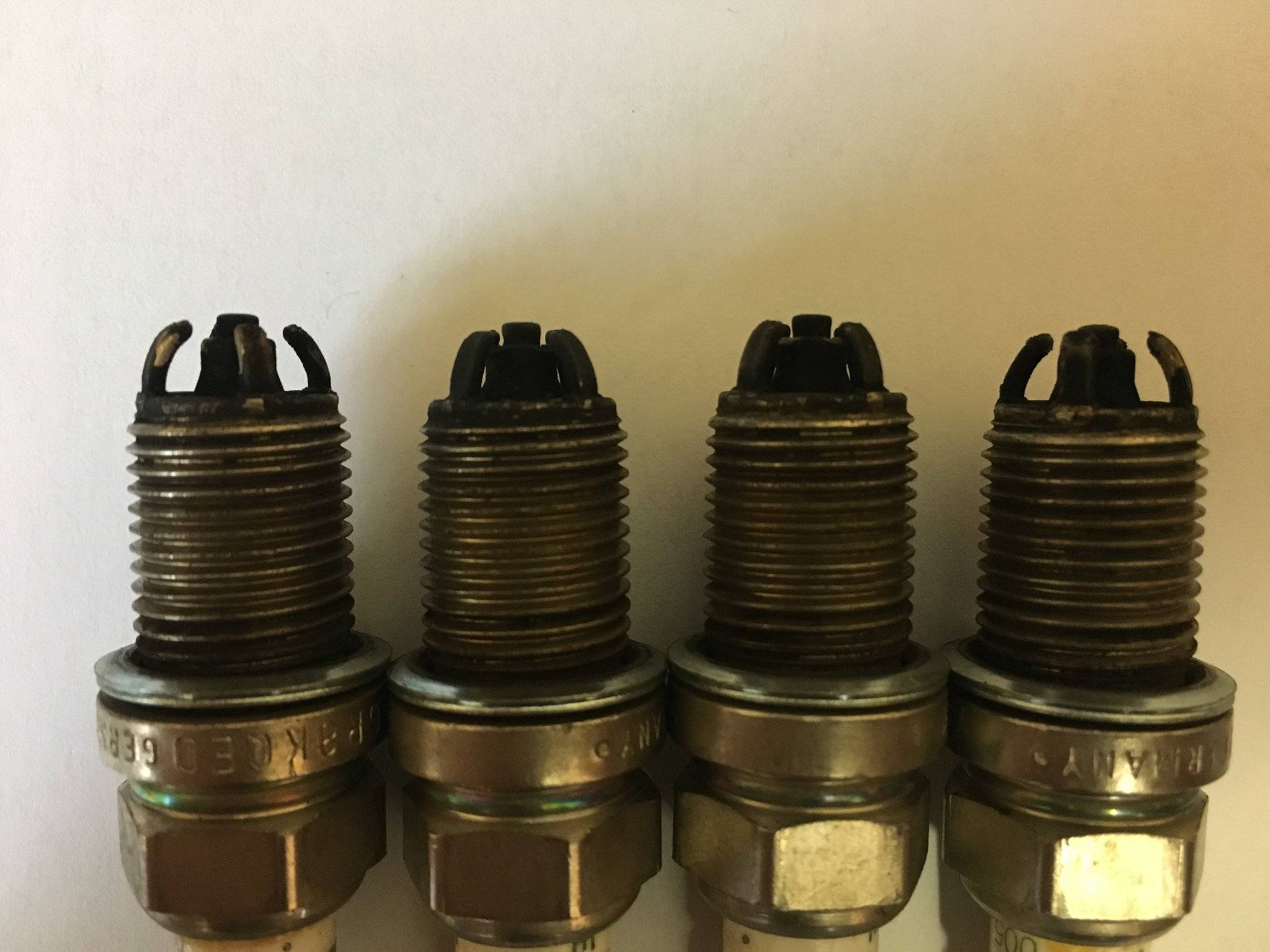

  4. IMG_3987.JPG IMG_3988.JPG IMG_3989.JPG IMG_3990.JPG I put new soark plugs in after i did timing, the bosch plugs are old ones i took out and the ngk plugs are new ones. Is this the reason for the way the car is irratic idling, stalling, engine vibrating, throwing them 2 codes up, over advanced timing? I got number 1 and 4 at tdc

  6. Yes they were but were fine before i did timing belt. Why have the tips gone on my spark plugs and ends bent in? There not like that on old ones i took out before chain change. Cheers
  7. possibly different design between manufacturers, there is no way the pistons can hit the spark plugs unless the conrods have broken.
    try the old plugs and see what happens to the idle
  8. Idles same, so my timing is spot on then if crank is at 12 oclock for woodruff key for pistons 1 and 4 at tdc. This is my cams and crank and everything was lined up to correct colored marks on chain like in your guides on here.
