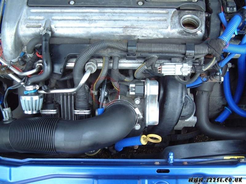

you need a 2.4 inlet manifold (they do come up for sale every now and again) or import one from the usa - don't forget the oil breather gasket
you also require an alternator suppressor, a universal type is perfect
you will need some servo piping and possibly the servo one way valve
