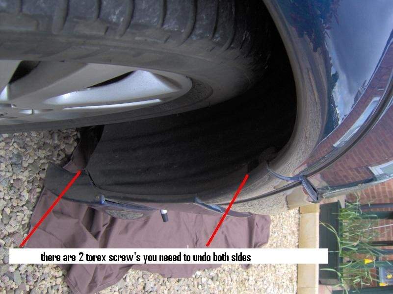

Step 1
Turn your front wheels to full right lock you will then see the 2 screws that need to be undone. Using the Torex screw driver undo both screws. Then turn your wheel to full left lock and repeat for the other side.
