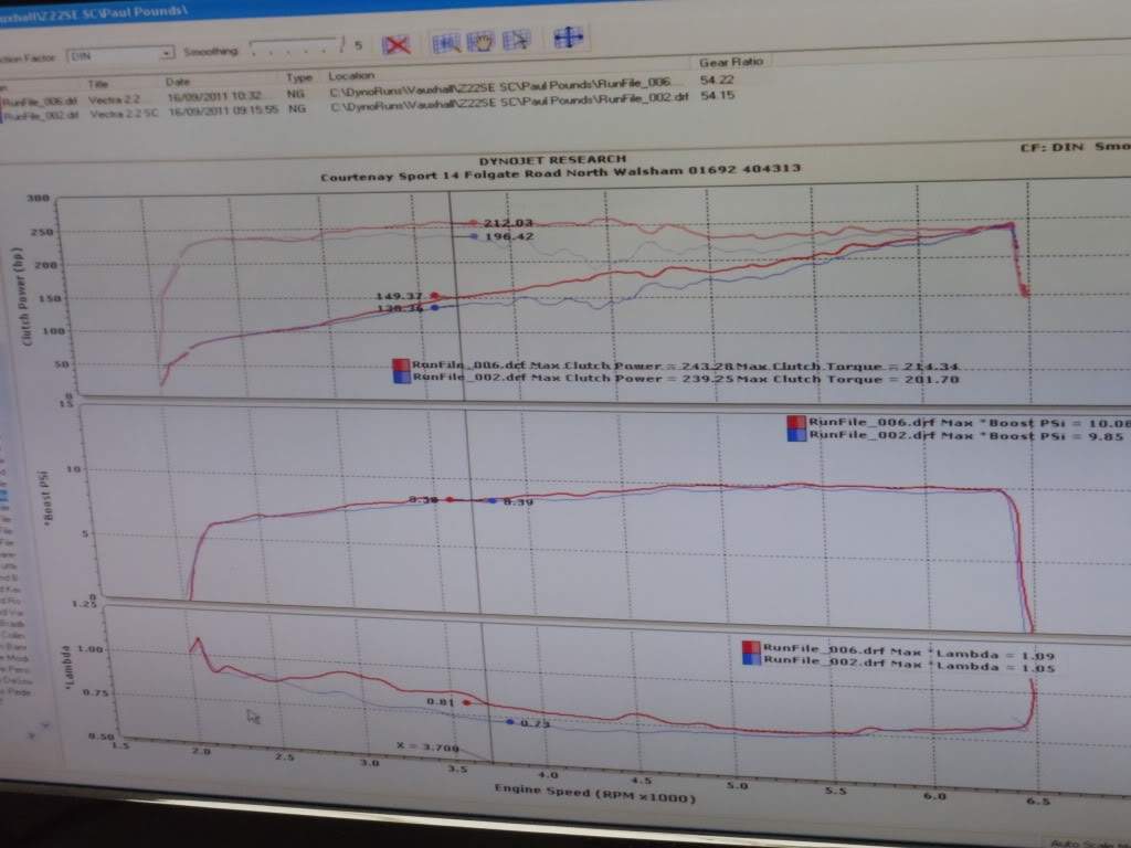

anyway! when my car was originaly set up it was on thier old dyno, and came out at about 240 ish bhp.
john said this new set up they have is more conservative and is around ,on average 20bhp less in its reading to what the other one would have given.
the results i had today were 243 bhp and 214 torque, which acording to john would have been around 260+ bhp on the old machine, so at least at the end of the day i can say that the manifold and exhaust mods ive had done have done the trick!
it was a totaly different car on the way home, so it was worth it, even if it was very expensive , and a very very long day!

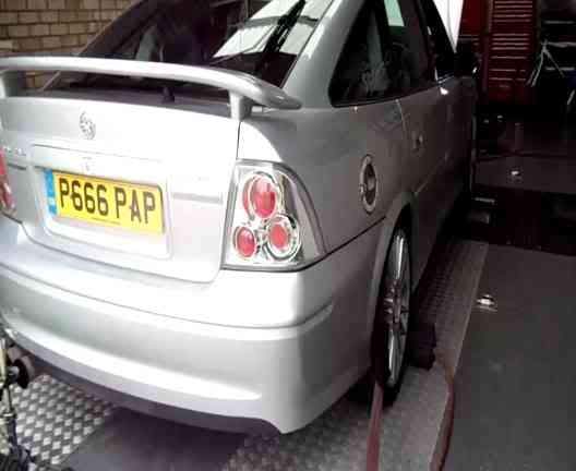

so heres a clip of her on the rollers and the results (my appologies for the sound) ......phew!
anyone who thought my car was loud before i had better turn the sound level down lol
click on picture to view.
