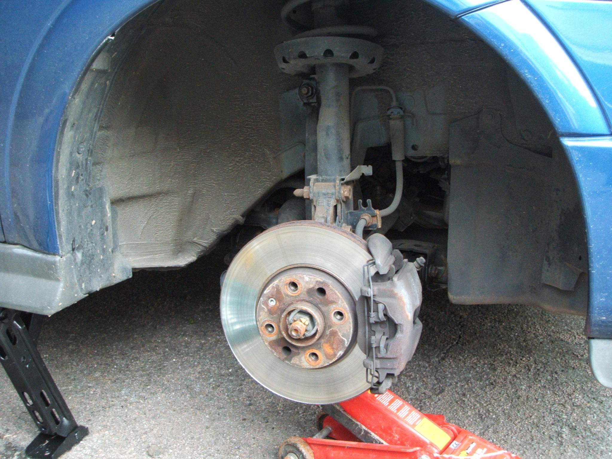

2 x Trolley Jacks (makes it easier remove and fit the droplinks)

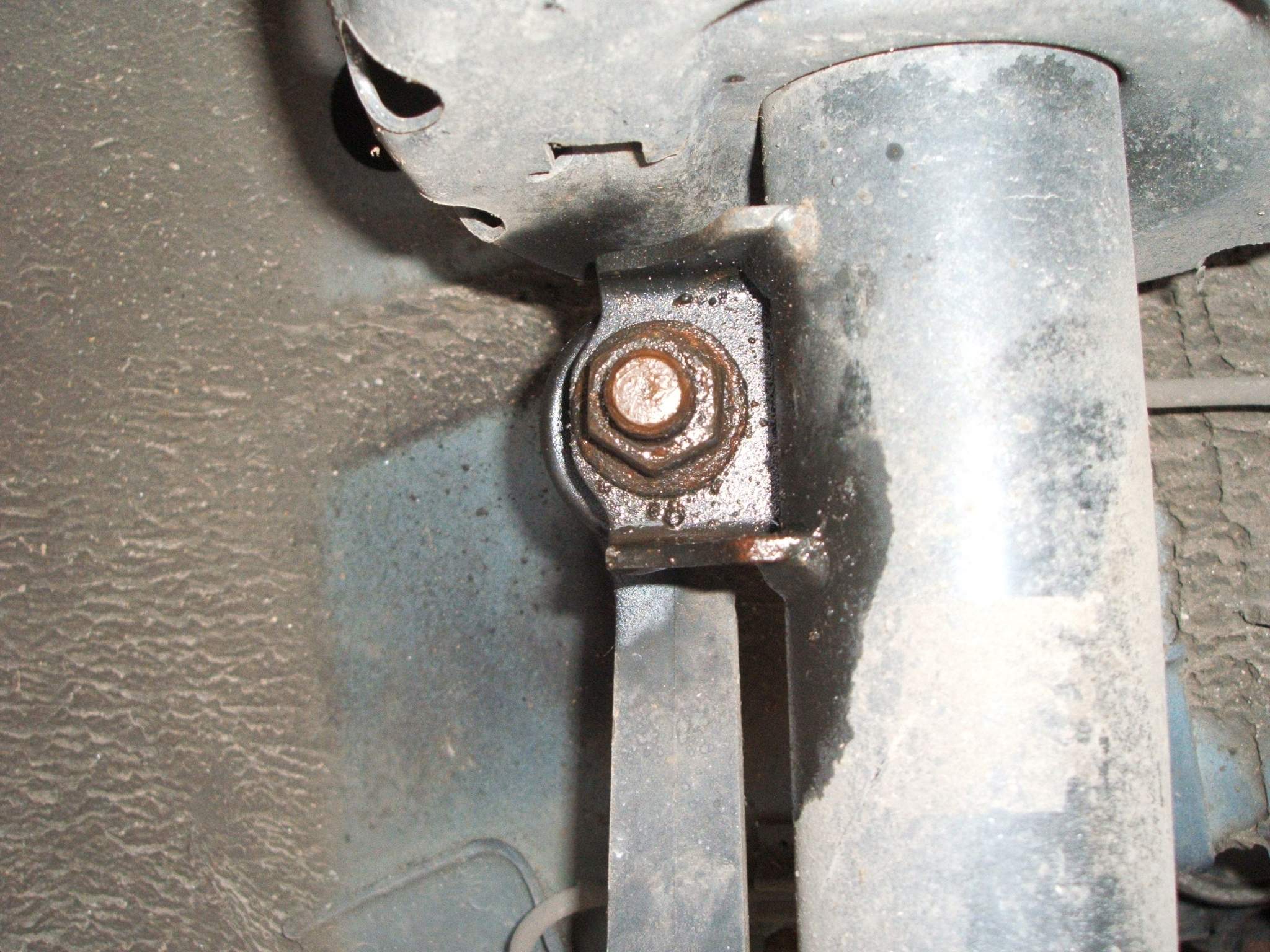

1) Jack the car up, and remove the wheel
2) Soak the nuts on the drop link in penetration spray to help remove them
