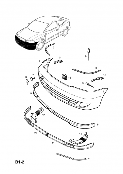

In pic #10 - 9201444 - EXTENSION,FRONT END PANEL,SPOILER,RH - £67.00
In pic #11 - 9201443 -EXTENSION,FRONT END PANEL,SPOILER,LH - £67.00
In pic #12 - 9201448 - AIR DUCT,BRAKE,FRONT,RH (OPC) - £32.50
In pic #13 - 9201447 - AIR DUCT,BRAKE,FRONT,LH (OPC) - £32.50
Any pictures of that actually fitted to a car? I've only seen it where people remove the fog lights to so a similar thing

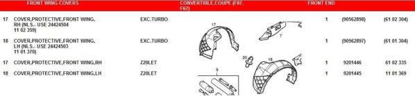

#10,11,12,13 are all standard coupe turbo parts to fit them you would also need the coupe turbo front wheel arch liners like i have and a load of split rivets
there is a lower wishbone brake duct for the gsi that fits all
all i could find :(

I was looking at EPC for the different brake ducts and their part numbers, and found something interesting that I've not seem mentioned here or on other Astra based boards.
There was a 2.2 Diesel version of the Astra in Europe, with the Y22DTR engine; We didn't get it in the UK as they couldn't make it work as a RHD, as the steering column would be in the way of the engine. Anyway, to the point; The front splitter on the 2.2 Diesel has air vents, for the brake ducts, as they are standard fit on the 2.2 Dti!
Here's a picture showing what I mean;
And here's the images from EPC4
The part numbers are;
24436592 ~ LH vented splitter
24436594 ~ RH vented splitter
24436982 ~ LH brake duct
24436983 ~ RH brake duct
I will investigate to see if my local Vauxhall dealer is able to source these parts, and for how much. I may also enquire with LMF, and have a look on some of the european eBay sites.
Hope this is of interest to you all :)

they fit to the turbo wheel arch liners and then the splitter the z22se wheel arch liners dont have the cut out for them

All the Australian delivered astras came with the cut out in the arch liners regardless of engine spec.
