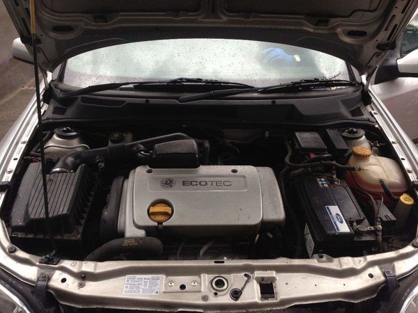

Over the last month a problem started to develop where the engine would stall when coming to a halt,
it was able to be re-started immediately and carried on running, this fault occurred intermittently and would go away or come back at will.
Last week it started doing it at every junction.
No engine management light has came on – no symbols showing on the dash
When car is started, after about 5 seconds the engine will suddenly stall, if you start moving the engine will keep going until you stop.
I have had a very good auto electrican look at my car - he can find no faults
He unplugged the MAP sensor and the engine then starts and runs fine, it doesn't cut out at all.
He replaced the MAP sensor it ran ok for a few miles
now it is back to stalling again .
The auto electrican is coming out next week to have another look
